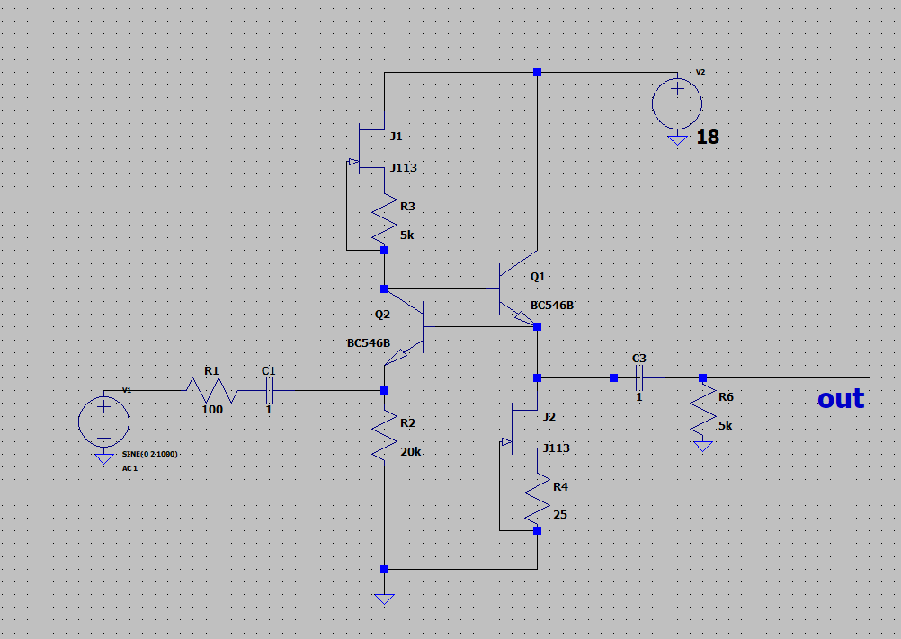

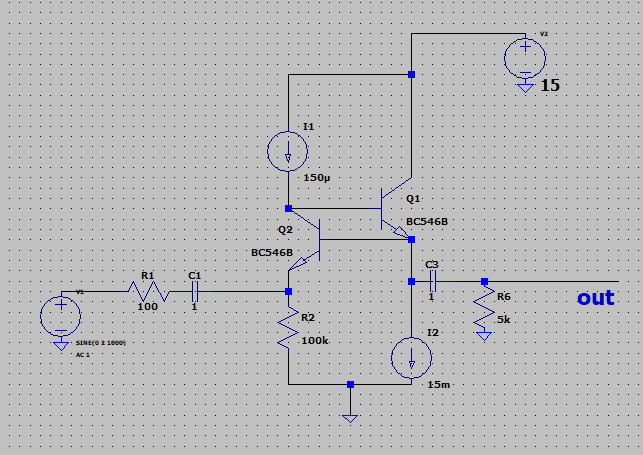

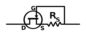

Hi ! in another thread i saw a very interesting circuit The one here below Dont consider the writings
are there parts than can replace the current limiting diodes CCL 0130 and CCLH100 and do the same job ?
if i understand well this circuit should work very nicely as unity gain buffer
The diodes are not very easy to source What could be used instead ?
thank you very much indeed and have a nice day

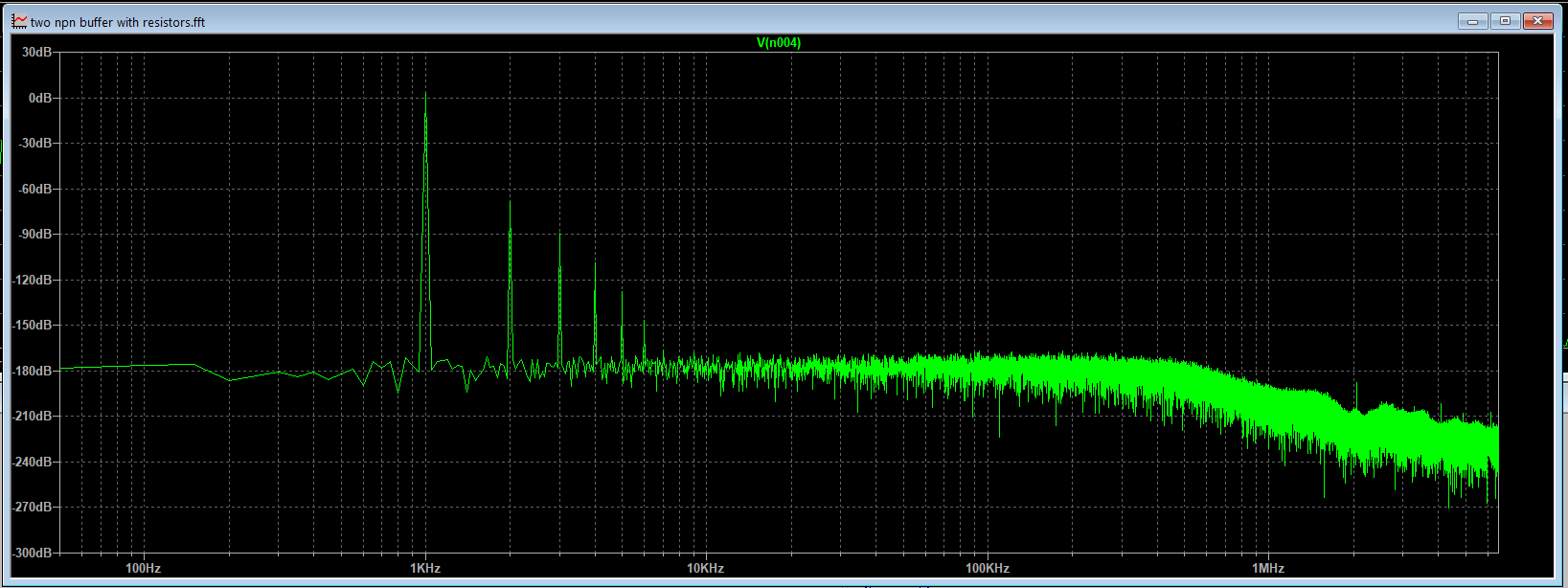

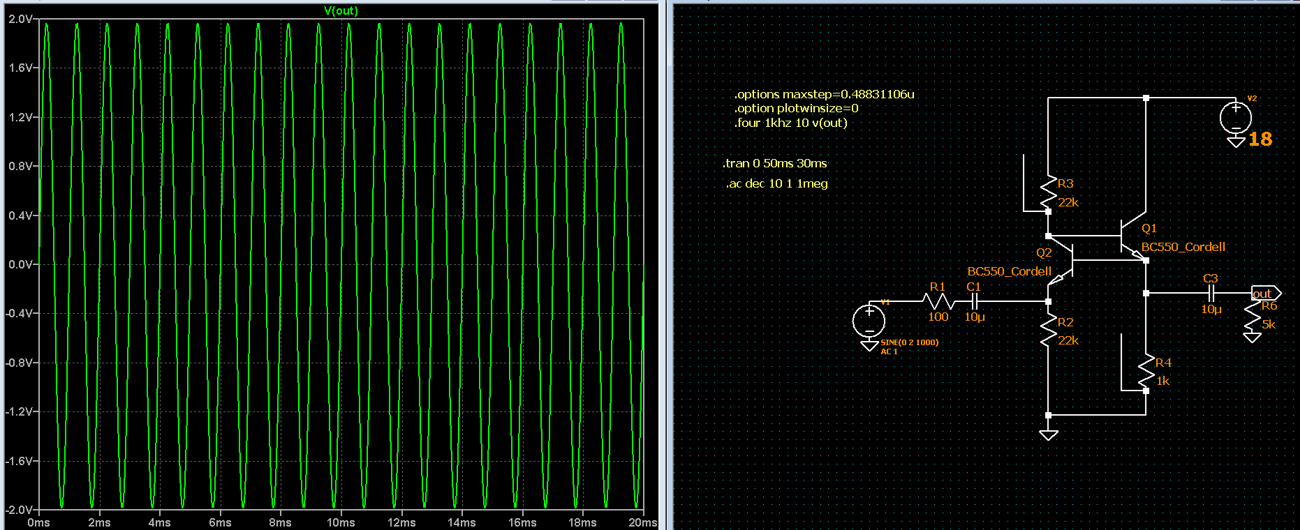

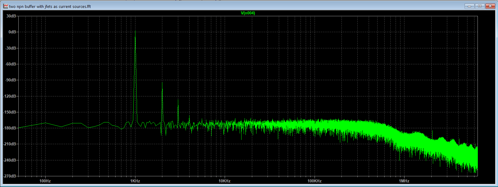

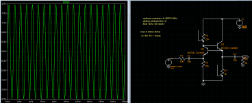

I am trying the schematic but i cannot make it work I used to fets at their place
I am getting absurd results (I am attaching a simulation)
Maybe the simplicity comes with other negative issues

The smart thing to do is sim the current source on itself to make sure that you have that working.
After that you can use them as a trusted part in an amplifier or buffer circuit.
Doing everything at the same time just wastes ypur time.
For instance, in your circuit, Q2 B-E is constant 0.6V, I don't think that works.
That has nothing to do with the current sources. Even if R3 and R4 are so different, one is almost surely wrong.
Do you understand how the current source works?

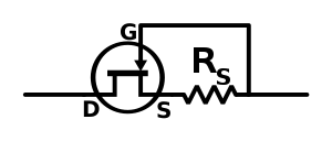

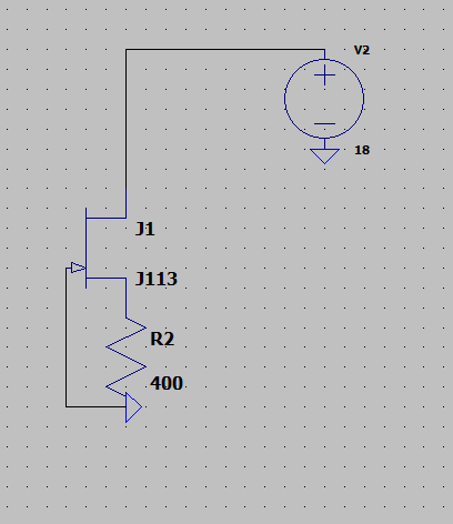

You look up the required Vgs for a certain current in the data sheet. Say the FET needs a 2V Vgs for 5mA Id.
That means the source resistor needs to drop 2V at 5mA making it 2V/5mA=400 Ohms.
Make a circuit that tests this to get that out of the way.

Gino, it is the most simple circuit you can think of!
Make an effort. You want to spend the rest of your life grasping around in the dark?
How can that be fun??

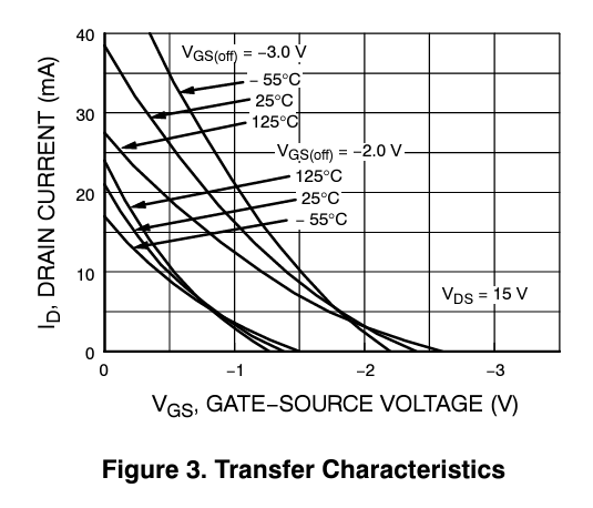

Look at the graph I posted above. Select your wanted current. Then find the Vgs that corresponds to it. Then using the simple ohm's law equation I posted to find the R. Done.
Draw it in LTspice, just the current source between supply and ground and measure the current. Adjust if needed.
Jan

Hi you mean like this below
yes i can read 2.28 mA through the resistor to ground Is this what you suggest ?
I guess that i should look at the CR diodes datasheet to find the currents ?

2.28mA through 400 ohms is 912mV; do you see that the 912mV is the Vgs of the FET?
So the data sheet should say that for 2.28mA current the Vgs should be about 1V. Let's check that.

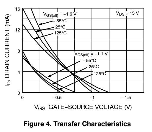

If you look in the data sheet, there are a few graphs for Id versus Vgs, for different FETs because they come in different Vgs(off) values, that's just because they can't produce them all at the same value (hence also the need for matching if you want two the same).
Fig 3 for a FET with a Vgs(off) of about -2V seems to show about 2.5mA at -1V. So that's pretty close to what you get.
Congratulations - your first current source.
Now back to your amplifier circuit. You need to know or decide what values these current sources need to have, and then check that in your test circuit looking at the data sheet.

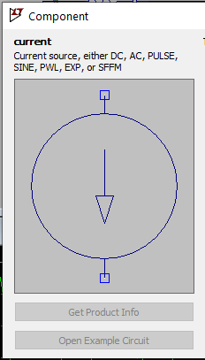

Hi just last question I am using a lot this component labelled CURRENT in simulation
I am finding it very useful to find suitable working points
to replace it with actual components should i use a combination like this ?
any other solution ?
