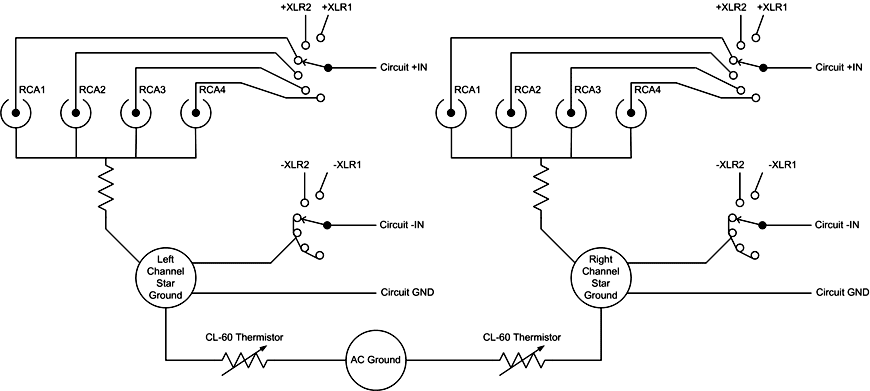

Dratted Hum! Still haven't got rid of it. Tried lifting the gound on the inputs, and the hum went from mildly irritating to deafening. Tried combining everything to a single star ground with no effect. Tried inserting resistance between the star ground(s) and the circuit input (-ve circuit input is grounded for single ended inputs) with no effect. Checked every connection with a multimeter to ensure no cold solder joints. AAARRRGGGHHH!!!!!!!!!
The thing I can't figure out is why I had no problems back when I only had one balanced and one single-ended input connected to the input switch, but now that I have added three more SE and another balanced input I am having problems. At least the hum level is low enough that I can ignore it unless I turn the volume way up.
On an aside, I also discovered that Fluke 97 Scopemeters are awfull! The instruments self-noise is higher than most of the interesting things I want to try measuring.

Hey Tin Man, try this, connect a length of wire from the case of your Preamp to the case of your source and the case of your Amp., then wire it to the ground on a three prong plug and plug it in the wall. This will pull all the grounds to the same potential regardless of internal wiring schemes. Use 14 or 16 gauge wire and be sure to check for current flow with an ammeter just to ensure you do not have a leak from a live circuit to a chassis.
I usually back out a screw on each case and use a crimp on eyelet under each screw. If your humm persists after this I do not think it is a ground issue your having.

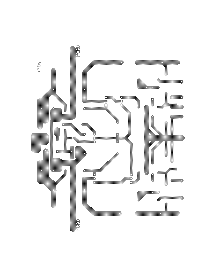

I'd be curious in seeing it, thanks.awpagan said:Can post pcb layout if interested.
pcb
attached pcb layout for metalman's schematic.
R18 2k5 (two 5k1 paralllel) as suggested by alain dupont works good with zeners
rv1/rv1 used for volume pot.
PGRD's starred to single point the to main GND
SGND to main GND
might be useful for balanced operation later.
SGND to main GND

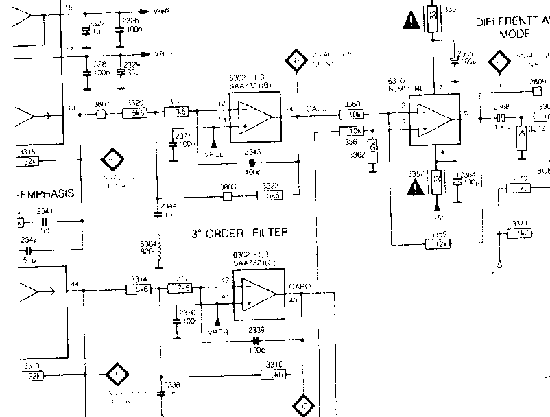

replace opamps
I was looking at my cd850 and thinking of next upgrade
http://www.diyaudio.com/forums/showthread.php?postid=705744#post705744
when i noticed the diff on the output of the DAC.
gave me a thought, hmm, balanced to SE
or even use balance in on preamp (new i'd find a use for them)
i wonder what i could use instead of valves.
attach schematic of cd850
any suggestions either yeh or nay
Or am i flogging a dead horse

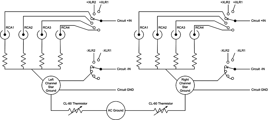

Metalman,
Did you solve you hum?
I may be reading your schematics wrong, but this is how I do my pre-amp:
I did about everything the same, only I do not only switch my incoming signals, but also my incoming ground. This means one of the grounding resistors is shortcircuited by the switch. (or relays in my case).
This way you keep the incoming signals roughly about ground, but because of the differences in ohm value you decrease possible ground loops with external devices.
Greetings, Harry.

Harry,
Yes I did solve my hum problem but in a very round about way. Because it was inaudible at my normal listening levels, and because I could not isolate the source of it, I decided to take a break from hunting it down and just lived with it for awhile. Then one day I went back and checked for the hum again and it was gone! I scratched my head, and decided to reconfigure to a simpler switching arrangement, and the hum came back. The only thing I had changed was the wiring connections to my input switch. Insight finally arrived, and I realized that I had used a rather heavy solid strand piece of wire to connect the switch connections that represent signal grounds together, and in the process of soldering it on, which required a fair deal of heat, I had been heat oxidizing the silver switch contacts for those pins introducing unwanted resistance into the grounding path. Over the couple of months of use while I was ignoring the hum, the repetetive changing of switch positions had rubbed the oxide off thus eliminating the hum.
So, just to be extra perfectionist, I have replaced the switch, and used a separate fine guage wire for each ground contact on the switch, thus avoiding the overheating of the switch during soldering, and now I have no problems at all.
Isn't it always the simplist thing that trips you up, in this case trying to avoid some extra wiring by taking a shortcut. At least I learned another valuable lesson.

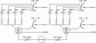

Metalman,
Thanks for your hum explanation. I would never have thought about overheating and degrading. A warned man counts for two as they say here in Holland.
I myself just about finished my Aleph 5. Finishing will take a while, because when I tested it, it never got disconnected again from my speakers. And I already sold my other amp after one evening of listening. 😀
Now I am starting with a pre-amp (although relays based, I want to switch on/off pre and main with a WAF able remote). Next will probably be a D1, then (or together with) an Aleph X 50Watt.
