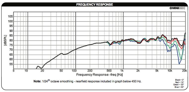

Anyway, here are proper measurements of the CBT24. Both raw without EQ and one with EQ. Take notice that the resolution of the Y axis is high with 3 dB increments. Measurements were conducted over a reflective floor in a normal room, meaning room modes are included.
628575d1501678914-cbt24-line-array-speakers-cbt24-eq-jpg
Pink is with EQ:
628576d1501678914-cbt24-line-array-speakers-cbt24-eq-jpg
That Dayton ND64-16 driver is all cone breakup past 6kHz. (Or is it merely internal cavity resonances?) And then it's EQ'd to BOOST the top end? That sure smells like a recipe for sizzling highs to me, or is that what they call "character"?
