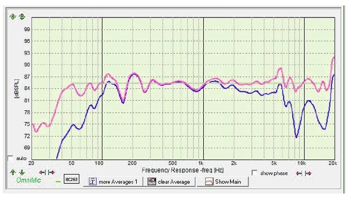

Be aware that the measurements in that review are flawed. They didn't measure correctly.CBT24 reviewed in the latest issue if Sound & Vision.
https://www.magzter.com/US/TEN-:-The-Enthusiast-Network/Sound-&-Vision/Entertainment/234365
There were also several wrong facts in the review and they guy who listened didn't even use measurements with integrating a subwoofer. It confirmed all my negative bias towards hifi reviewers. 😀

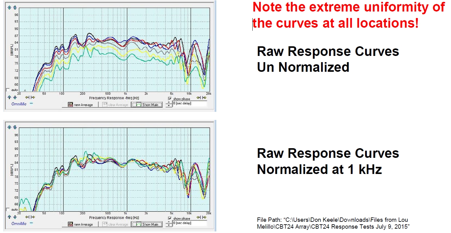

Anyway, here are proper measurements of the CBT24. Both raw without EQ and one with EQ. Take notice that the resolution of the Y axis is high with 3 dB increments. Measurements were conducted over a reflective floor in a normal room, meaning room modes are included.
Pink is with EQ:
Pink is with EQ:

Don Keele sent me a copy of the review. Before you jump on the reviewer (which overall was favorable towards the design) you may want to reconsider a few things.
It's possible the MiniDSP settings were not correct as supplied to the reviewer (different measured transfer function). These are probably the easiest speaker of any to measure. If the transfer function is wrong then that may be the major factor. There could also be QC problems, such as wrong wiring / shading, out of spec drivers, etc. (hopefully not).
Whether it's a hard surface or carpeted the response curves won't vary that much. If they did, then they would be supplying different presets for the type of room being used.
A horizontal off-axis curve would've been nice and more informative.
