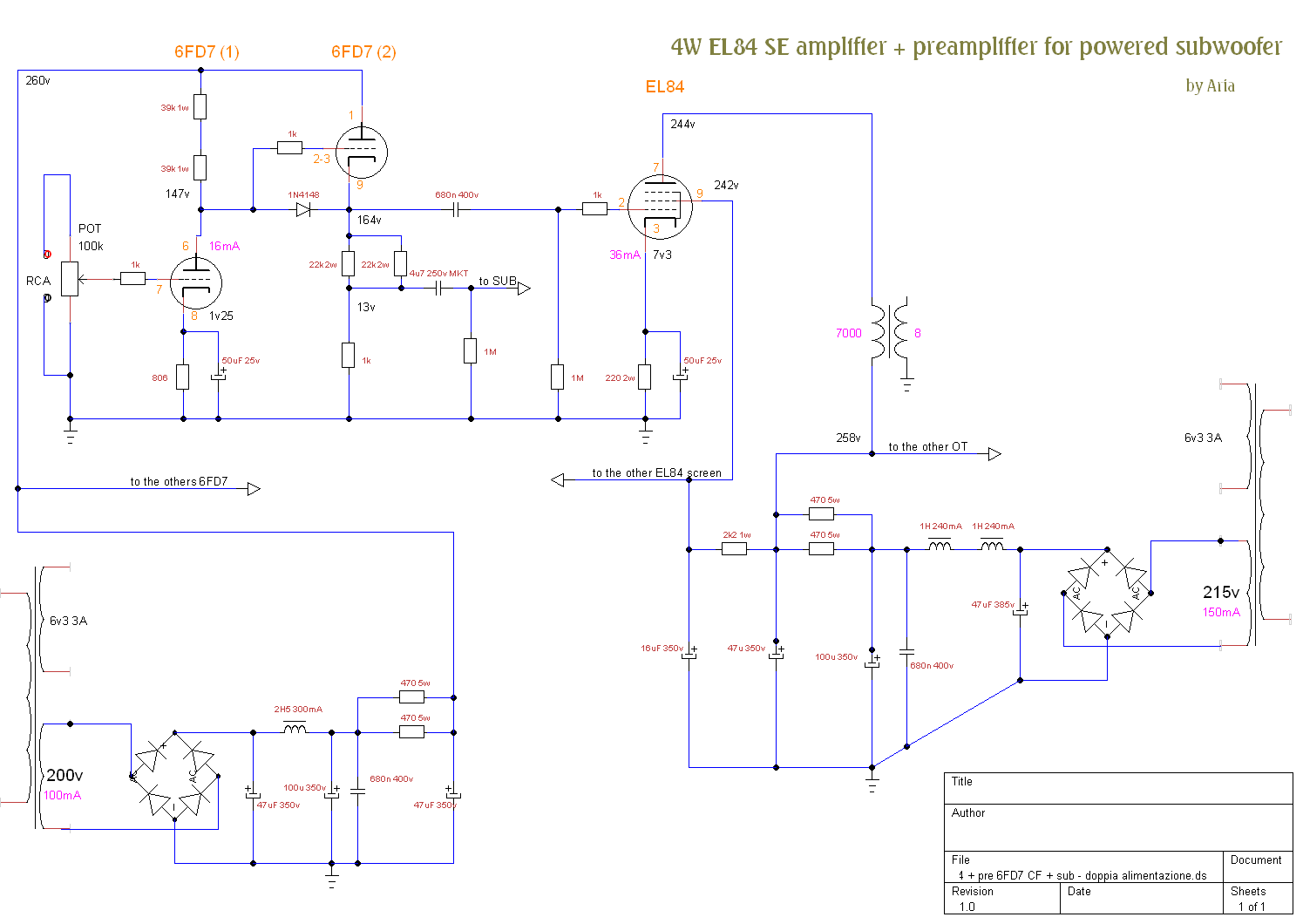

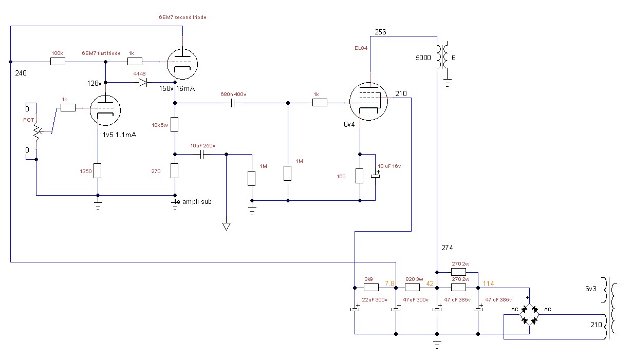

There is a lot of confusion on this post, my fault...
On post 1 there is a sketch of an amplifier with CF that never took off + the schematics of a preamp that I listened to some time ago and which is also present on the net with schematics and legendary explanation (in Italian):
T-Project 1: Preamplificatore a Valvole "Meeting"
After some time I used the same post to question a completely different project that had the use of CF as the only glue. The desire was to think of a very low cost system that sounded good (not high-end necessarily)...
the posistive features of that project which make it accessible to all budgets while maintaining a decent quality are:
1) Using a sub by splitting the signal means being able to have double the power and being able to use a usual medium sensibilty loudspeakers only for the mid-high freq...
2) Using it means being able to use a couple of good old OT found in old radios ... the only discriminating factor is the presence of a 6 ohm secondary winding in order to have an adequate Z Ratio to use EL84s (or any other 5k load tube that has a good response even at 7k) with a pair of usual 8 ohm loudspekers (Philips and other old brands made them)...
3) Using it you can employ few tubes, even inexpensive ones.
4) Using it you don't need a lot of space to build it.

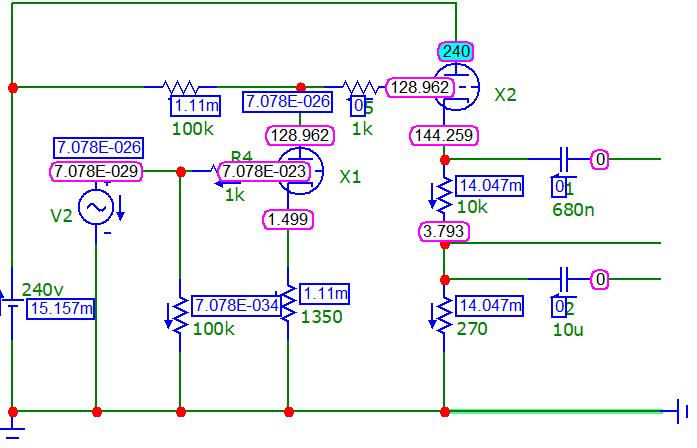

If the line below the 01 out is intended for output it should contain a second cap. Or does the line have another meaning?
the first exit from the top is for the power tube, the second for amplified sub.
Here a small video of the amplifier.
But I need to ask you for some advice: since the preamp is inverting, how can I do to restore the right phase?
EL84 plate impedance is around 40,000 ohms wired as a pentode (at the book operating point at least). To get useful output for HiFi, you can use a 120,000 ohm output transformer (impossible) or throw some feedback around the circuit. A more reasonable option would be to just triode strap the EL84.
You will get more power when triode strapping because the distortion will drop so substantially.
There is also no reason (once you have tamed the gain/THD/damping issues) that you can't take your subwoofer output off the speaker taps.
