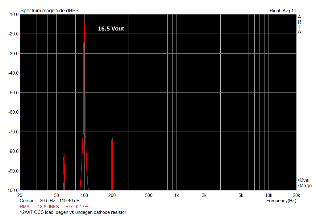

A few years ago, I did some measurements of ECC83 and ECC81 with and without degeneration in the cathode. I expected that, with a CCS load on the plate, the distortion and gain would be about the same. I was very surprised to see that the distortion was significantly higher with the cathode resistor unbypassed. I've moved twice since then and couldn't find my lab notebook with the setup and results documented, so given some recent discussion, I thought I'd just repeat the work.
The circuit: a 12AX7 with a 0.8mA bipolar cascode CCS as a plate load, a 1k6 cathode resistor, and (for the undegenerated setup) a 470u bypass cap across the cathode resistor. The output was directly coupled to a source follower to minimize loading on the plate other than the CCS. 350V B+, 199V on the plate. GE 12AX7 (USA), so nothing exotic. 16.5V output.
To my surprise (and some relief), the distortion curves with and without the bypass cap overlaid perfectly. I repeated the setup and measurement several times to convince myself. Same result each time.
So, since I had a statement about distortion out there that was incorrect, I'm taking this opportunity to correct it. My earlier work was in error (don't know what), and the simple answer turns out to be the right one- the bypass is extraneous IF you have essentially an infinite plate load.
As a side note, look at that distortion spectrum: about -57dB, all second. And that's without optimizing the operating point, just plug and pray.
There's a diff amp in this tube's future...

The nice thing is the spectrum- I was able to spot a little 3rd at -95dB by moving the scale around, but the second totally dominates. This is better performance than the 6SN7 which is a paragon of linearity. Of course, the plates MUST be buffered...
And Ian, yes, that is very much what I'm thinking for the diff amp. If you use a good CCS on the plates but a stiffer CCS in the cathode circuit, the circuit doesn't "fight" and can be brought into a stable balance.

Although the increase in output resistance due to cathode degeneration is likely to be more linear than the original output resistance, as the increase depends on mu (roughly constant) while the original depends on both mu and gm (varies with current).
Is it possible that Stuart's original test was done with a faulty CCS, which had significantly nonlinear impedance? People often imagine that a CCS impedance is (nearly) infinite and (completely) linear. In the back of their minds they know that the 'infinite' is not really true but they can forget that the 'linear' is not really true either. At the high impedance levels seen at a 12AX7 anode (especially if degenerated) you need a very good CCS. Maybe instead of using CCS to measure 12AX7 distortion we should use 12AX7 to measure CCS distortion?
