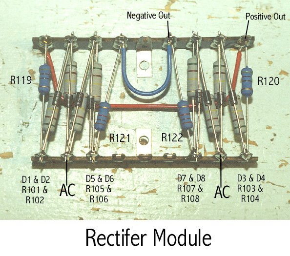

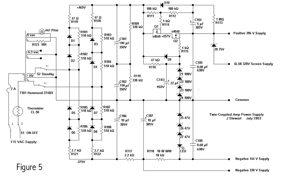

I had escaped from the R&D lab before I managed to layout or make a PCB. Mounting many parts inside the chassis is a problem in that case. So I built modules for several of the main circuits, using terminal strips as the basis. For example, this is the rectifier module used in the clone of Crowhursts Twin Coupled Amp. The terminal strips are simply screwed to a convenient wood block. Then the parts are inserted & soldered.
This is the rectifier module, it contains 8 diodes & 12 resisters. All done!😀

Sometimes both caps & resisters are used. I've done that on some multi KV PS's.This example is OK with only resisters sofar.

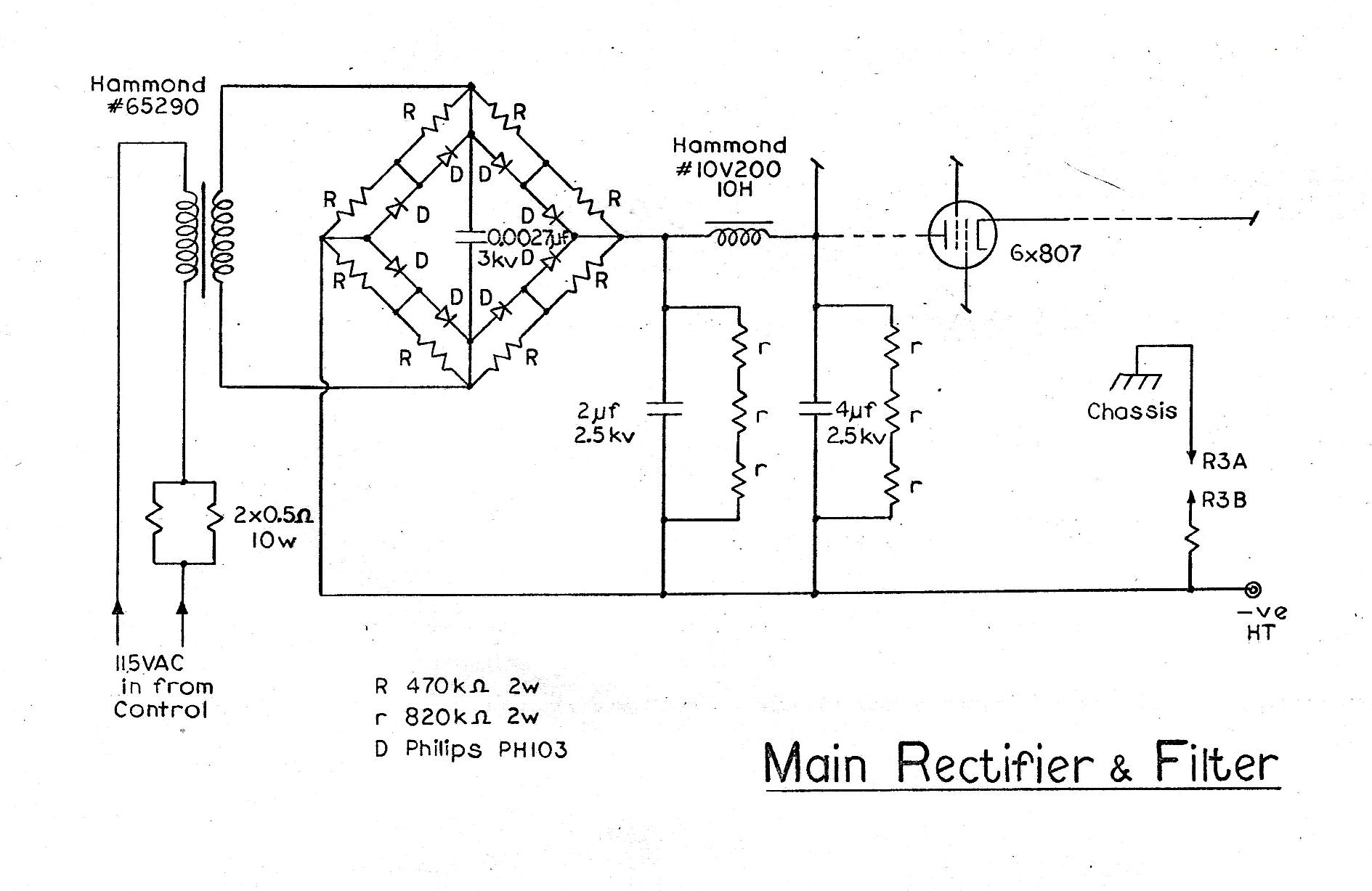

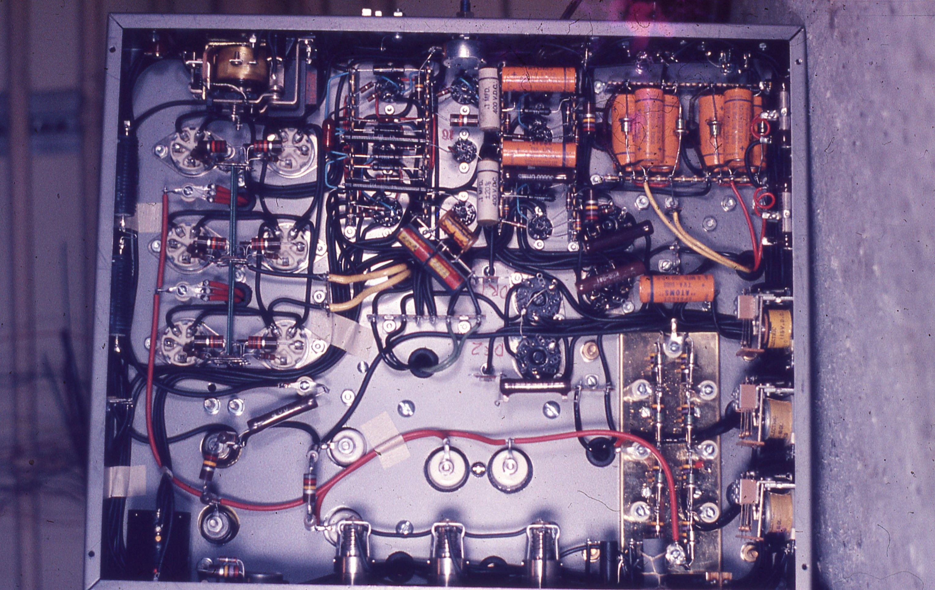

The photo is a 1.6KV, 0.25 Amp Constant Current PS. I think it ended up running a very early He-Ne Laser, hand built by one of the grad students in the lab where I interned. The PT secondary is 1715 volts. The diode bridge consists of six Philips PH103s with 2KV PIV rating. Looks like I used 2W resistors but no caps on this bridge.
The error amplifier is a 2-stage differential thing, all built along the -ve rail which happens to be barely off ground in this kind of application, so very few insulation problems. The diode bridge is in the lower RHS of the photo.
Wish I had more pictures all long ago circa 1960.🙂

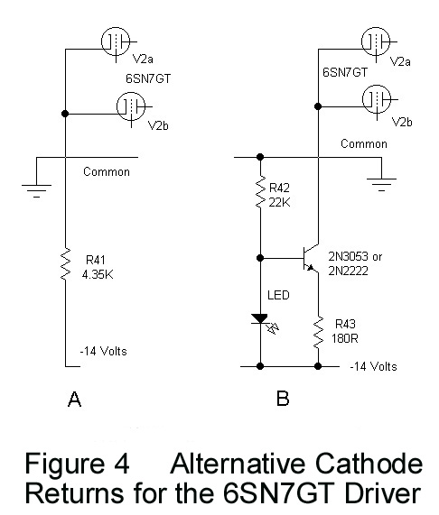

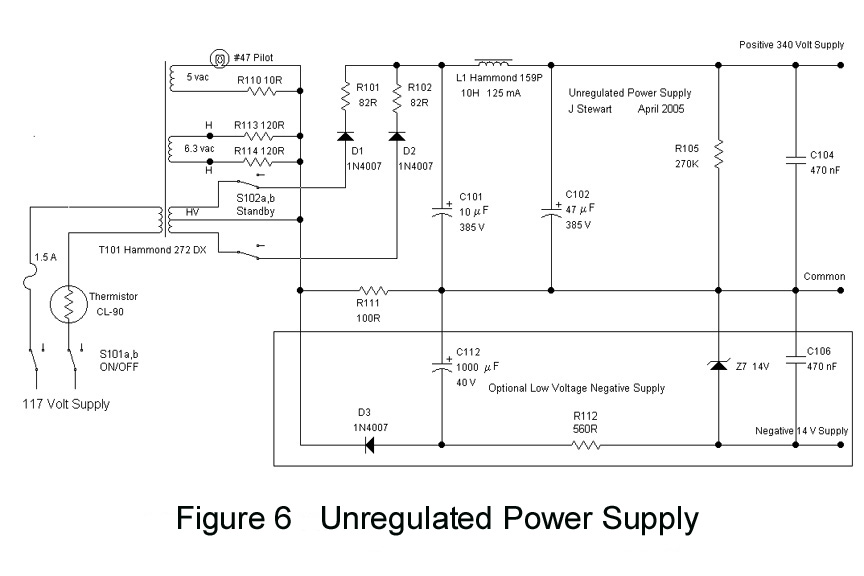

In all my SS B+ PS designs where a PT meant to run with a vacuum tube rectifier I've inserted something like 100R into the connexion between the rectifier cathode & the first cap. That 100R could just as easily be in the lead from the PT HV CT to common. Then the negative going pulses rectified & stored in an electrolytic. Here is one example & the -ve cathode lead it could replace.🙂

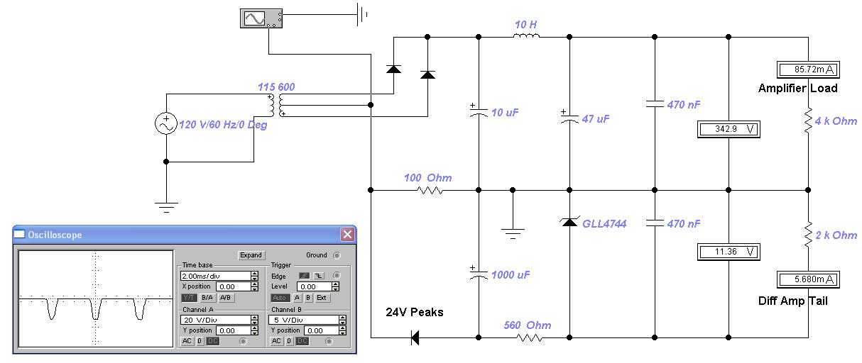

A great question. Without D3 we would simply have back bias. The total volts available would be whatever the total B+ current was times that 100R. In this case that would be ~8.5V & would still need filtering.
The diode picks off the 24V peaks & dumps them into the cap, so more volts are available. The Zener sets whatever is required & a 470 nF Cap strips off any noise.

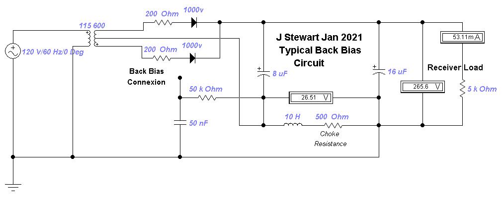

Thought I could avoid this but by popular demand here is a typical back bias circuit. Right out of the 1930s, this was used in many receivers. Sometimes the choke was the loudspeaker field coil. If the resulting voltage was too great a simple voltage divider across the resister/choke was used. The resistances in series with the diodes go partway to simulating vacuum rectifiers. There are no toob rectifiers in the Electronic Workbench simulator, altho I've tricked it sometimes by fixing a triode so so it runs as a diode. That way the 3/2 power law gives a better solution to the simulation. To get even closer PT winding resistances need to be included. And electrolytic cap internal series resistance as well.
But a simple simulation is usually close enough to predict how the circuit will work on the bench.😀
