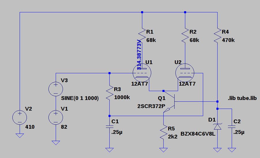

In all my SS B+ PS designs where a PT meant to run with a vacuum tube rectifier I've inserted something like 100R into the connexion between the rectifier cathode & the first cap. That 100R could just as easily be in the lead from the PT HV CT to common. Then the negative going pulses rectified & stored in an electrolytic. Here is one example & the -ve cathode lead it could replace.🙂

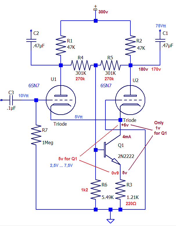

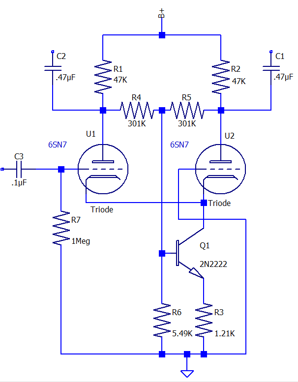

Only at very low singal levels.There isn't enough voltage for Q1 to fuction.
Like this it could work.

A great question. Without D3 we would simply have back bias. The total volts available would be whatever the total B+ current was times that 100R. In this case that would be ~8.5V & would still need filtering.
The diode picks off the 24V peaks & dumps them into the cap, so more volts are available. The Zener sets whatever is required & a 470 nF Cap strips off any noise.
