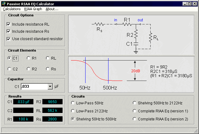

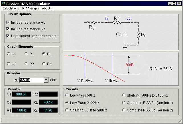

Anyway, I modeled the Lo-Pass 2122Hz and 50Hz to 500Hz shelving filters in the GlassWare RIAA calc and came up with these...
Lo-Pass 2122Hz (75uS)
Shelving 50Hz to 500Hz (318uS and 3180uS)
The Rs (series resistor) is the Zout of the preceding stage (c. 3100 Ohms out for 7788-triode or 7119; doesn't seem to change anything else if I reduce Rs to 2750 or so).
Does this look somewhere near to in-the-ballpark?

I found an RIAA calculator from GlassWare.com, but I don't know how accurate it is. I assume it's OK.
I found a schematic of the audio circuit for one of Arthur Loesch's RIAA preamps in an old issue of Sound Practices.
I also found Thorsten Loesch's Toccata MkII article, which is basically a version of the Arthur Loesch phono pre. Mine is a dumbed-down version of these.
In this three-stage design, I can see that the 75uS filter happens in between the first 5842 stage and the second 6GK5 stage. This looks exactly like the 2122Hz Lo-Pass in the GlassWare calculator.
The 318uS and 3180uS poles happen between the 2nd (6GK5) and 3rd 5687 stages. This looks exactly like the 50Hz to 500Hz shelving as shown in the GlassWare calculator.
I couldn't see anything in the Toccata MkII (or Arthur Loesch's original circuit) that looks like the 500Hz to 2122Hz shelving in the GlassWare calculator. Is that part really necessary? Why is it apparently missing from the Toccata MkII?
If the answer is, "Read Valve Amplifiers" then OK, I will, just as soon as I get it. Just couldn't wait. The important part I want to know is, why doesn't the GlassWare calculator's 500Hz to 2122Hz shelving filter appear anywhere in the Loesch RIAA?
Thanks...

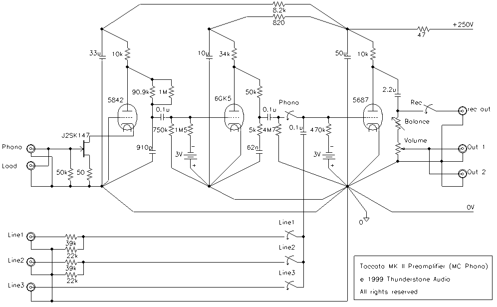

Toccata MkII
webpage:
http://www.fortunecity.com/rivendell/xentar/1179/projects/toccata/Toccata.html
RIAA schematic:
http://www.fortunecity.com/rivendell/xentar/1179/projects/toccata/Toccata.gif
I would be using this version of the first stage (for high-output MC):
http://www.fortunecity.com/rivendell/xentar/1179/projects/toccata/Toccatamm.gif
Thanks. It would be very helpful if I could see (and understand) where this "zero that creates the shelf" is. Maybe something to do with load resistor value?

The 5k and 62n form the zero you're looking for.
Changing from cascode (with an output impedance of the load resistor) to grounded cathode (with an output impedance of the load resistor in parallel with the plate resistance) will move the RIAA around a bit. Less so in this circuit than others, but certainly noticeable.

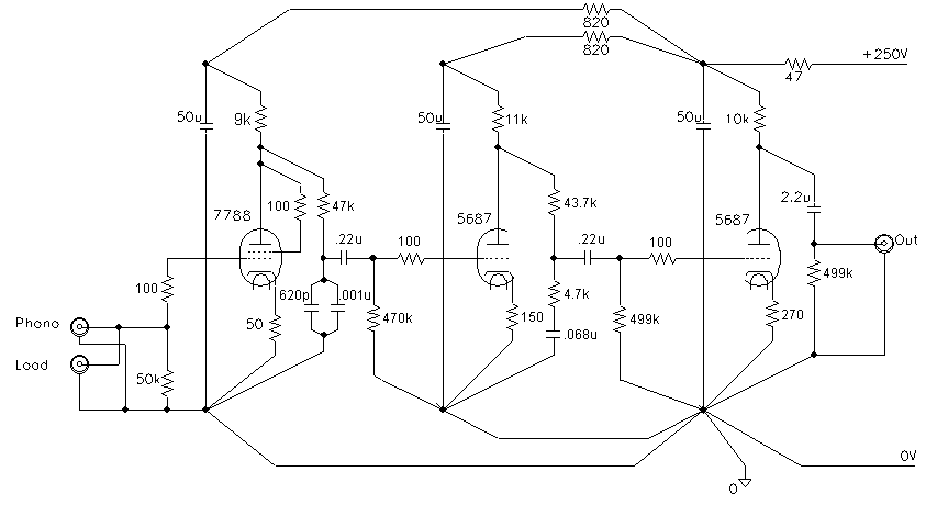

I could increase the 5k resistor to ~10k and decrease value of the 62nF cap to ~33nF and come out with the same RC time constant, correct?
So the 5k and 62nF would be equivalent to the R2 (9659 Ohms) and C1 (.033uF) in this below?:
Something like this? (attached file ending in "ALTERED")

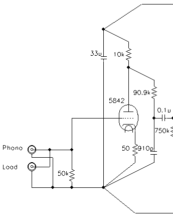

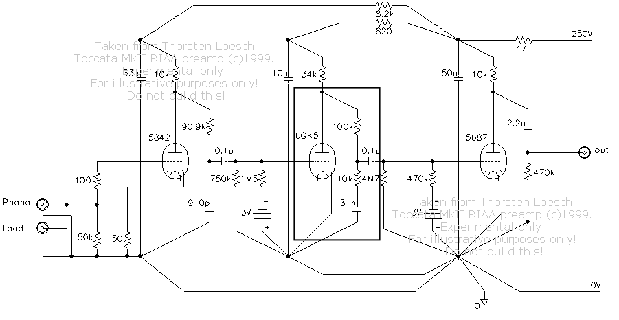

Thorsten had this alteration to the first stage, for use with MM instead of low-output MC:

Well, you're getting there, but R2 is really the combination of Rs (the output impedance of the 5687 at the operating point you have chosen) and R1 (47k) divided by 9 which will be somewhat larger than what you indicate. You then obtain the capacitor value by dividing 3180us by the combination of Rs + R1 + R2 which will be lower than 68nF. All this depends on the next stage having a very high input impedance and negligible input capacitance (i.e. a cathode follower). If it is an amplifier stage, like in the Toccata, it will interact with the 318 + 3180us stage and even Morgan needed a computer to work the sums out. If you use valves with high gain and a moving magnet cartridge you only need two gain stages.
Looking back at your diagram I see I've misread it and you have 43.7K which is 4.7K x 9, but you have missed Rs out of the equation. I think you would be better off using a standard value for R1 and a parallel combination for R2. 68nf will still be wrong as (Rs + 43.7k + 4.7K) x 68nF will be well over 3300uS.

About the input stage, I'd have to work out the Rs figure for the 7788 (or E810F as we call it) which means finding my Mullard manual with the triode-connected figures in it. It looks reasonable, but why 9K for the anode load (10Ks are readily available in any flavour and wattage you want)?
Looking back at the diagram I see you're using a second section of the 5687 as a third stage amplifier which negates all the calculations of the 318 + 3180us section, as I explained.
I would use a higher gain second stage and employ the 5687 as a third stage cathode follower.
