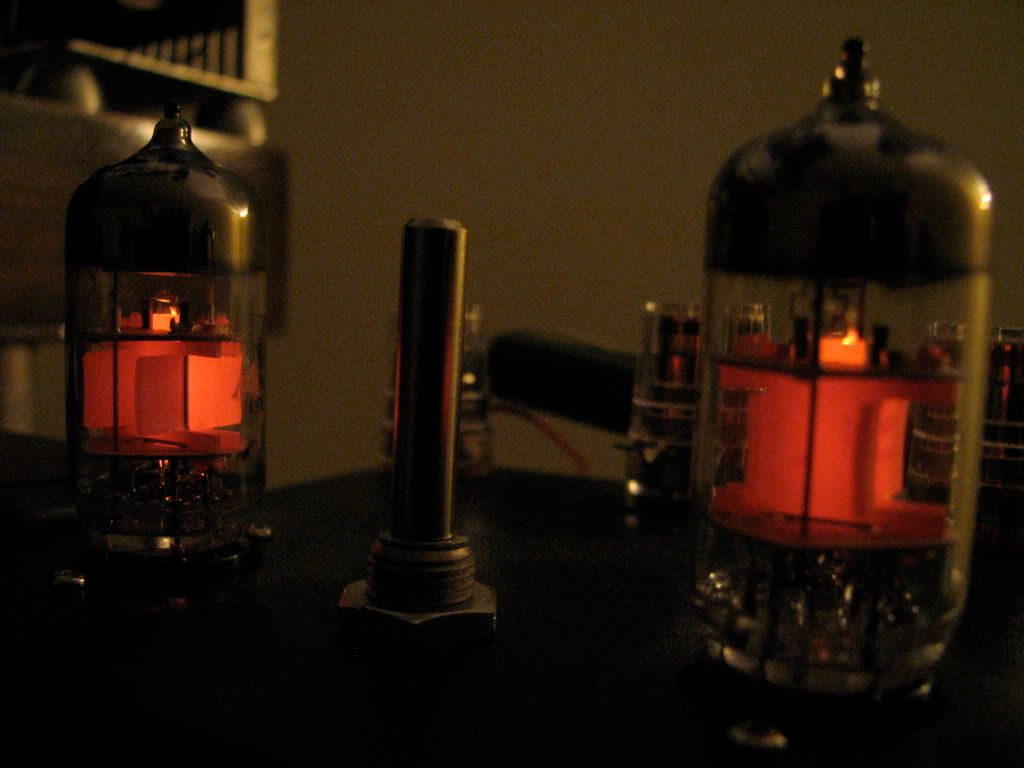

Got myself (and my soldering iron) into the "heated state" last night. I picked up one of those grab bags of LEDs at my local Radio Shack and soldered a pair of red ones into the cathodes of the first stage of my phono pre (a work in progress...). Those went in place of the single 1N4148s that were already there. The stage went from:
7788/E810F triode wired
Rplate = 4kOhm (WW-NI 10W)
Ip = ~30mA
Ec = -0.75V
Ep = 90V
..to (with red LED in cathode):
Rplate = 4kOhm
Ip = ~18mA
Ec = -1.9V
Ep = 150V
I thought that was too much bias (and plate voltage too high), so I changed the LED out to two 1N4148 in series:
Rplate = 4kOhm
Ip = ~20mA
Ec = -1.5V
Ep = 115V
...And that's where I left it. I did like the red LEDs lighting up when the tubes warmed up. I'll definitely do something with that. Maybe in the line stage (1/2 5687 per side).

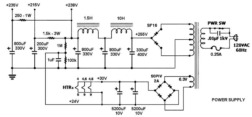

Hello again.
Here's the schematic of my phono preamp. Actually, two schematics.
First the audio circuit:
And here's the power supply:
I know the power supply is dual-mono (separate xfrmrs for each channel, etc.) and yes, it's crude. The chokes were already in the chassis, as were the tube sockets, etc. I didn't intend to build anything this touchy, but I was (foolishly) trying to build a preamp for a Denon DL-103. The preamp turned out to be too noisy (both hum and hiss), but then I tried it with a high-output Denon DL-110 and found it to be a really good match! So I swapped in an appropriate load resistor and started tweaking. Then I found this site.
I'm enjoying the preamp's sound, but it seems a bit forward or edgy. It's better now that I upped the bias on the first stage, but I wonder if the RIAA is way off.
Or maybe I'm hearing the power supply's shortcomings. Resonances? Maybe those whopping big capacitors need to be scaled back, or bypassed with film caps?
OK, go ahead. Pick it apart. I'm ready!

I haven't checked the math on your RIAA, but a couple of things jump out at me. First and foremost is that first stage. I don't have triode curves for the 7788 at hand, but unless the plate resistance is really, really low, the plate load you have for it is throwing away badly-needed gain and operating the tube with a load line that is too steep. I'd explore increasing the load resistance and upping the B+.
Second, you could get more headroom in the second stage by increasing both B+ and bias. In an RC-coupled circuit, you want LOTS of headroom to prevent any chance of blocking distortion, which can really harsh things up.
It would be worthwhile running a frequency response check and tweaking the RIAA into conformance by adjusting the 100k resistors first. You can either build an inverse network or use a function generator (cheap and very flat) with an attenuator to drive the circuit, then measure the RIAA conformance directly. Getting that right, and very well-matched between channels, is a major pain but will make the difference between OK and excellent performance.
While you're at it, you might want to use a separate heater transformer or at least build in some common-mode filtering- the B+ supply will generate some diode noise which will couple very efficiently through the 6.3V windings and then into the tubes. The cathodes are pretty close to ground, which is good, but it's best to stomp out the noise at the source.

2) Second stage: The raw plate supply in this chassis is limited to about 250V. It's 238V after the CLCLC sections. That doesn't leave me a lot of room to both increase plate resistance and keep bias high enough (over -1V) on the second stage.
What if I changed the second stage 15k plate resistor to 10k, like it is in the final stage? I could bring the Ip on the second stage up to about 15mA and get the rp down on that 5687 to about 2.5k Ohms -- in which case wouldn't a 10k resistor be a large enough value for the plate load?
Remember that I don't intend to use this preamp with low output MC's. Just high-output carts (Denon or Grado, probably). I have an old pair of Tamura step-up trannies which I could use if I somehow come into a DL-103 or whatever.

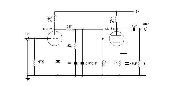

Here is another RIAA calculator that I have used with success.
http://www.kabusa.com/riaa.htm
I have built very good sounding single stage passive RIAA around the teflon russian caps found cheap on Ebay. .1uf and .033uf
Thanks greenvalve.
The resistor marked with * in the schematic, that looks like a grid-leak resistor. What value do you choose? 10M? Do you calculate/adjust the value of the grid leak resistor to obtain your desired bias point for the second 6S45Pi? Does this grid leak resistor change the RIAA slope at all?
I see you chose a 33k Ohm resistor for the plate load on the first 6S45Pi. That would mean a rather high B+, wouldn't it? That 33k plate resistor would drop 330V at only 10 mA, and I know the 6S45Pi can take a lot more current than that. Are you running the first stage 6S45Pi at a very low plate current?
I like the direct coupling of the two stages, but wouldn't that cause possible problems from record warps?
The chassis I'm working in already has two 9-pin sockets installed, which I'd like to keep using. It originally had one of those (common) two-stage RIAA circuits with each stage followed by a cathode follower.
There is quite a variance with the 6s45p tube, so the *R is actually a 1M 2W pot, I use it as you said, to fine tune the bias on the second tube. Even that does not guarantee a particular tube will function as hoped. B+ is around 425V and the plate voltage is around 100V on the first tube IIRC. Too much current through these tubes and the third-order harmonics start becoming audible. Stunning bass, no problems with warp or drivers bottoming out. If your worried, reduce the value of the output cap. The 6s45p is a single triode, so you would need four 9-pin sockets. I've build many phono stages and I like this one the best. It has enough gain to eliminate an entire stage, and another coupling cap, so that is probably part of it's good sonics.
The good value part of this phono stage is the use of the teflon russian caps. Perhaps there is another tube that would function well with the 22k RIAA loading resistor and the .1uf / .033uf caps. There are some unappreciated good sounding high gain 7-pin tubes out there.

I like the sound of 6DJ8, it would make a good phono tube. Also the russian 6n1p-ev is very good sounding. Just try it and see what you think.
Here is a picture of my 6s45p spud amplifier. The tube can conduct some current i guess
