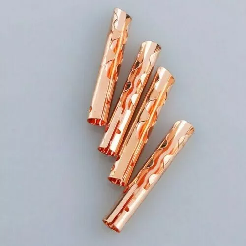

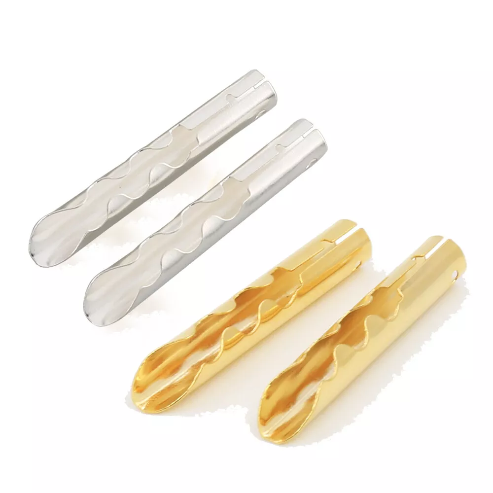

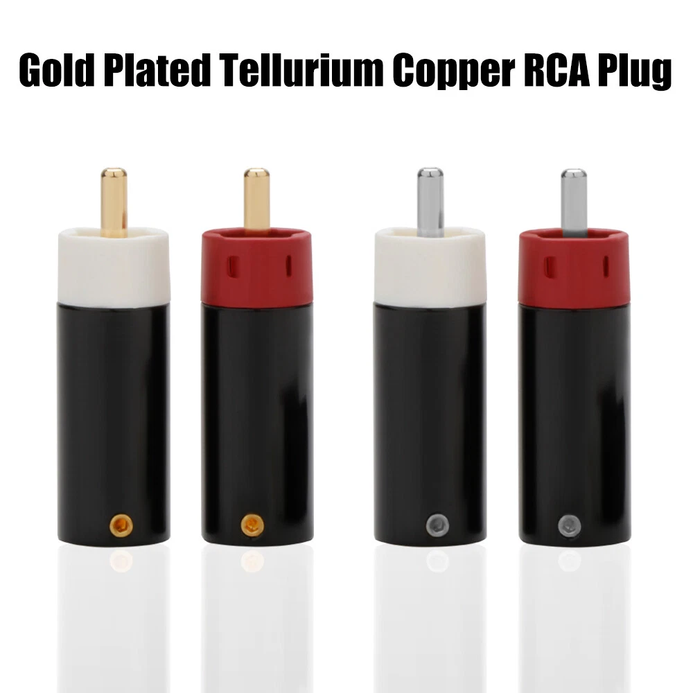

I made speaker cables and interconnects from CAT5 a long time ago, as well as some other wires, thinner and thicker, both multistrand and solid core. I also tried super thin wires according to the Allen Wright Cables Cookbook. I was not impressed with any of these, and ended up with VDH CS122 and VDH D102MK3 for a long time. I made 230VAC cables from VDH CS12.
Every now and then someone brings me an expensive cable to test. There are better and worse ones than mine, but I won't be changing them anytime soon. Instead of banana plugs, I used those 4mm hollow plugs. For interconnects I take these plastic RCA plugs.
I experimented a bit, tried various things, and when I came to an acceptable solution, I stopped there. I'm not a cable maniac, just for the record. 🤣
