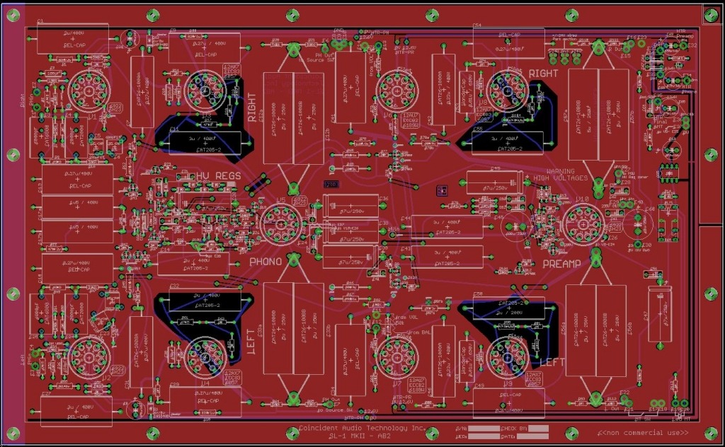

While doing the schematics, it was difficult to trace the PCB, and to see where all the traces were going, so to help me I started making a PCB, to help tracing, and figuring the schematics. When I was done I had a pretty close PCB, probably with some errors, but enough to complete my schematics and the repair.

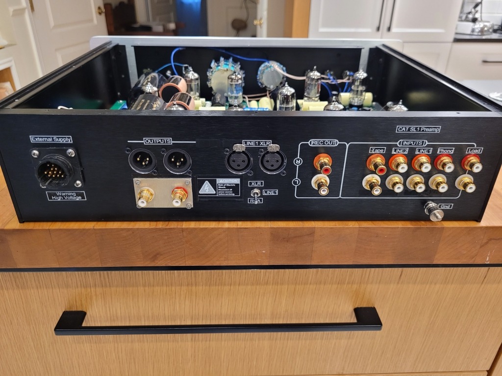

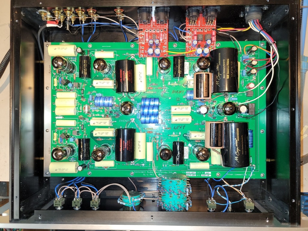

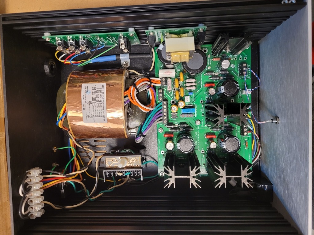

I was pretty close the first time, and I was confident I had the real thing. During COVID I had spare time and decided to make myself a CAT SL1, my own version. To improve on the thing I don't like about the originals I worked on I decided to make these changes:

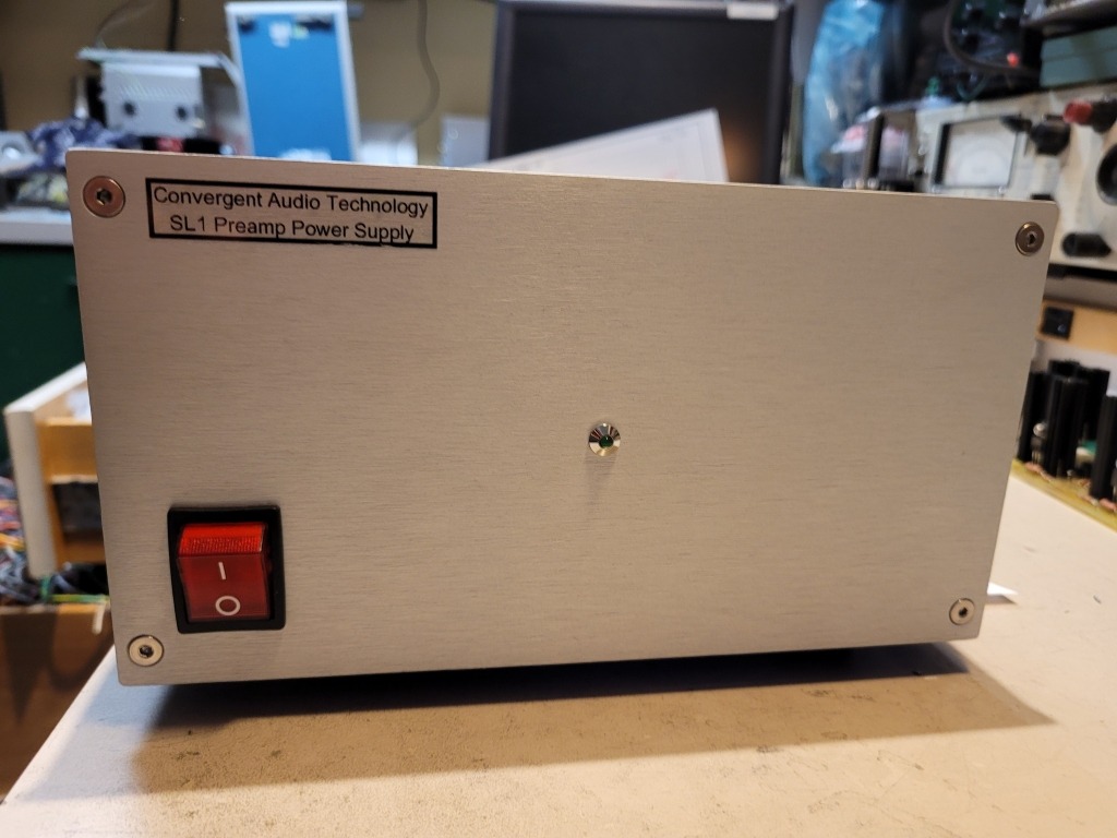

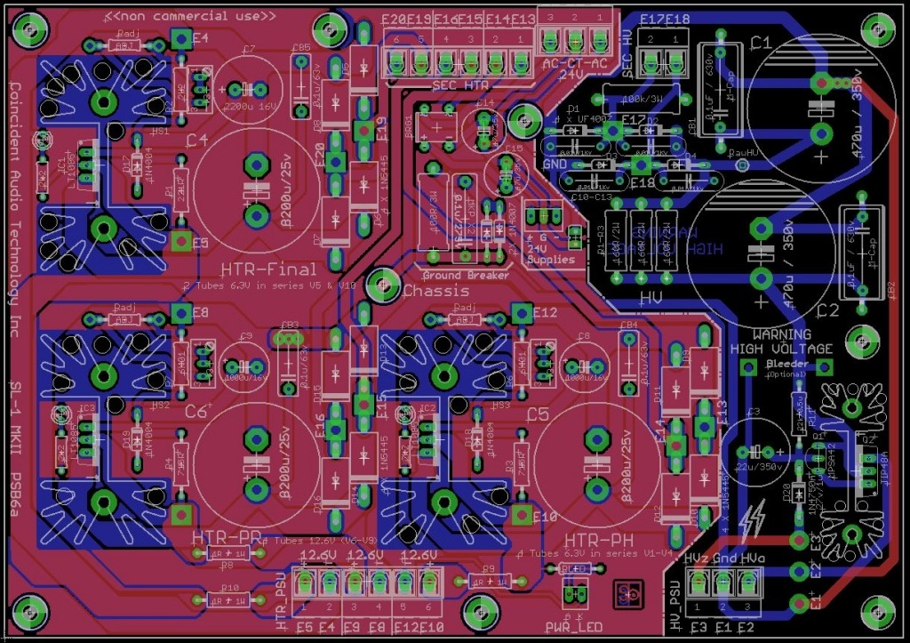

-Better made external power supply, with larger enclosure, proper layout, bigger regulator heatsinks, CRC filtering and better caps on the HV section, Separate fuses on all the outputs (Heaters and HV), and since I want SE/BAL converters in the preamp, extra +/-24V supply for these converters.
-I hate the original cable between the supply and preamp. It can't be disconnected, it is large gauge, not very good quality ( at least on the ones I saw), make working on the preamp difficult, etc... So I want a flexible cable, with detachable connector at the preamp. I know, it may not sound as good as the fixed one, but no way I'll have a captive cable on my preamp...
-Added a ground breaker to the supply, my own version of the Ayre noise filter and Furutech IEC AC inlet connector.

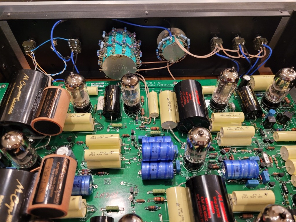

-The original used the excellent, and now gone REL-Caps everywhere (the new one have custom made caps). I cannot get REL-Caps, so used more mondain IC film caps for the supply, and Mundorf caps for coupling. For the output I went over the board with Mundorf Supreme Silver/Gold/Oil caps, bypassed with Duelund copper foil.
-The original has the excellent ROE resista resistors. One of my friend was able to give my most of the values I needed. Used a mix of Tantalum and Shinkoh and Kiwame resistors for the rest.
-The original used for volume an Electroswitch 24 steps attenuator with ROE descrete resistors. Again impossible to get, found a 4 decks one on ebay. Mounted all the ROE resistors, ans it tested fine.
-The Balance used a smart way of doing the balance without impacting on the channel crosstalk. It adds resistors on the lowering channel, in fact increasing these channel volume total value, decreasing the actual volume, while the other channel don't move, clever. Again it is using an Electroswitch rotary switch, got this one at Mouser...
-I made a few years back small SE/BAL and BAL/SE converter PCB, using the mostly transparent DRV134 and INA2134 chips. I installed them inside the preamp. The SE/BAL input converter is only on the CH1 input, with a switch to select between RCA and XLR. The SE/BAL output converter is at the output. Since this preamp can produce HUGE output level, I installed +/-12V protection zener at the input, in fact limiting the preamp to +/-12Vpk-pk output. If the preamp is so good I may install Lundhall balanced output down the road...
-The MK2 version I saw use Cardas hook-up wiring, I used the same.
So, here my preamp, after all this work I'm very happy with the result, no noise, phono section has a perfect RIAA curve after some tuning, same gain on both channels with the tubes I used, very stable HV supply with no noise. Yes I used a clone enclosure from China but I remade completly the rear panel, and trashed the included cheap toggle switches, bought good quality C&K ones.
Here a few measurements:
Preamp Section gain: 25.5dB, BW 836Khz, Vout max 50Vac (limited now by the SE/BAL converter inout zener at +-12Vpk-pk), THD: 0.01%, noise <1.2mvac, Zout around 500 ohms.
Phono section gain: 45dB with external load connector. Huge overload threshold. My friend use it with a Denon DL103 without problem...

Sorry no schematics, this preamp is still a commercial product. I did my own version. No insurance I made it right everywhere. It is good for me, but it is not the real thing. Just the caps are impossible to get, and contribute certainly to the original great sound. Without a real one by your side, with all the little details evrywhere it would be very difficult to reproduce.

That’s pretty close to the real thing. The phono section RIAA values are incorrect thought. There are a few errors here and there but you get the idea of the circuit. I also found this schematic back then and used it against my own traced ones. It makes sense, in particular the HV regs section is ok…
But there are errors, for example if you follow this schematic the mute relay will never unmute…
Also this schematic needs the pcb layout to really makes it sing. The ground layout in particular is pretty fancy, with high current insulation sections, star ground, ex… some sections also have no ground plane to reduce capacitive effect, really needed for high impedance sections.
As always, a good design is maybe 70% circuit topology, 30% pcb layout. Looking at the schematic you can guess why it took me months to design the pcb for it.
