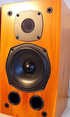

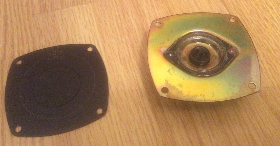

Maybe one of you knows this by chance ; are the tweeters in the Castle Trent I and Trent II the same ?
I have a pair of Trent IIs with one blown tweeter, which I want to keep for sentimental reasons, and consider looking for a Trent I for spare parts, as they sell for less .
Also, allegedly some other Castle models of the period use the same tweeters as the Trent II , the Warwick and Richmond , see here (German , sorry ) .
I've searched long and hard, but can't find any more information on tweeter compatibility for the Castle speakers .

Yes, I read the threads that didcussed replacement tweeters for Trents .
I might not have been perfectly clear, but I'm looking for original parts , or information on them .

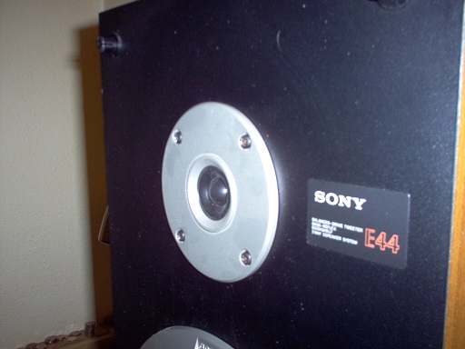

I've always liked the sound of mylar cone/dome types. And cone tweeters in general. So Castle (who are now owned by a Chinese conglomorate) have a goodish idea there. I even have a small mylar cone type, from the Sony E44. It's got a nice sound. Looks like a 5" polycone bass.

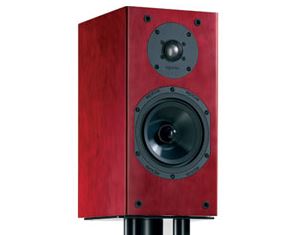

The last picture is the Epos M12i with a metal dome tweeter. It's good, by all accounts.

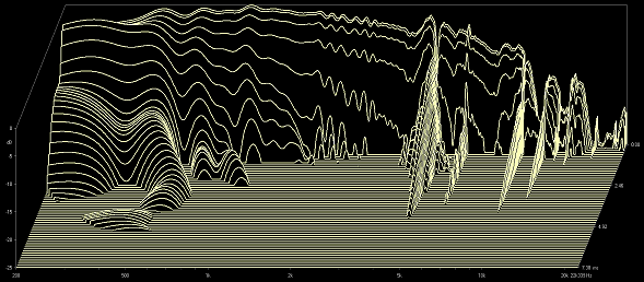

Robin was dead right about the horrors of soft domes. Beautiful frequency response, flat load. Terrible sound. Why, well you've got to measure the right thing. It's the waterfall plot (stored energy in breakup modes...) which shows it up. Troels Gravesen's graph for a 3" soft dome ATC mid below. Goes to pieces at 4kHz.
Troels is firmly in the SB and Vifa ring radiator camp, these days. Which pins the centre of the soft dome and stops it flapping about at high frequency. They weren't around in Robin's day. You can also fit a Zobel RC network across a metal dome, which tames them a bit, because we know they get problematic above 20kHz. You might not hear it, but the amp feels it.

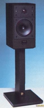

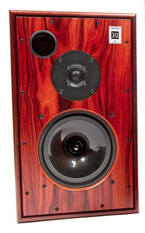

My ignorance notwithstanding, I'll have you know that the 'vintage' Celestion SL600 is still wiping the floor with anything Epos, Harbeth and such have ever dreamed up .
What I know about the Celestion SL600, is that it is a tiny 12L closed box made of some light and rigid materials with rubbery cabinet damping applied. Quite BBC.
The crossover is a simple enough 2nd/3rd order design at 2.3kHz. The bass is a 6" plastic unit. The tweeter, a slightly larger than 1" unit made of copper, and later due to tooling problems, aluminium.
I suspect that Alan Shaw at Harbeth is applying a similar concept in his designs. If I was looking for modern units along the same lines, I might go to SEAS.
