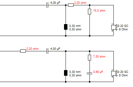

I had another look at the sim, and I think you should buy a pair of 7W 6.2R, 10R and 15R wirewounds at Maplin. 10W types 5cm long, 7W are 3.5cm.
Looks easy to fit a resistor on front of the filter and 15R shunt across the tweeter.
So either 6.2R or 10R in front of the filter will get level right IMO. I'd start with 10R here with a little 5" bass. Tough as old boots, wirewounds, you won't damage them with heat.
Don't be afraid to drill a couple of holes in the tracks and scrape off the enamel either.

Steve, idid as you suggested but it was to drastic a reduction. So i decided to get one variable L pad so i could experiment better,, got it matching the original quite well using tones and music, then fitted fixed resistors in both xovers and changed the tweeter in the other one. All now good. Ended up with values of 1R and 37 R after the crossover.

I'm really quite surprised you got away with a mere 2dB of attenuation here, but trust your ears and taste. Nice. 🙂

495993d1438126620-castle-trent-2-tweeter-attenuating-tweeter-output-2-png
I was pretty rubbish on guessing what attenuation was required for a new Monacor HT-22 cone tweeter. But it worked. Just add the 2.2R really.
