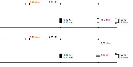

I had another look at the sim, and I think you should buy a pair of 7W 6.2R, 10R and 15R wirewounds at Maplin. 10W types 5cm long, 7W are 3.5cm.
Looks easy to fit a resistor on front of the filter and 15R shunt across the tweeter.
So either 6.2R or 10R in front of the filter will get level right IMO. I'd start with 10R here with a little 5" bass. Tough as old boots, wirewounds, you won't damage them with heat.
Don't be afraid to drill a couple of holes in the tracks and scrape off the enamel either.

Well i got them sounding great again!
Steve, idid as you suggested but it was to drastic a reduction. So i decided to get one variable L pad so i could experiment better,, got it matching the original quite well using tones and music, then fitted fixed resistors in both xovers and changed the tweeter in the other one. All now good. Ended up with values of 1R and 37 R after the crossover.
Thanks again for all the input.

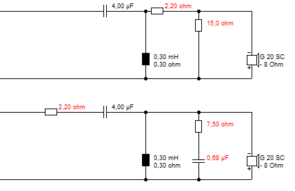

I was pretty rubbish on guessing what attenuation was required for a new Monacor HT-22 cone tweeter. But it worked. Just add the 2.2R really.

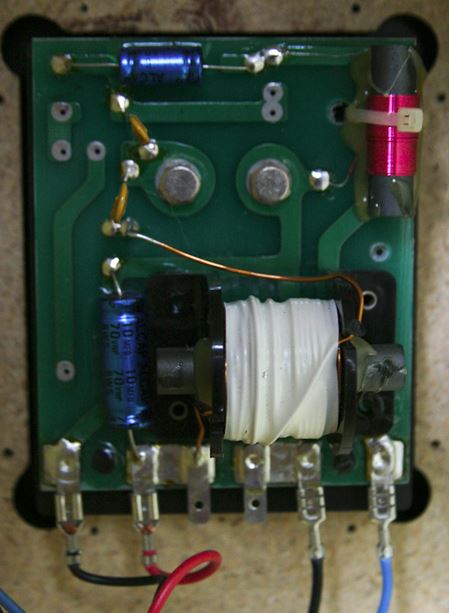

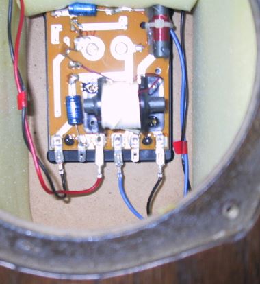

Dear Steve, this is the layout and appearance of my filter. Section in some sites write 3000 Hz in some 5000 Hz. I do not know the resistance of the WOOFER is probably 4 Ohms. I want to change the coils to tape but do not know their denominations. On forums in Russia Castle there is no. If you can tell me. Sorry for the translation.
vova1968 said:Steve I couldn't load the filter schema so I write like this. On the RF 4.7 UF capacitor and coil ?. At low frequency the capacitor is 6.8 uf and the coil ? There are no resistors in the filter. Whatever you recommend.

8 ohm nominal drivers you'd think. It's probably 1.5mH or thereabout on the bass filter for 3kHz crossover with 6.8uF.The tweeter coil might be 0.22mH with 4.7uF.
All guesswork! But 1.5mH coil won't be far off. Don't expect to much change with a tape coil. But better than ferrite I expect. I would think the tweeter coil is an aircoil, so hard to improve.

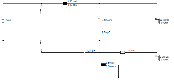

Dear Steve, I need to put a resistor at 15R in front of the RF speaker as You have in the scheme????I installed a 2.2 R resistor after the capacitor in front of the RF speaker.
