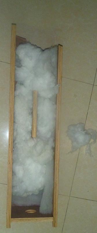

Stuffing
Dave,

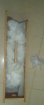

Here you go with a pic of polyester fluff I took out of a cushion. Fluffier but denser material vs the poly batting... feels like a fluffy springy synthetic cotton - is this the Dacron polyfill people talk about?
Have I over-stuffed by any chance?
Also attached a pic of a "grabber" tool used for picking up things and litter. Even if I seal the cab completely, I can use this to pinch poly fluff in an out - just need to careful I don't nudge the drivers.
-Zia
That is using bats of polyfluff... for pensil or microTower i would be "shredding/fluffing" that into a more or less homogenous volume fill.

Dave,
-Zia
Dave,
-Zia
