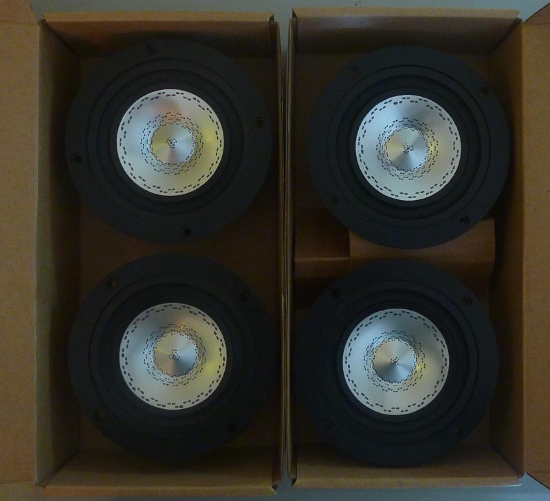

Drivers
The drivers for this project are Planet 10 modified CHR70 MK2.
Very happy with shipping and service from Planet 10, thanks Dave.
I have 40 hours of break in done for all the drivers. Will get some more before sounding off big time with the Micro Towers...

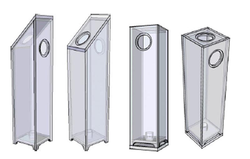

Many flavors, which one to choose?

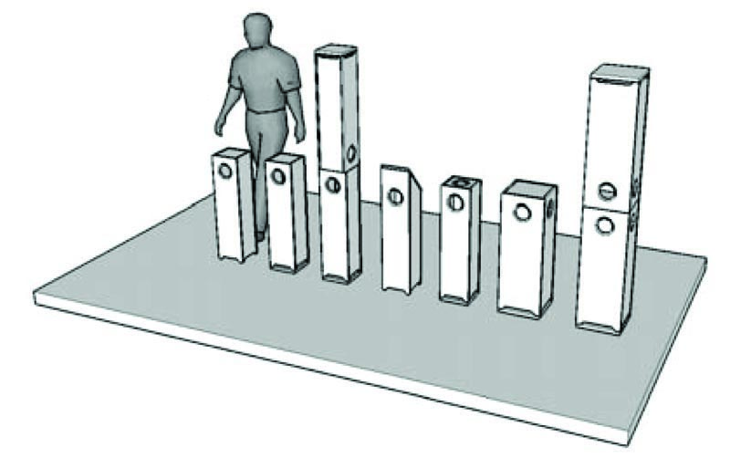

If you go through the MT plans, you'll see that there are a good number of variants.
For me the "castle" or sloped design caught my eye... I liked the aesthetic. Initially I was thinking of doing the 45 degree incline build, finally went for the 15 degrees. The attached image is an illustration from the Planet 10 MT plans file showing the standard MT and the 45 degree inclined top model.
Regarding WAF, my wife liked the design the first time I showed it to her and voted for the "castle" look. Good, more power to the towers!

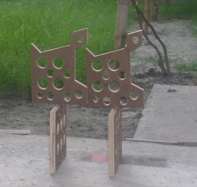

Cutting the pieces for teh build
I used 18mm ply, the plans on the site are for 15 mm ply board.
I kept the internal dimensions same as the original and cut the pieces accordingly.
Again there are some holey braces and more to that on the next post.

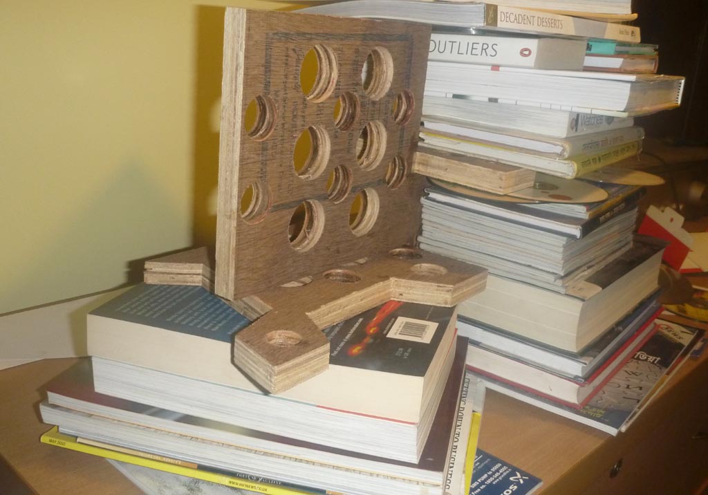

Braces for the Castel Microtower
Adapted Dave's holey brace design for this build.
Since I do not have clamps, the books came in handy while gueing the two pieces together. :)

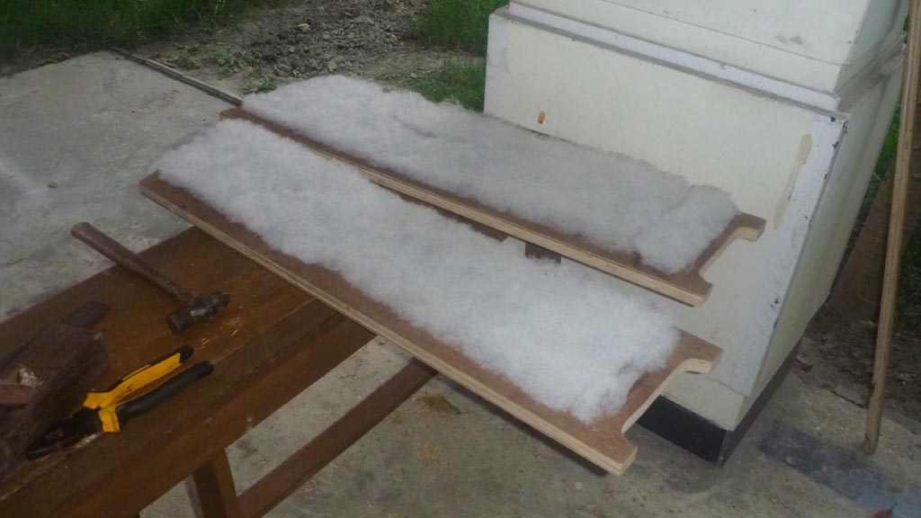

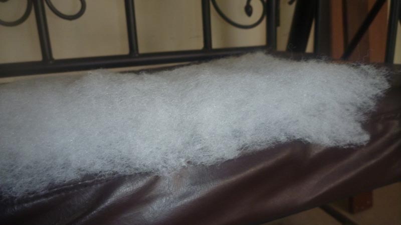

Damping
At first I had assumed that damping would be like BIB or Pensil 12, where there removable panels at the front or back to adust damping level to room need and personal preference. Then I realized that the MTs do not have a removable panel option in the original design.
Going through the plans again, I discovered that acosutic fibre glass wool is recommended. After asking at the forum I learnt that poly batting will also work.
It took me aday to track down some 1" thick poly batting. Fixed this with glue to the insides of the back and both sides.

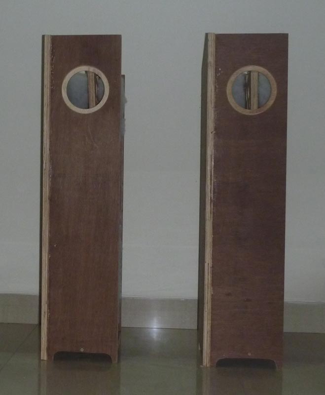

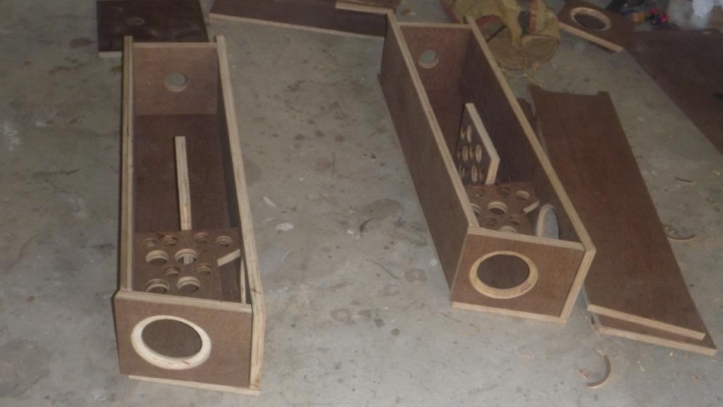

Putting the parts together
Finished cutting the pieces, making the braces, cutting the driver holes, and finaly fixing the damping material - so time to put the cabs together.
Have one side and the top open as of now.

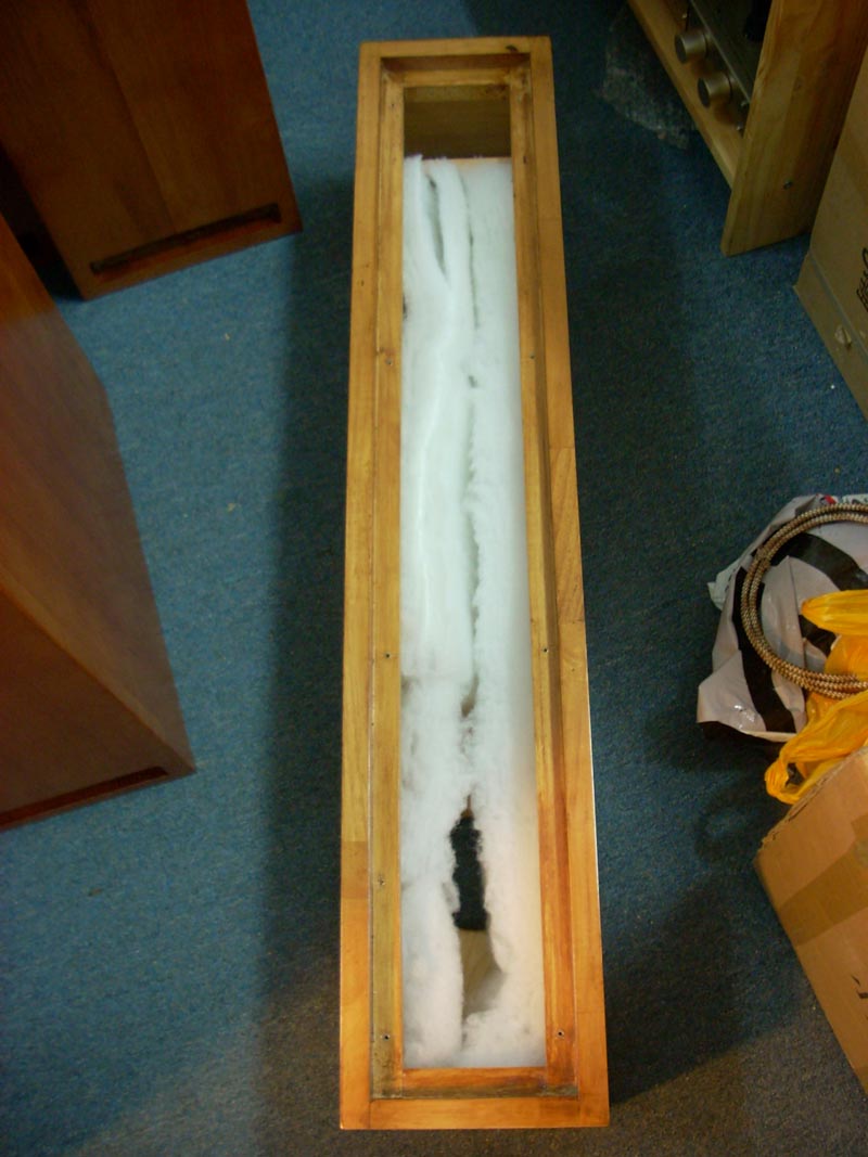

Removable side panel?
Dave, Chrisb,
Since one side of the cab is still not glued up, I can consider making the side panel removable... the main reason for this would be to have the flexibility of adjusting the stuffing. A thin rubber foam gasket can be used to keep the edge more or less sealed.
For removable panel I have the option of directly making screw holes into the sides, or use cleats (illustration attached).
-Zia
