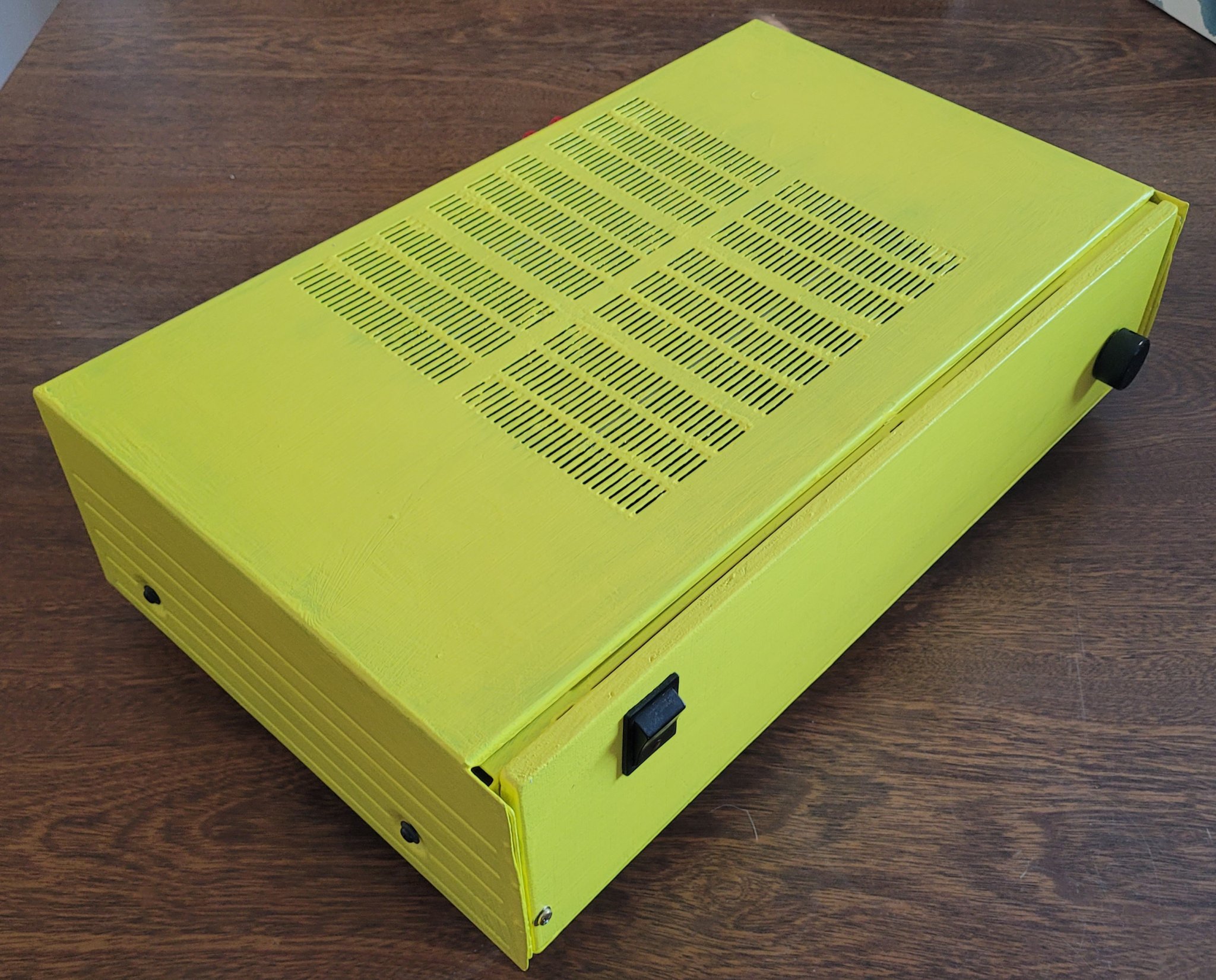

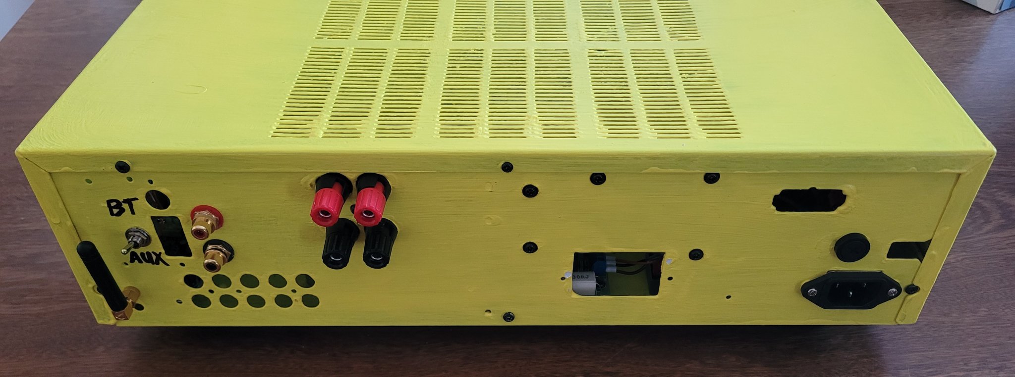

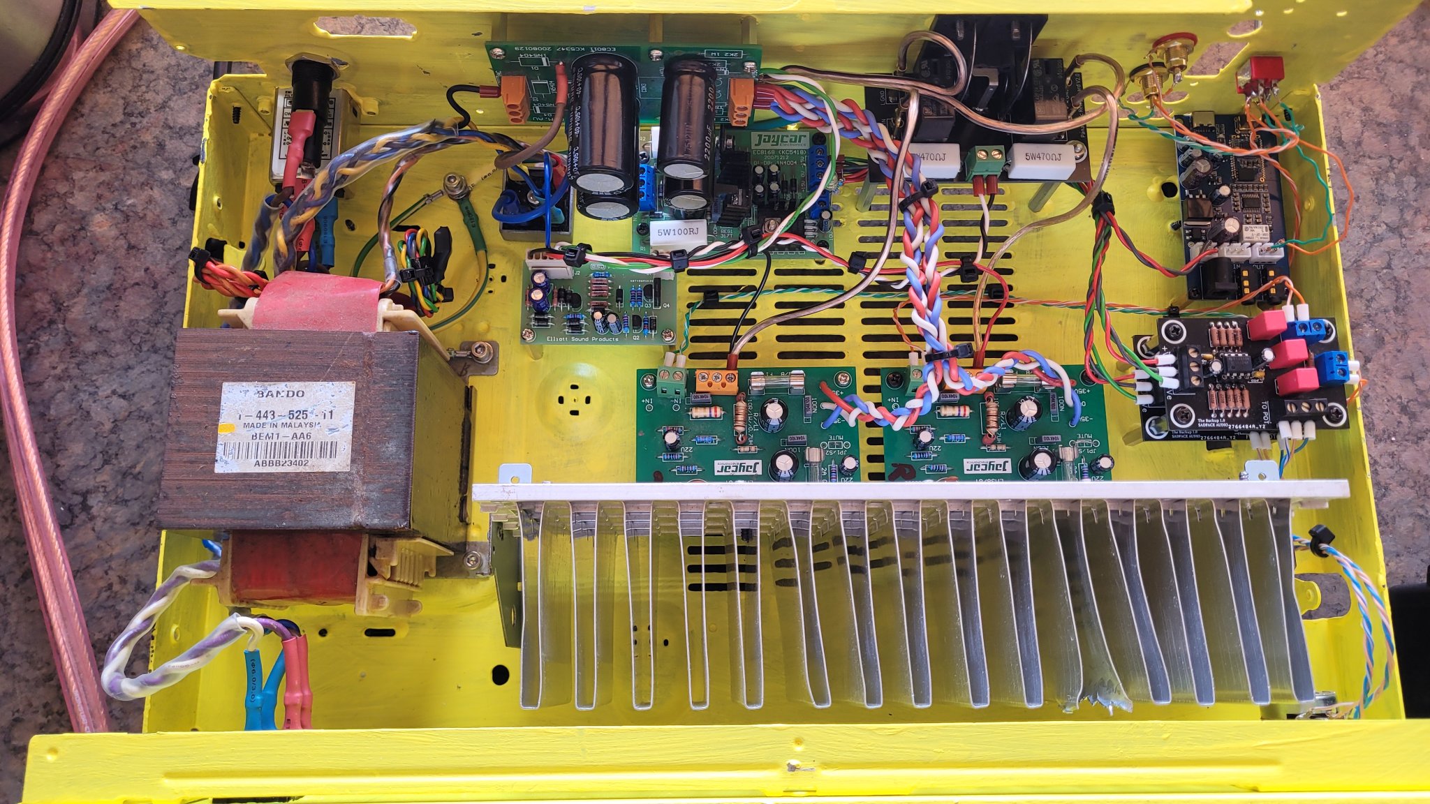

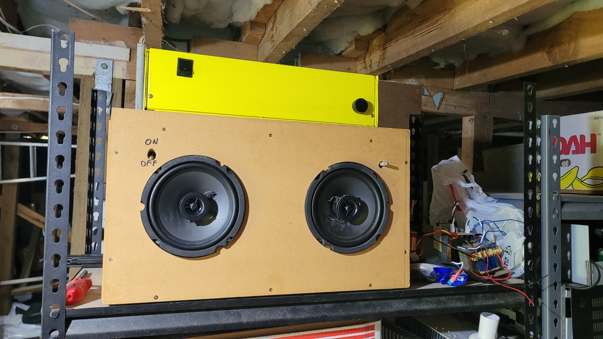

And this is an almost zero cost amplifier build for my basement. Deliberately ugly as sin for my amusment:
-Chassis from some broken old yamaha I got for free.
-Power transformer and heatsink from some broken AV receiver or another, virtually free.
-Electronics salvaged from some of my first projects getting into the hobby
-salvaged speaker jacks, relays etc.
Assuming everything else was past its service life and therefore free. The most expensive part was the Ali express bluetooth board.
Sweet basement listening while I make stuff:

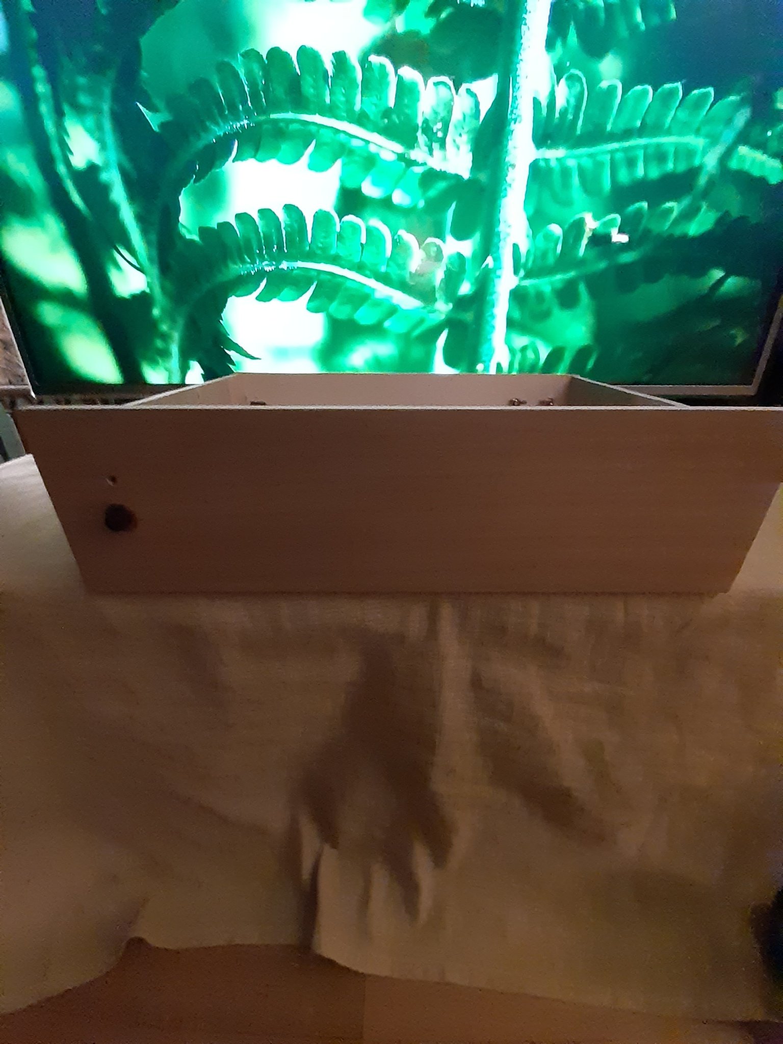

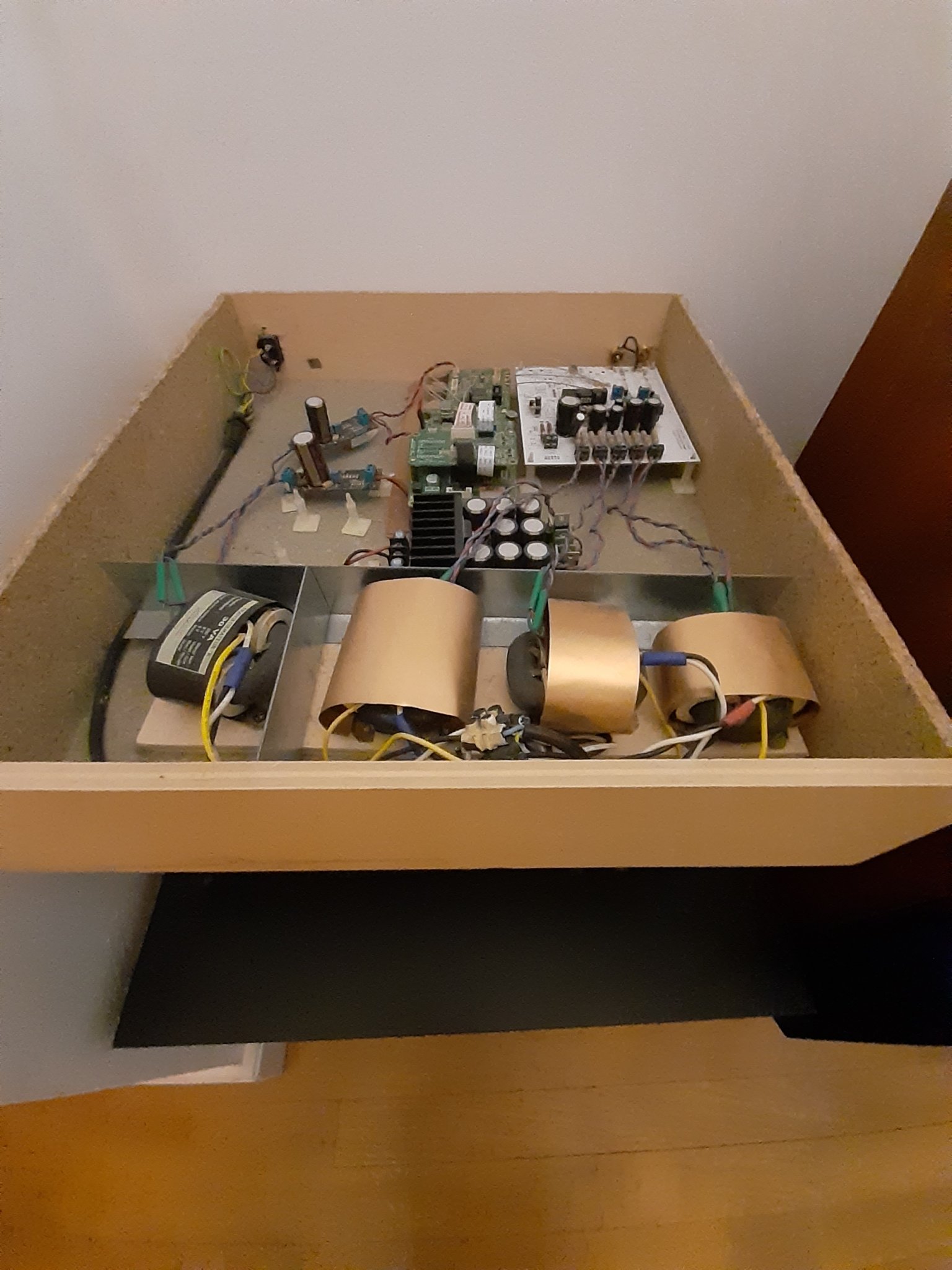

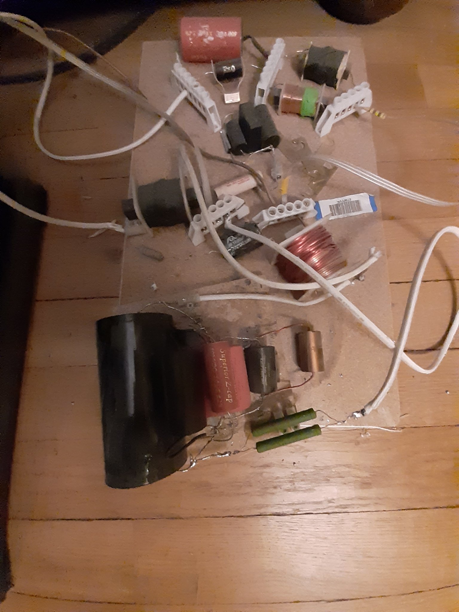

the loudspeaker tweaked filter needs a good casing....

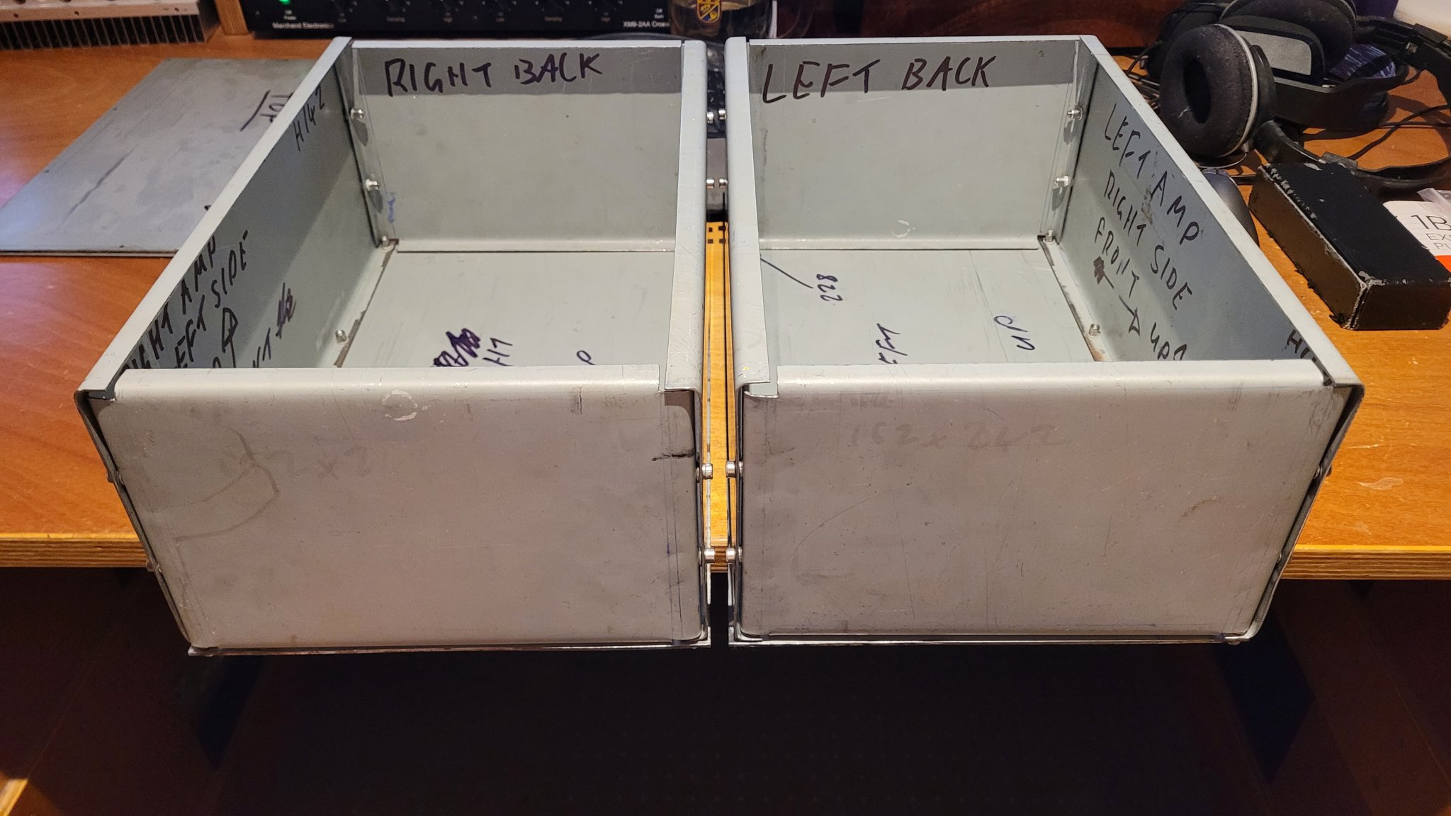

Off you go then!

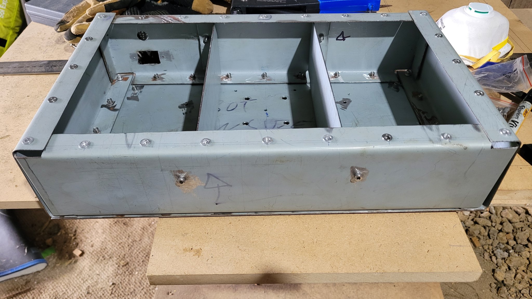

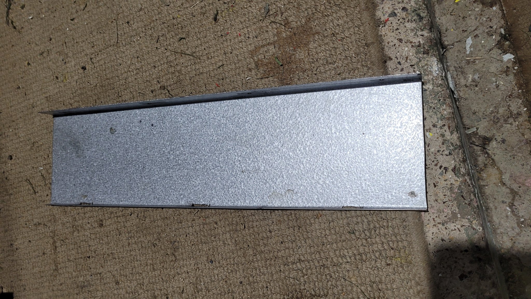

I've found aluminium up to about 18 gauge is easy to bend over the corner of a desk for right angle bends. It doesn't need a bender like 1.2mm steel does.
You might want a rivet nut gun for fasteners. Cut the sheet however you like. Jigsaw, angle grinder etc.
Old white ware can be a good source of sheet metal if you don't mind steel. Thinner steel can be done over a desk. <1mm.
Dish washers seem to have thicker steel around the back and sides. Washing machines seem to use pretty thin stuff.
The good thing about using folded edges is that the edges of the sheet don't need to be perfect as that is not what is seen.
Except the top and bottom of course. A bit more care is needed with those as those faces are seen.
I think flanges of about 15mm are probably ideal. I used 10mm on my last build which was too short. I used 25mm on the build before that which was annoyingly big.
Too big: 25mm got in the way of putting things into the chassis.
Also, way to many fasteners. It just makes it more difficult than it needs to be.
Too small: 10mm caused problems with hole accuracy around the bended edge
Make sure you account for the bend radius if you want specific dimensions. You could look this up. Or just do some tests folds with scrap to figure it out.
If you're not too concerned then simply make sure you are consistent.
Ali express is actually quite good for fasteners. I've been using a lot of Ali express stainless hex head bolts and rivet nuts recently. They don't seem to suffer from low quality and are much cheaper than what I can find on the ground in New Zealand. Presumably in EU too with its protectionist policies.

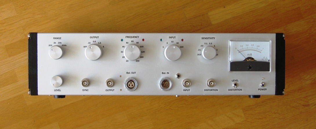

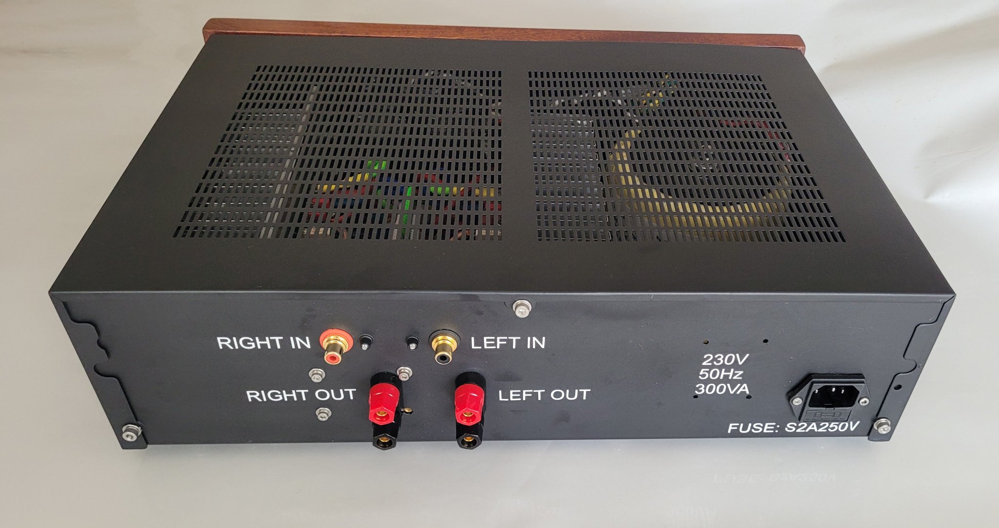

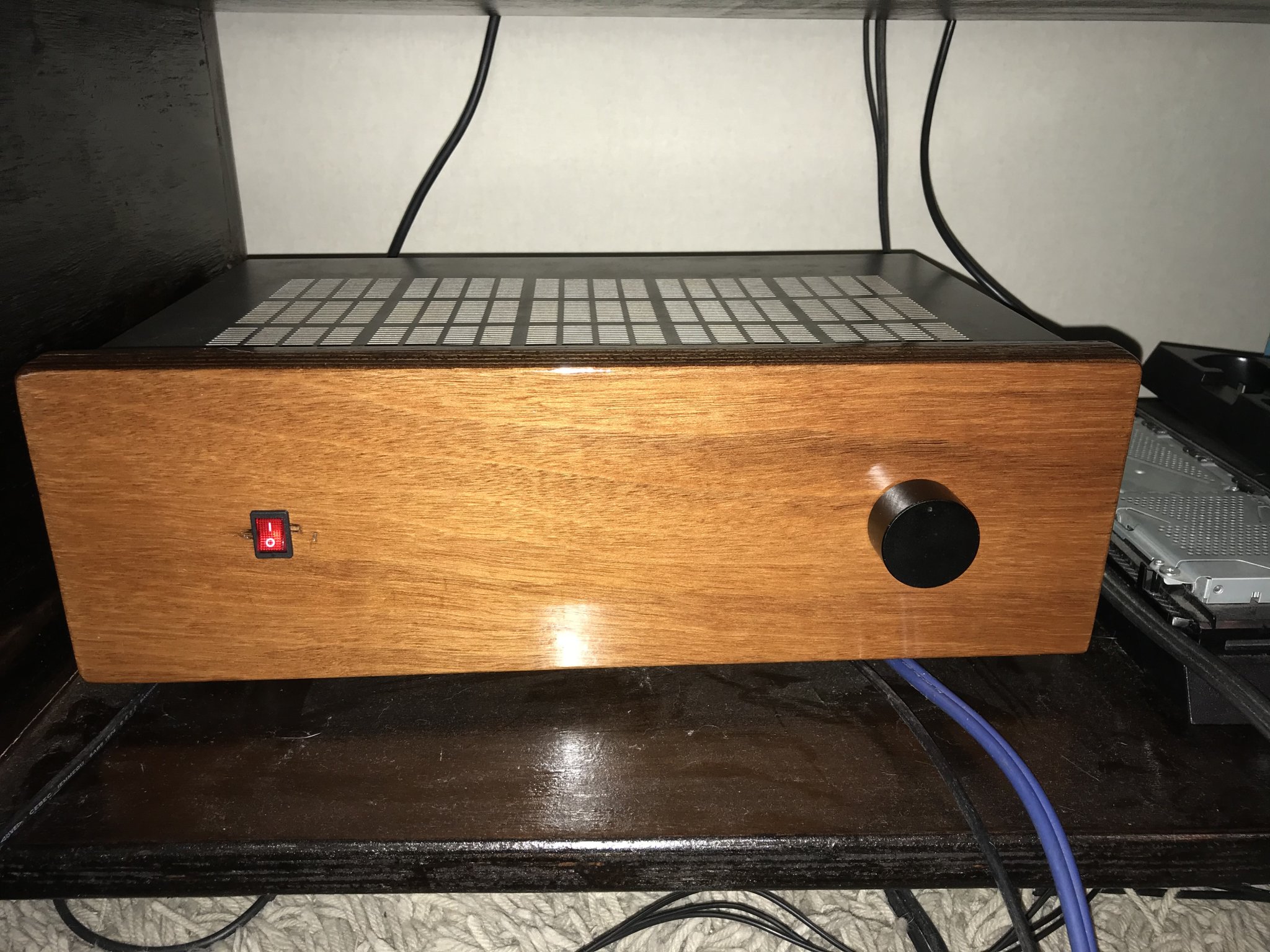

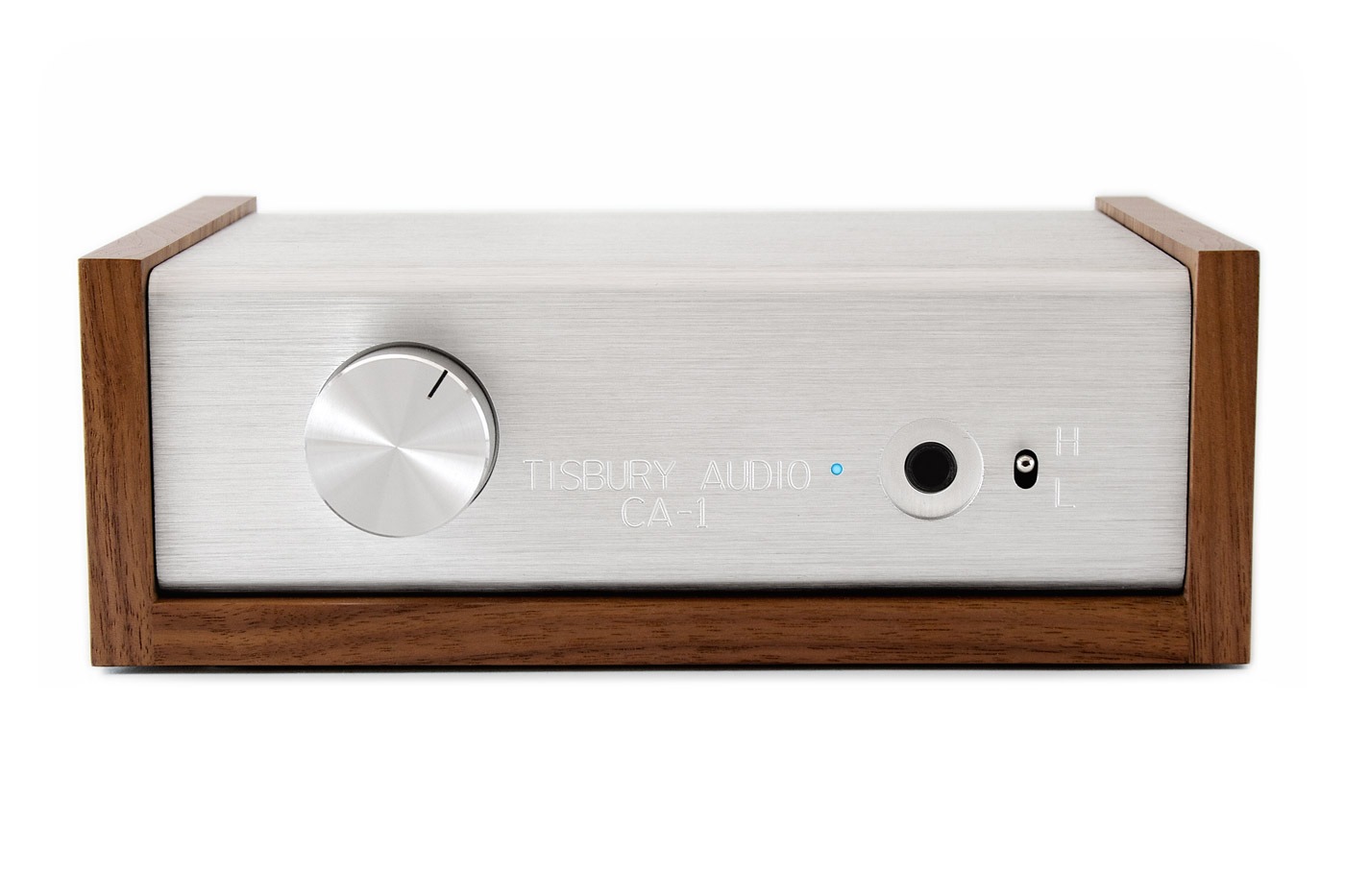

This was made from a scrap-yard aluminium installation trunking, 190x90mm cross section, already anodised.
Two end pieces in 16mm solid acacia offcuts.
So cost me nothing, just work.
https://www.diyaudio.com/community/...rdell-distortion-analyser.154260/post-1966575
You can get pre-anodised aluminium 2mm bent to any dimensions you want online in Germany.
2 pieces of 90° angle 330x240x90mm will cost ~40€ + postage.
Two pieces of wood, 4 rubber feet, and you can have a very decent DAC case.

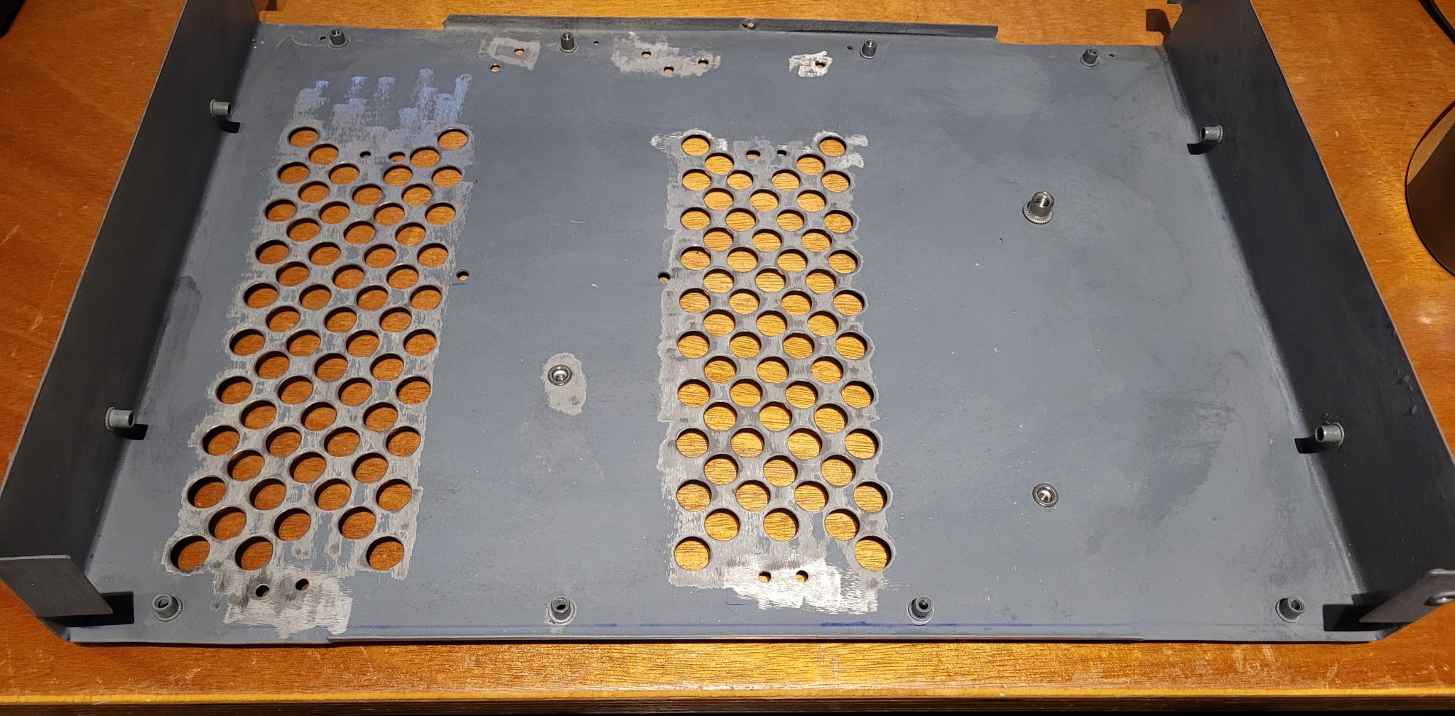

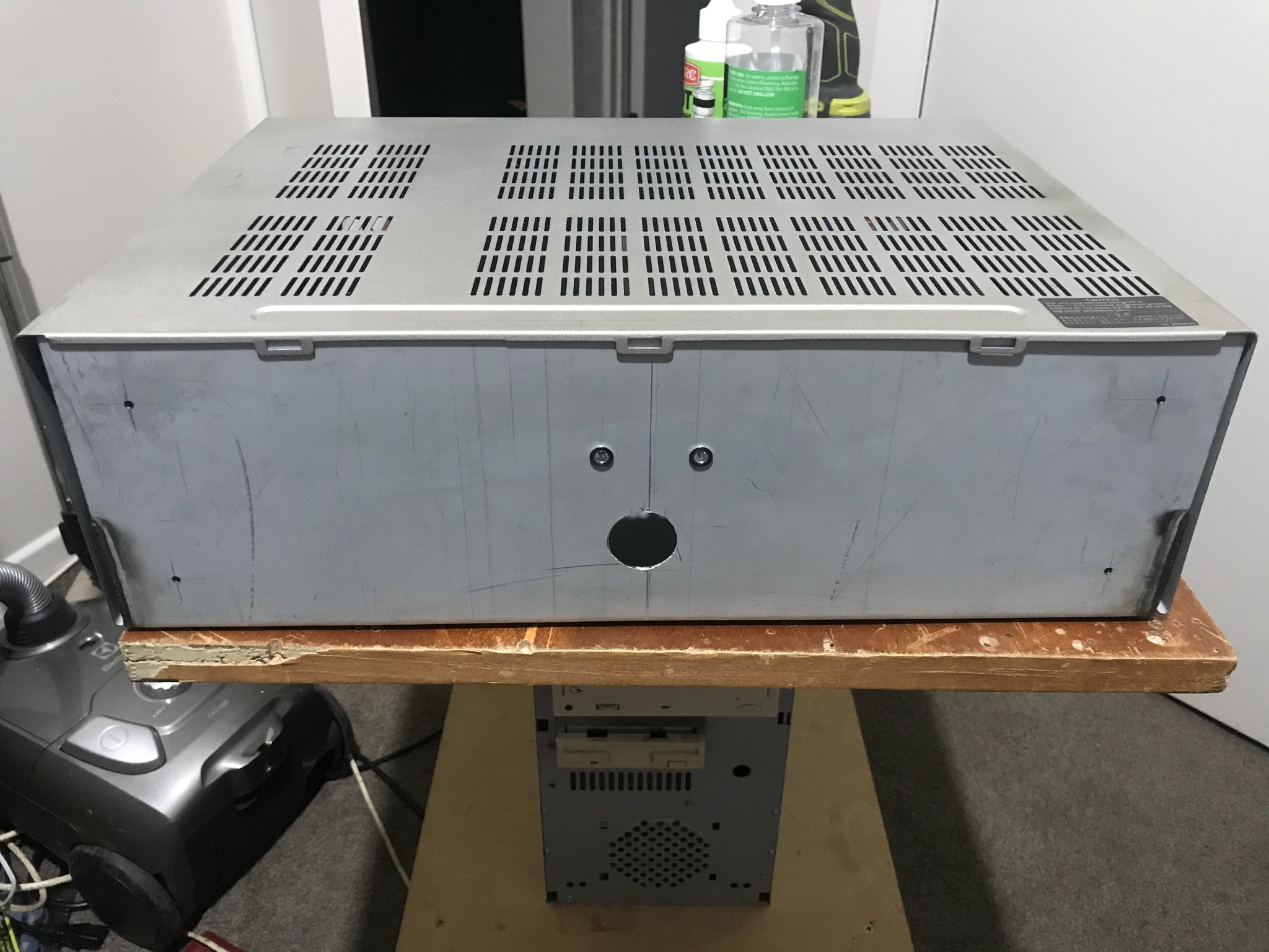

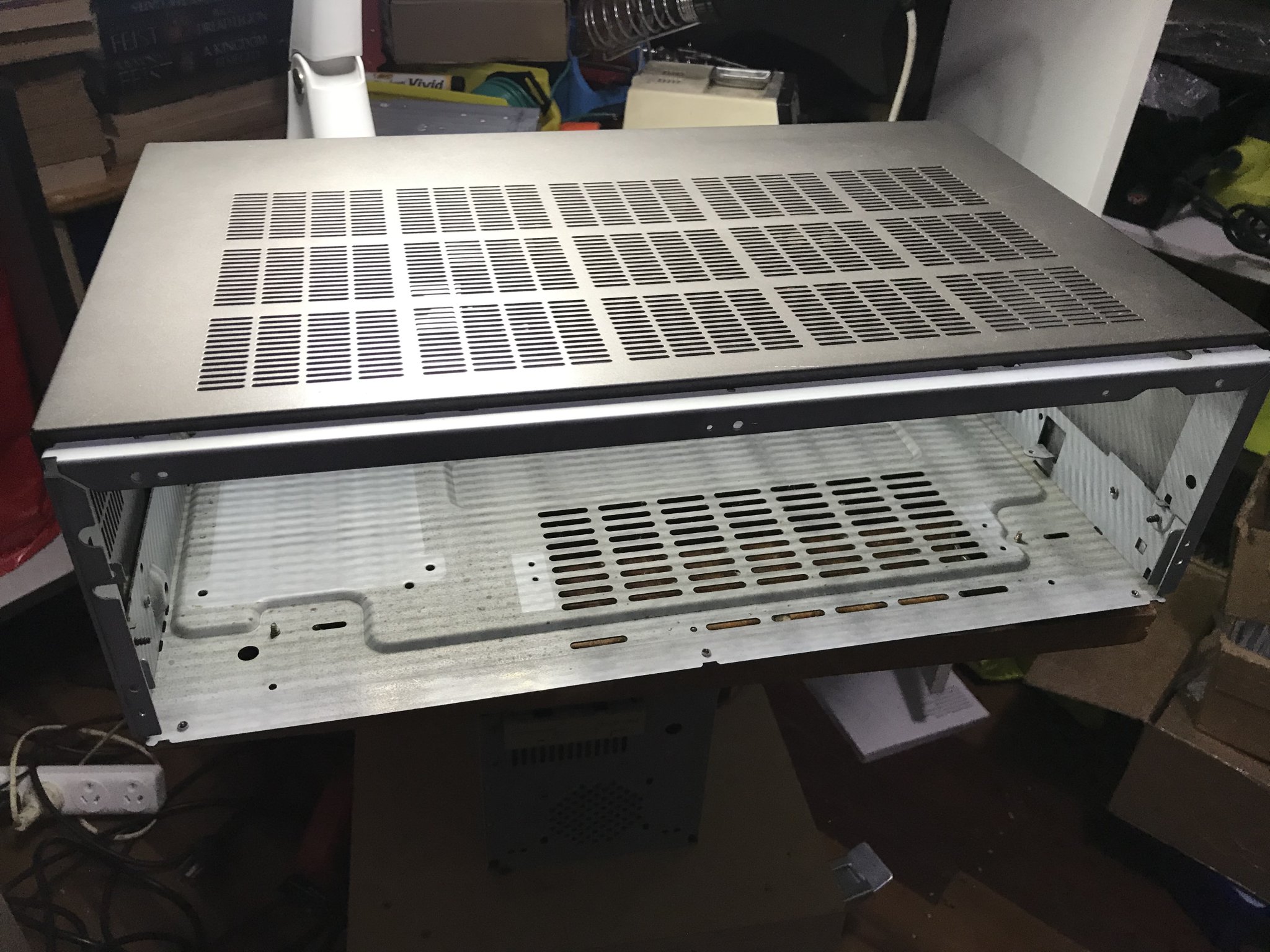

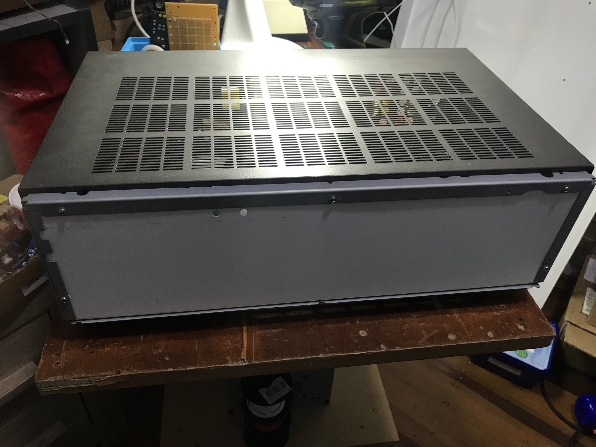

I think the cheapest way to go would be to buy a low-cost or faulty AV receiver and slap on a new front and back panel using some sheet aluminium. You may also be able to use some other bits in it, but I wouldn't count on it.
This is a good strategy.
However depending on the chassis, it can be a nightmare.
Most AV receivers have various stuff stamped into the bottom for mounting things. This can make it a real pain in the backside to work around.
I have abandoned more than 1 attempt at salvaging a case for this reason.
The other downside is that most don't have any metal behind the front which reduces the effective shielding.

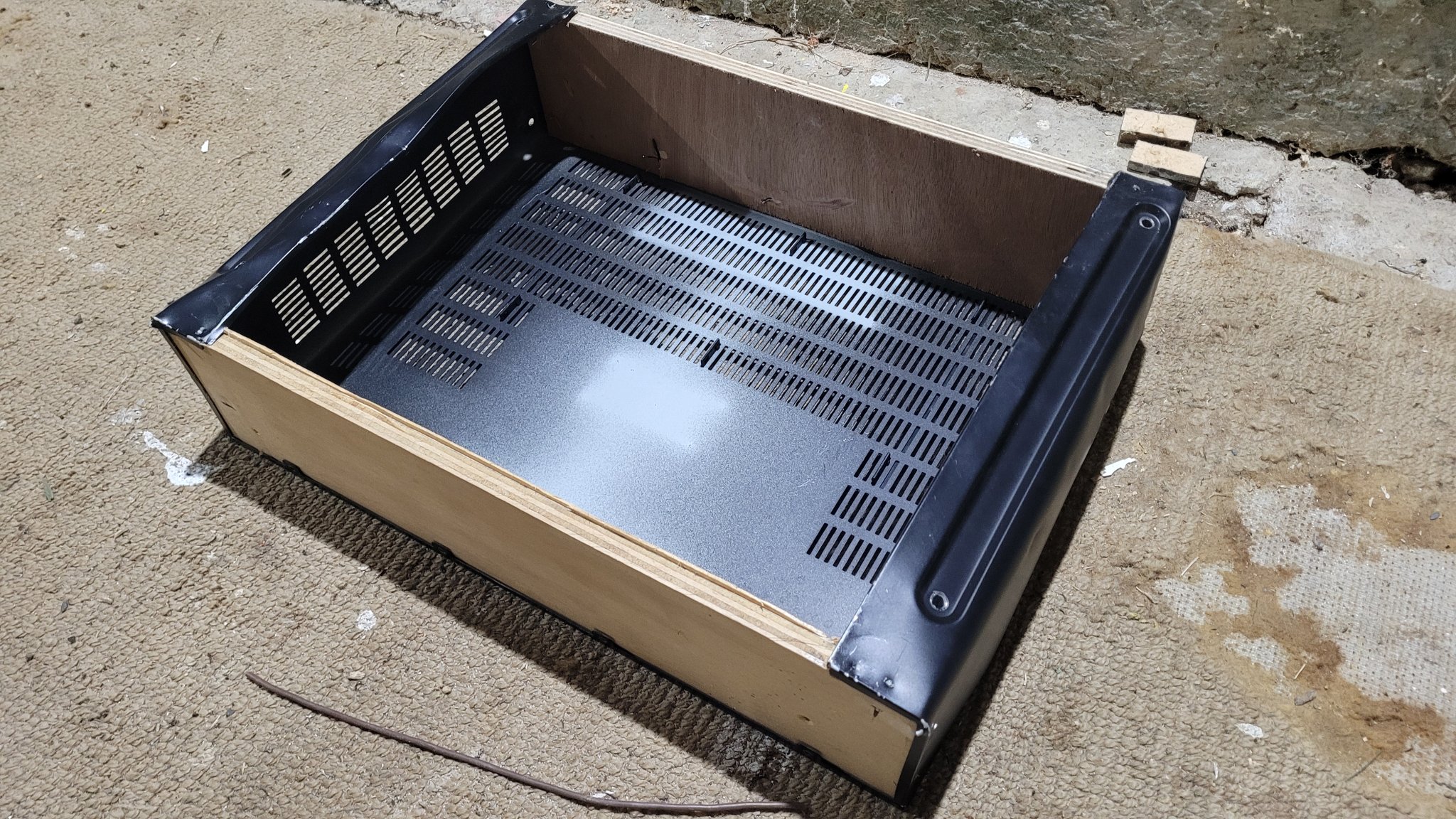

It can certainly be done however. This is one I did for a friend a few years back:
Notice the hole in the front
Filled with some scrap steel.

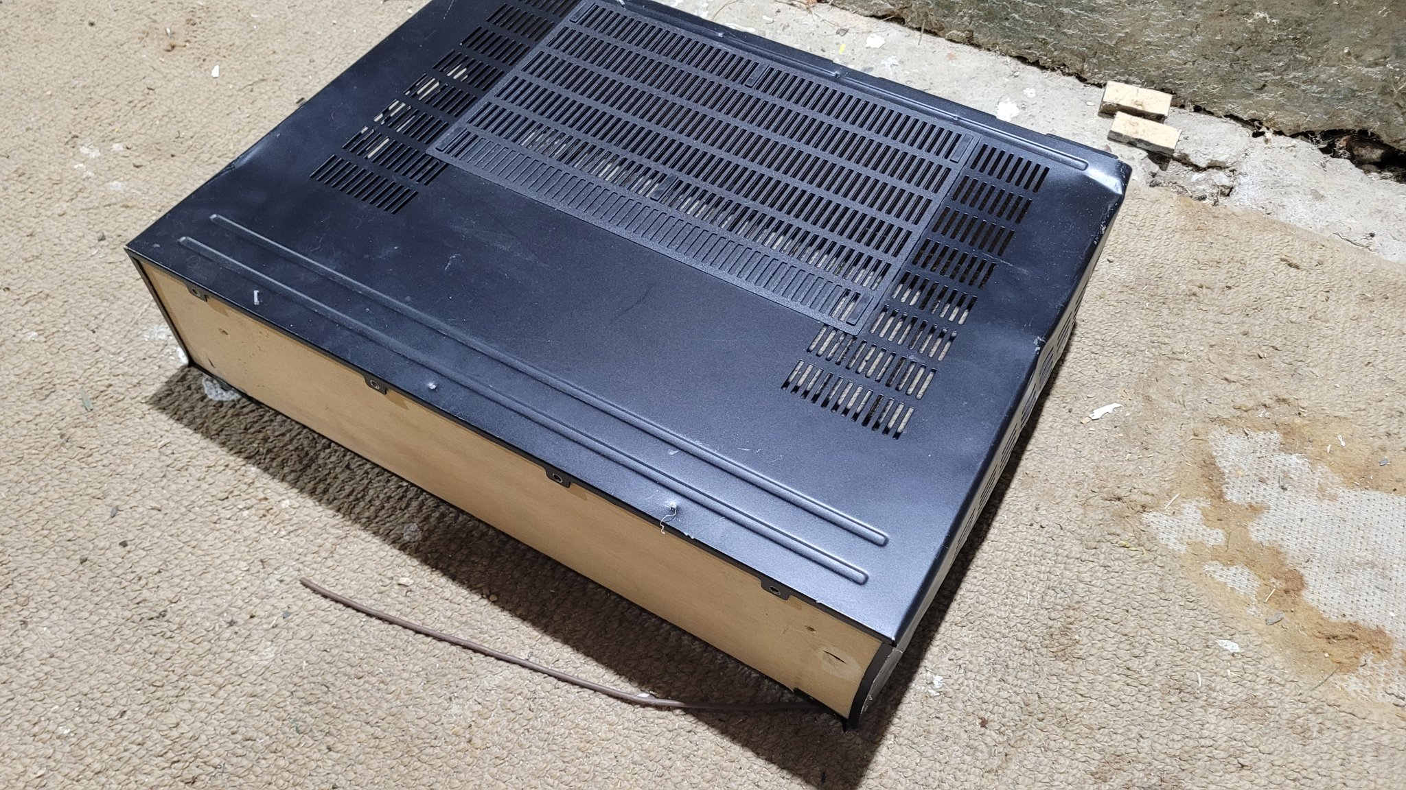

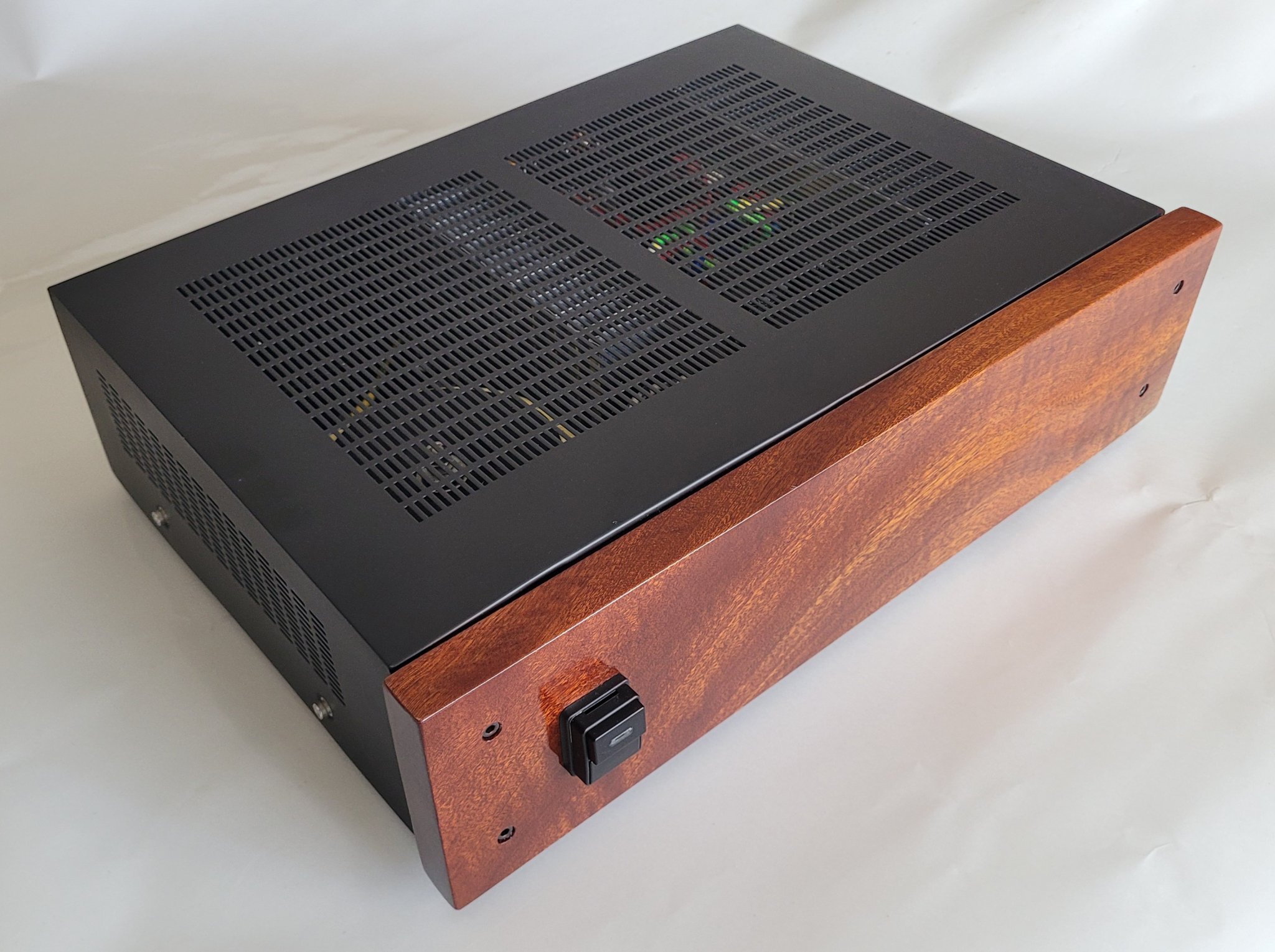

A good work around I have found was to select an AV receiver that you like the "grill" on. In other words the look of the vent holes in the top and either fabricate the rest around it so that you have fresh sheet metal.

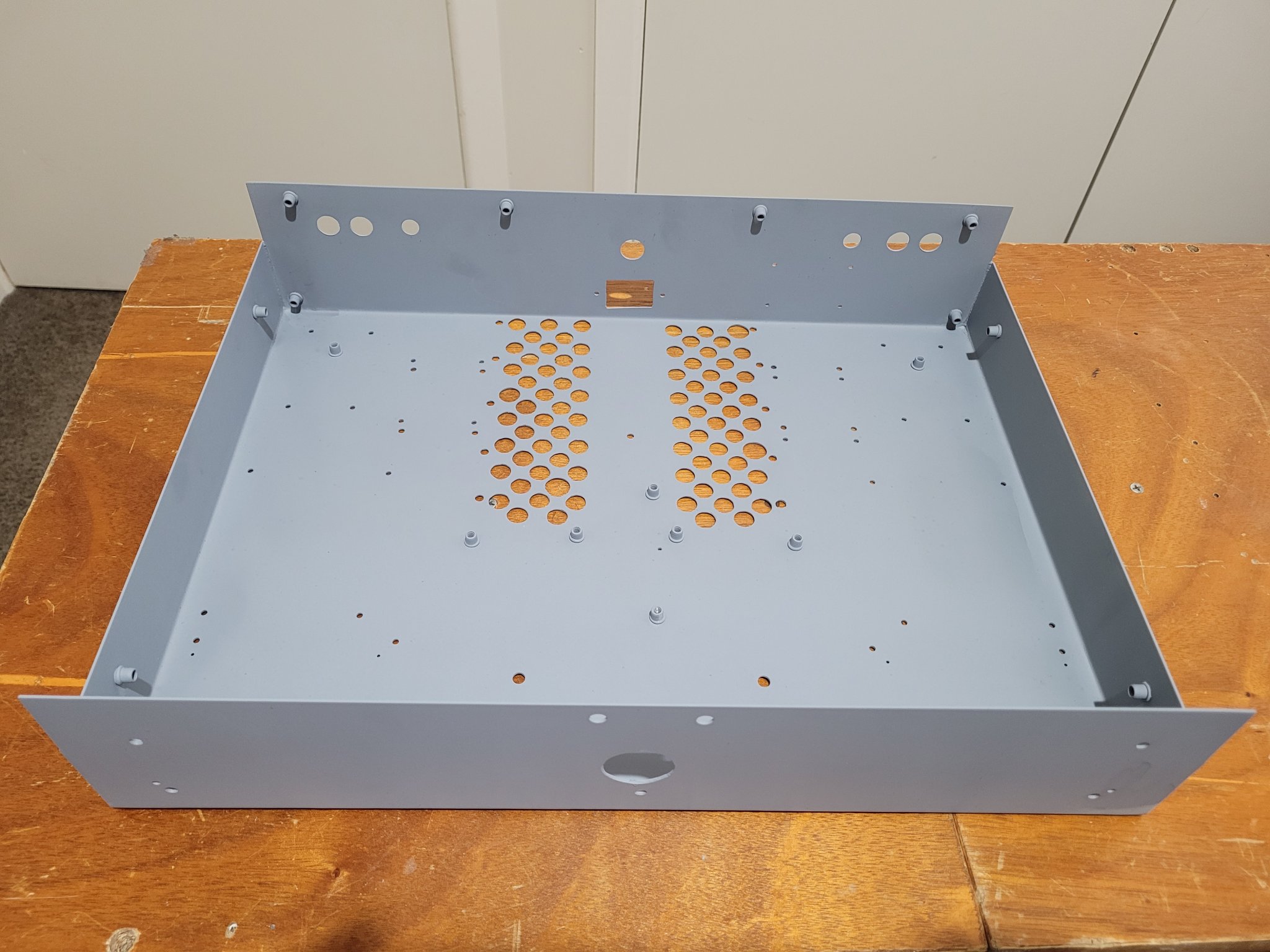

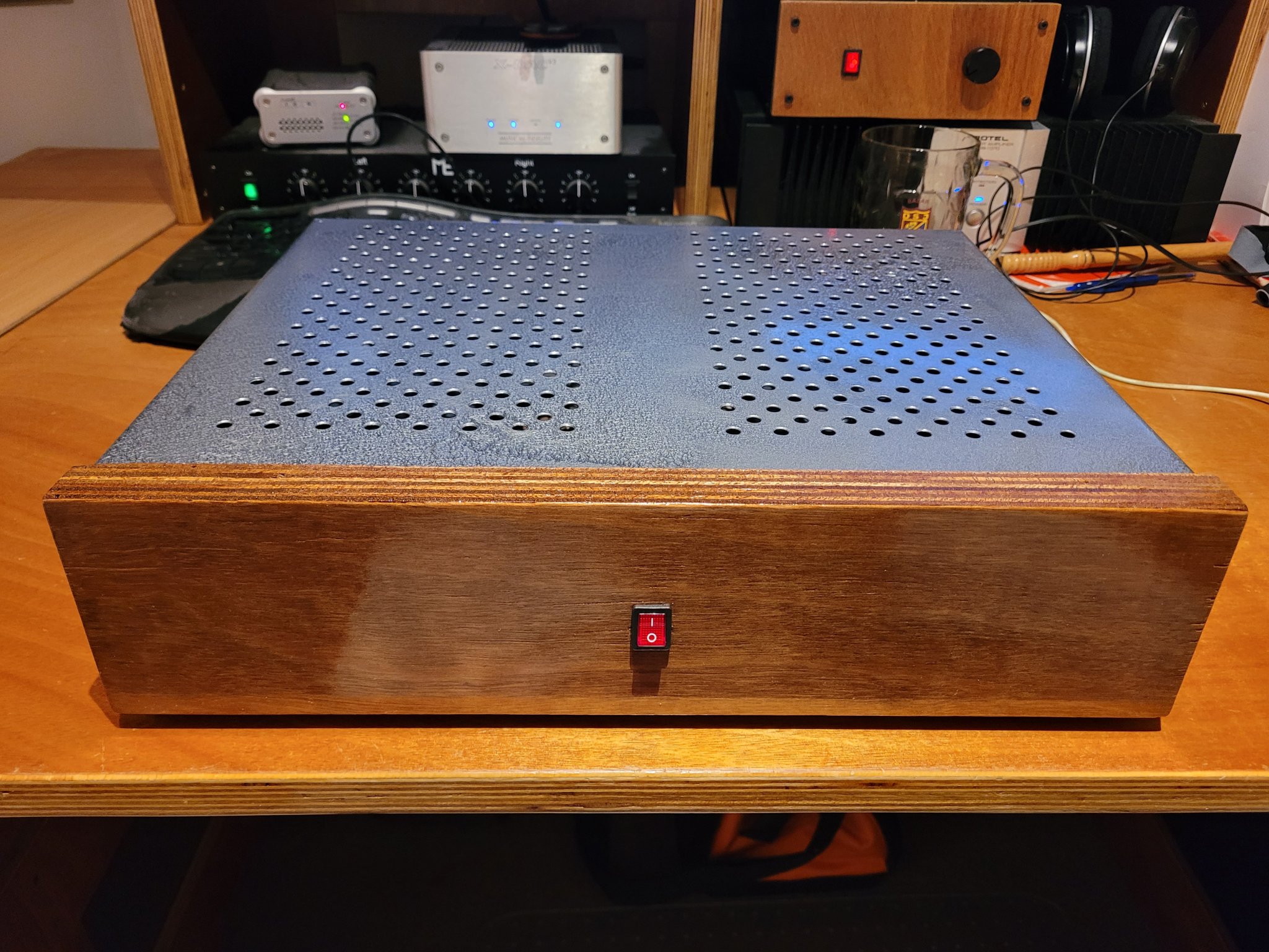

I did this recently with the lid from a Pioneer VSX-3300. I liked the top but threw out the rest and fabricated a new botton, front and back to use the nice top:
Base:
Front:
Finished:
The steel for this was donated by the 20 year old dishwasher that came with my house. The gosh darned thing decided to die on the day we bought my firstborn home.
Good steel though.....

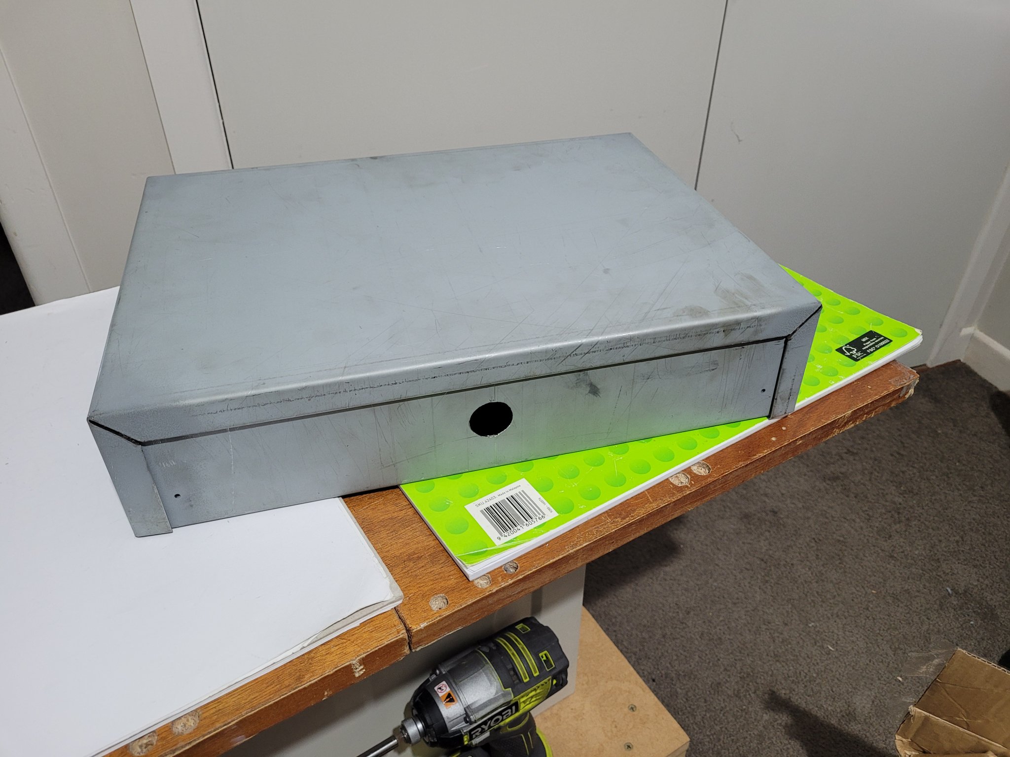

Or, get a local sheet metal shop to make a simple box to go underneath it. I did this the first time round when trying to salvage a lid. Cost me about USD60 to have it made by a local sheet metal guy out of 1.2mm electrogalv steel.
I then accidentally threw out the lid it was designed around in a scrap run. So I then had to get the guy to make me a lid to fit....
Much cheaper than getting something in from overseas and made to the right dimensions. Of course still a lot of work required to get to this:
It was this experiment that convinced me to invest in some tools and steel. I expect to make a few chassis' over the coming decade or two so the tools will pay themselves off pretty quickly. I think they already have.

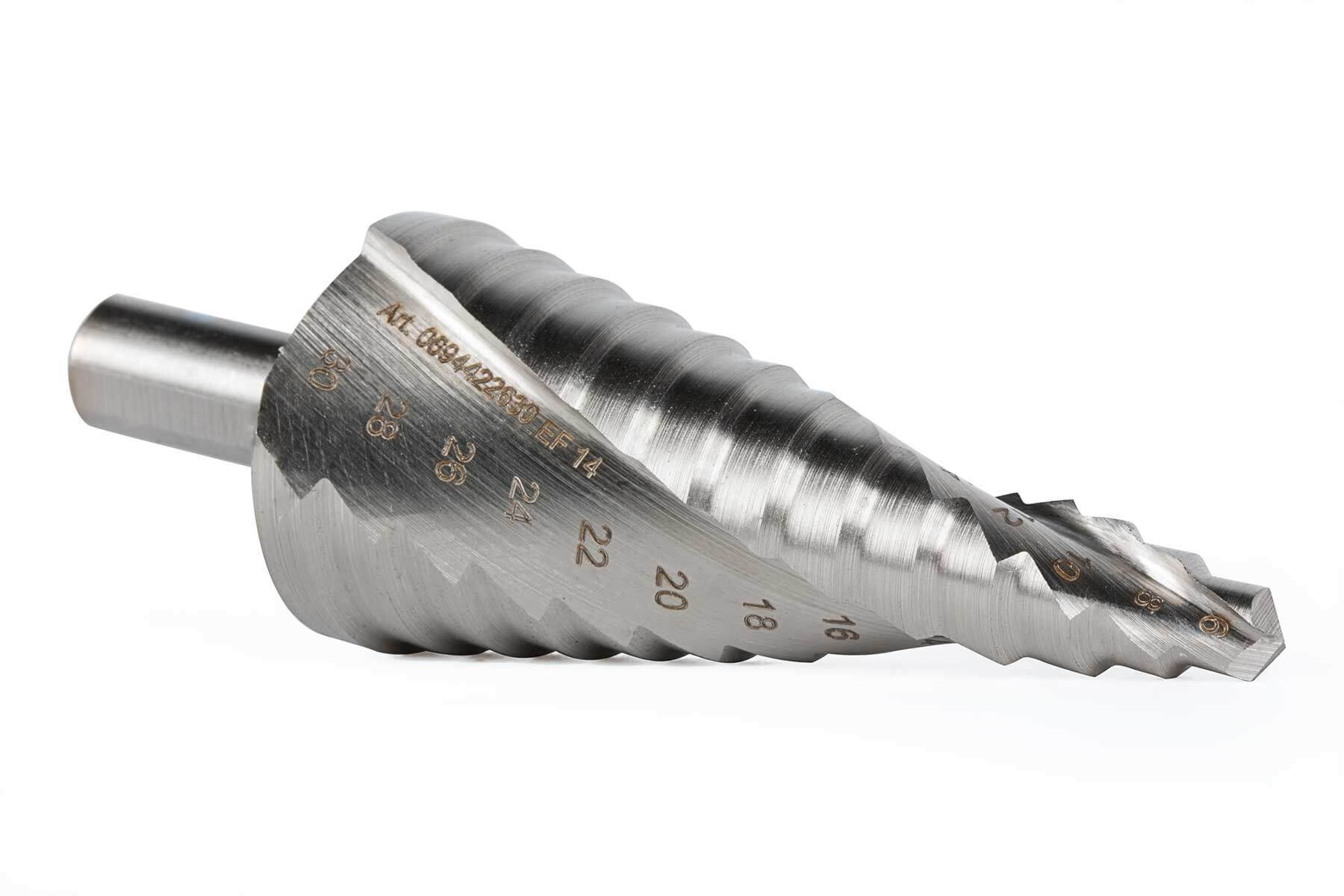

Pro tip: get a step drill bit.
Mine isn't the cheapest, but is far from the most expensive. At this stage it has done thousands of holes and still cuts through sheet nicely.
