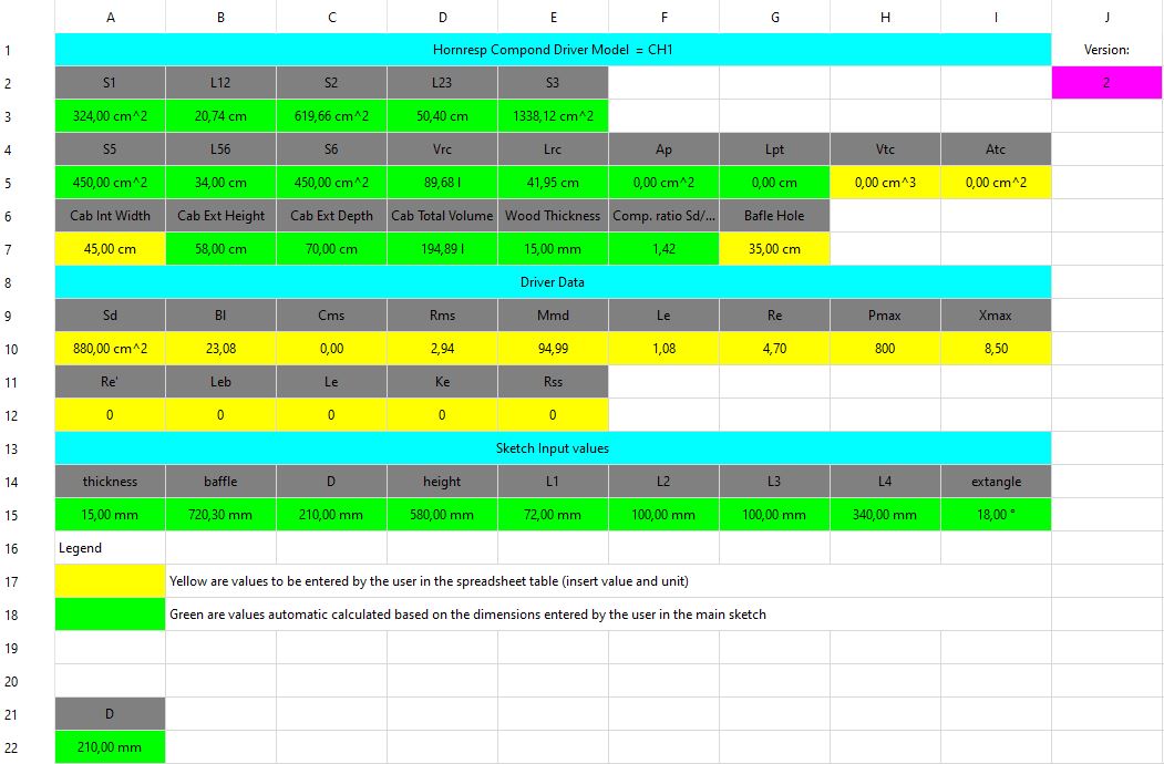

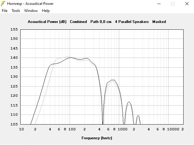

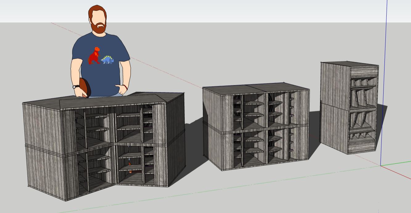

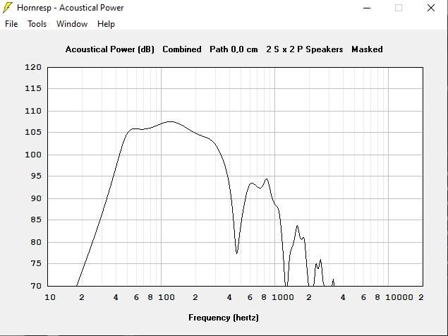

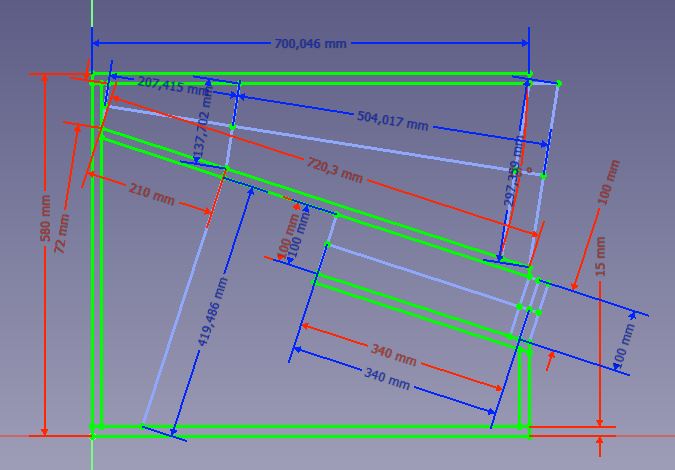

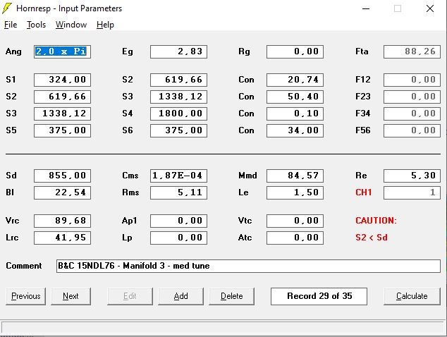

Hey guys, I have been messing with this manifold idea in hornresp and lordsansui's amazing CAD models and I like it a lot. It models really well and seems really easy to build.
I thought I would post what I want to build here, before getting the saw out.
I made it quite small, so I can fit a single on my cargo bike.
I chose B&C 15NDL76 driver, because it is not crazy expensive and very available in the EU. It also seems to model very nicely in this enclosure type.
I tuned it to work optimally in a stack of four.
I made the port straight, as I couldn't see the point in the flare, and a straight port makes construction easier.

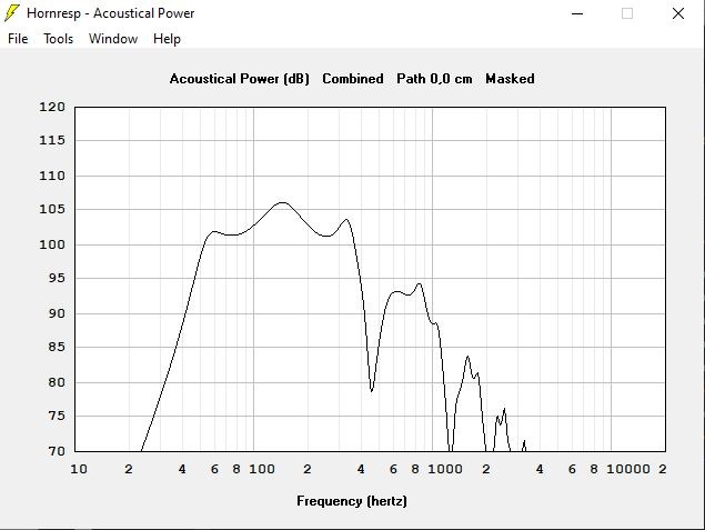

The thing that concerns me the most right now, is the 15ms delay difference between the kick and the sub frequencies. Does anyone know if this is audible? Will it make things sound out of time?

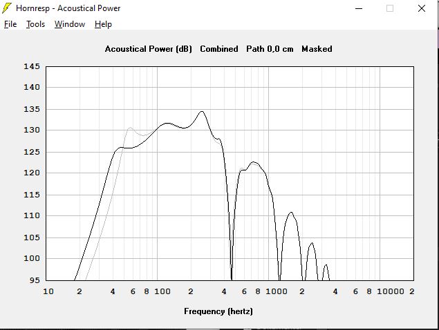

The attached SPL charts are at 2.83v half space. Single cab and four cabs stacked.
Any thoughts? 🙂
Thanks for all the inspiration and information - Nesral

I'm running the system on battery power, outdoors, for extended periods of time, so efficiency is of upmost concern. I would like a deeper F3, but that would mean either bigger box, or less efficiency. Unless you have some magic cards up your sleeve?
I was thinking to play around with different port lengths in the prototype, to slightly alter the tuning.
It will be playing mostly trance music, so maybe deep bass is less of a concern?

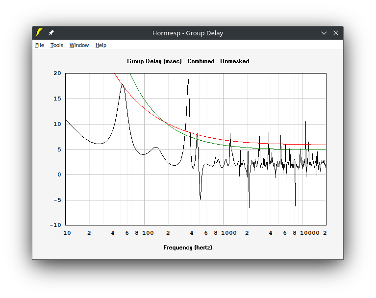

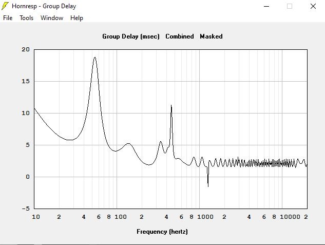

The group delay around Fb (frequency of box tuning) is typical of a bass reflex enclosure.
It won't sound "out of time".
The offset horn reduces the rear chamber volume available for the bass reflex enclosure.
Using that volume for bass reflex and lowering the Fb, the F3 could be lowered at a similar efficiency, but with less output above 100Hz.
Hello Nersal,
I'm happy the information are useful for you.

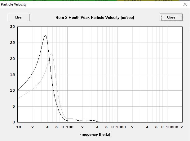

The port geometry other than tuning the frequency reinforcement you want can create problems such as noise. In general this happen at above specific SPL where the air moving inside the port starts to be turbulent, in English people refers to port chuffing. To mitigate that you can improve port geometry with rounded entry and rounded exit, Audiophiles do that with plastic accessories. For PA where in general the loundspeaker is fully made by wood, working with geometry is better.
There is a "new" compound model available on Hornresp called CH2, with this model you can model the port with 2 segments, allowing the entry and end to be big while the center can be narrow, like "venture effect", so keeping desired tuning frequency but improving air flow and reducing port noise. See Attachment #1
In general Hornresp emphasis the peaks and deeps for the simulation. From hornresp, go to group delay chart again and press "L" two times, hornresp will add some lines for you to better judge the group delay. See Attachment #2. If you plan to crossover between 300Hz and 400Hz it might be risky, In general for High Order loudspeaker people suggest to use 1 1/2 octaves of bandwidth.
If you tuned it to 51Hz, so, maybe it's safer to cross at 153Hz (51*2*1,5), maybe you can go until 200Hz depending from the slope you choose.
17ms delay at 51Hz isn't a problem and the auxiliary lines shows you.

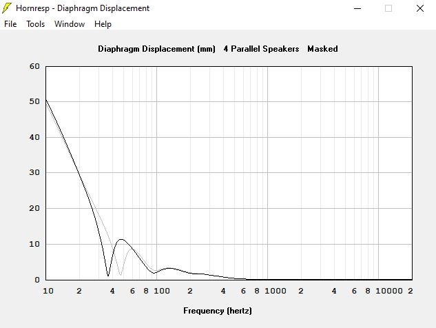

Your posts however inspired me to make an attempt at hitting 40hz, without compromising too much, so I optimised the box for v-plating 4 cabs, this allowed me to make the horn smaller and the rear chamber bigger, without loosing SPL, then I also made the port a little smaller and as long as possible. I have attached the results compared to the previous. Displacement becomes a bigger problem (xmax 8mm) and port velocity also gets pretty spicy. I worry that this will get me less thump, due to lower efficiency and over excursion, and at the same time burn more battery power. I would love to hear your thoughts 🙂
@LORDSANSUI Thanks for the very detailed reply. Much appreciated 🙂
I will start with a straight port, for ease of construction. If I experience problems with port noise in the prototype, I will consider a flare.
I'm glad to hear that delay isn't an issue. My mids play down to 100hz, but I would prefer to cross them much higher, to avoid excursion issues and let the bass bins take the kick duty.
Since you're chasing efficiency in a portable battery-powered rig for outdoor use, I'd be concerned about delivering the most above 60Hz.
Pursuing anything lower is wasting energy unless you can do it with impact... which will take a lot more than a single box on a bike!
Noone will miss that 10~20Hz when dancing on the street or in a park (and there's plenty of information in harmonics of basslines).
The nice peak at 100-150 in your previous design could be desirable too, giving some oomph to the kick and allowing you to cross higher too - so maybe revisit that. And give serious consideration to how often you could get four boxes together, since you might want to prioritise the single box deployment over designing around the four box stack.

You might think about using the offset horn as the port exit to bring it to adequate size (which would drop particle velocity way down) without reducing the chamber volume.

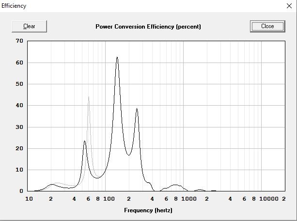

Hey Art, thanks for your wisdom 🙂 I think I understand what you mean. I made a quick comparison in hornresp between a high and low tuned port (see attached images). It seems the low tune is slightly more efficient from 45-55hz, but the high tune is much more efficient from 55-80hz. I guess we determine overall efficiency by area under the curve? In that case the high tune wins?
Hofmann's iron law: low, efficient, small, pick two.
Since you pick a small chamber, the lower tune only exceeds 10% efficiency from 50-60Hz, while the higher tune exceeds 10% efficiency 55-70Hz.

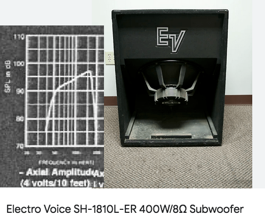

Similar to a Cubo, or the mid 1980s EV SH-1810L-ER, seems too much of the small box is given up to the offset horn, sacrificing low end for mid-bass efficiency.
You get to choose the efficiency ratio between the ranges.

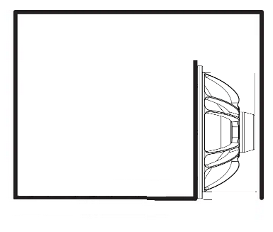

So basically a tapped horn with a rear chamber?
It may be modeled like that, though what I described is an offset horn sharing the bass reflex port, making the volume occupied by the driver available to the bass reflex chamber.
The driver volume reduces the port's center volume, creating a "venturi port" in the slot/offset horn.
