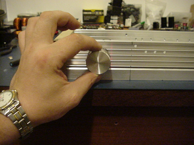

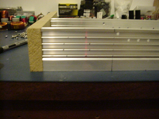

need some help here im working on a case and i need to remove
some fins from the heatzinc any idea what bit to use?
see pic
i just wana cut it down to the flat aluminum so i can add a pot
thanks..........

No, I don't think those would work unless you wanted to cut all the way through. But, as I understood it, you want to have the flat alu left. You could use that to cut a nice circle in the fins and then maybe use a dremel to cut away the fins inside the circle? I think you really need some kind of mill to do it right.
--Ferdi
I would probably go with a hole saw. You have to put some wooden inserts between fins, as otherwise they might get bended. Also, before saw hits the fins, a drill bit has to be inserted in a base for proper guiding (so the drill bit has to be long enough).
Then break off the fins with pliers and finish off the remaining pieces with a disk sander.
