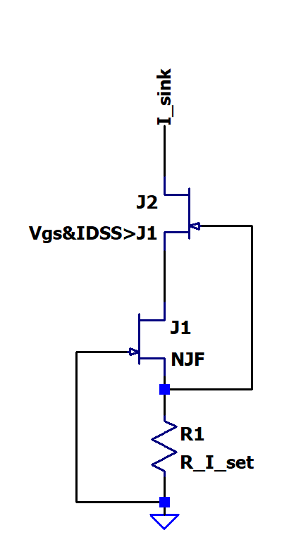

The cascode JFET/depl-MOSFET should have higher IDSS and Vgs than the bottom device. As long as the bottom device has enough Vds, it will sink your current. There should not be a limit to how low current can be, rather there is a limit to how high it can be because the Vgs decreases as Ids increases, eventually not giving enough Vds for the lower device. But for many JFETs at <1mA the Vds can be <1V.
Place the gate of cascode as shown, not to GND.

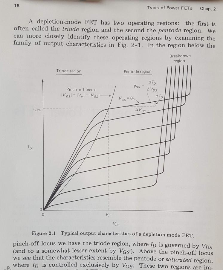

The upstairs FET is always in the pentode region, because the value of VDS is going to be above 20V in any reasonable application. Meanwhile the downstairs FET has to put up with a VDS of only the value of VGS of the upstairs FET.
Going back to the specification VGS(OFF): for DN2540 it is -1.5V to -3.5V. For the upstairs FET, in pentode region, this might mean a VGS of somewhere between about -1.3V and -3.2V for the upstairs FET, at a current of 3mA.

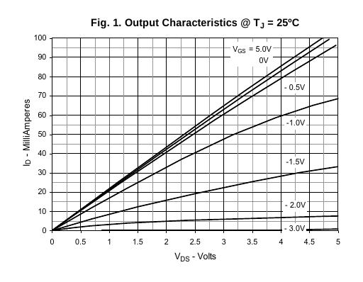

Sadly, the DN2540 data sheet curves are useless at low currents like these, so it is not obvious that the FET is in triode region at 3mA.
Instead, we can use the curves of a similarly-scaled FET to see the likely behaviour.
The IXTP10N100 is such a FET, and has just the kind of curves we need. And sure enough, it looks very triodey at VDS of 1.3-2.0V and 2-3mA.
The practical solution to the problem is simple enough: either select your DN2540s to have the upstairs part with high-magnitude VGS(OFF) compared to the downstairs; or use LND150 downstairs, as already suggested.

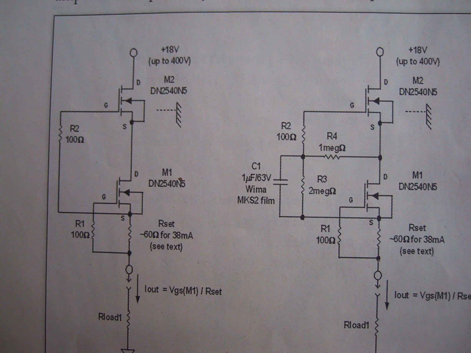

Do you think that that cascoded version using a pair of DN2540 would be a good choice for a current sink that will be used for ~75 volt drop at 6-10mA? I'm thinking of using that scheme for a tail under a 6N1P differential splitter, and already have a bunch of DN2540, but no other suitable depletion mode devices.
It should be workable, but may be worth making a quick rig that tests the value of VGS at the desired current. It's easy to do that by making up the Downstairs part of the circuit, and providing a 3-pin socket for the upstairs FET.
Plug the batch of FETs in the upstairs socket, one-by one; the best for upstairs duty will show the greatest magnitude of VGS of the upstairs position ( =downstairs VDS ) during the test. Those should give the least trouble from operating the downstairs FET in the triode region.
FETs are much more variable, sample-to-sample, than bipolar transistors, don't be surprised if some are very different to others in VGS.
Alternatively, you can use Walt's circuit, that John posted. That should solve the problem nicely, at the cost of the 1µF cap, and the two resistors.
I think I'll use Walts circuit from above, I have the extra parts on hand, and I need to build up a protoboard for the circuit anyway 🙂
Does the lower device need a heatsink for that version? I have a few TO92 DN2540 on hand, and was going to use them there if they don't need a heatsink. Otherwise I'll just do TO220 all around.
