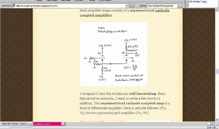

Here the asymmetrical cathode coupled is explained:
http://coupling-triode.blogspot.com/
hope it helps...

Had to do "your" circuit in spice and we are right in the middle.
If we do according to Schmitt and use anoderesistors on both stages we loose ca 6dB. But in this circuit the loss is 3dB compared to a standard triode gain stage.
Think I also saw this circuit in Bruce Bs "Audio Reality" where it is called "Grounded Grid Cascode Phono Preamp.

Hello Lars,
yes, I know a lot of people who saw this circuit ... 🙄
of course in a symmetrical cathode coupled amp you loose 6dB.
But this is an asymmetrical one!
A grounded chathode stage and a grounded grid stage have the same
voltage gain number. The gain in the asymmetrical cathode coupled
stage is reduced by the cathode follower at the input.
Let us calculate the gain of the follower:
R load 8KΩll 22KΩ = 5900Ω, R follower 1/mutal cond. = 400Ω
5900Ω / (5900Ω+400Ω ) = 0,94 [gain reduce caused by load]
µ=100 1-1/100 = 0,99 [open output gain]
0,99 x 0,94 = 0,93 [this is the voltage gain of the cathode follower]
0,93 = -0,63dB
Thus the circuit loss is 0,63dB compared to a standard triode gain stage.
Where did you get 3dB from? 😕

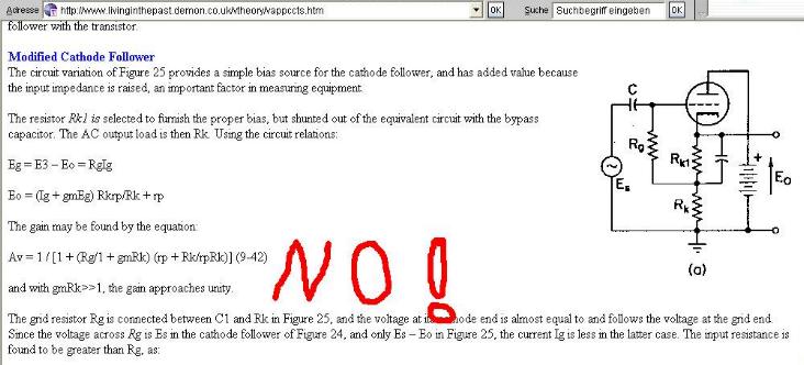

A grounded cathode stage and a grounded grid stage have the same voltage gain number
Sorry that is incorrect, the gain in a grounded grid amplifier is dependant on the source impedance of the preceding stage as the input impedance of a grounded grid amplifier is not infinite as it is in an ordinary cathode grounded stage. The gain of a grounded grid stage is:
gm*RL/1+RL/Rp+Zs(1/Rp+gm)
which can be compared to the gain in an ordinary cathode grounded stage which is gm*Rp*RL/RL+Rp.
As the grounded grid stage is driven by a cathode follower which has a non zero impedance the gain of the grounded grid stage will be less than what it would have been if it had been an ordinary cathode grounded stage,
The gain for "your" Asymmetrical cathode coupled amp is given in "Electrical engineers handbook" by Pender & McIlwain published 1936!
as gm^2*RL(RL+Rp)*[1+(Rp/Rk)+Rp*gm]/[2*(1+Rp*gm)+[RL+Rp)/Rk]+RL*[(1/Rp)+gm]]^2
I hope I copied that correctly!
You can't say that the gain of this stage is 3dB or some other fixed amount lower than an ordinary cathode grounded stage but it is for sure that the gain will be lower, due to the gain loss in the cathode follower and the loss due to non zero drive impedance to the grounded grid stage.
You can find analysis of most and every tubes stage someone ever thought about, you just need to know where to look!
Regards Hans

gain calculation explained
Voltage gain calculation of the asymmetrical cathode follower
in three steps:
1. gain of the cathode follower:
Input resistance of the grounded grid stage is 8KΩ. This resistance is
parallel to R4 =22KΩ.
R load 8KΩ ll 22KΩ = 5900Ω
The output resistance of the follower is 1/mutal cond. = 400Ω
This value comes from the data book ECC83 2mA.
The output resistance of the follower and the load resistance are dividing
the no load output voltage of the cathode follower:
The no load output voltage of the cathode follower is reduced by the amount
of signal voltage between grid and anode divided by µ. See triode transformer
mode. This is calculated by 1-1/µ [ECC83 µ=100]
The no load gain multiplied by the gain reduce caused by the load gives the
gain of the cathode follower stage:
0,93
2.gain of the grounded grid stage:
The mutal conductance s is 0,5mA/V. This value comes from the data book.
The anode load resistance is 800KΩ it comes from the resistor multiplier
triode V3 of the SRPP arrangement. The no load resistance Ri at the anode is:
Ri = µ/s = µ x 2KΩ = 200KΩ . Both in parallel:
Ri ll Ra = 200KΩ ll 800KΩ = 160KΩ
The voltage gain is (Ri ll Ra) x s = 160KΩ x 0,5mA/V = 80
3.To get the total gain of the asymmetrical cathode follower the gain of the
cathode follower and the gain of the grounded grid must be multiplied:
vu = 0,93 x 80 = 74
[this is the voltage gain of the asymmetrical cathode follower amplifier]
74 = 37dB
Kind regards,
Darius 🙂

"Oldeurope" in answer to your post 30.
You still don't get it, the gain of a cathode coupled stage and a grounded grid stage is not the same as I explained in my post, this is well known and if you don't understand this you can look it up in any professional book about tube amplifiers. Please find out what the input impedance is for a grounded cathode and a grounded grid stage is and then you can start to understand how this affects the stage gain.
The book I refered to that was written in 1936 describe exactly the same circuit as you describe and give values for gain either for each part or for both tubes, (here they assume that both tubes are equal but the formula can easily be modified for a case with different tubes).
It is difficult to understand your comment
If you believe that you have invented a new circuit I must tell you that you are wrong, this circuit is very old and has been described in several classic tube books, do you just ignore all knowledge that is available from these classic works?
BTW your equation for gain of a cathode follower is also wrong, (hint, yours is too simplified).
Regards Hans
as the book I refer to describe exactly your circuit.As posted in #24 these books will definitely not help you understanding.

More about the grounded cathode - grounded grid amplifier.
See here http://www.livinginthepast.demon.co.uk/vtheory/vappccts.htm down on the page "cathode coupled circuit" here a simplified formula for the gain is given and a statement which is of interest:
"The cathode-coupled amplifier behaves like a grounded-cathode stage having a valve of amplification factor m and an anode resistance greater than twice rp of one of the triodes" Meaning that the gain with any given load is lower than for the ordinary grounded cathode stage.
Regards Hans
Regards Hans

Hello Lars,
this is done by calculating the cathode follower, see [gain reduce caused by load].
BTW: source impedance cathode follower is <400Ω
grounded grid input impedance is >8KΩ
Please note: If you take a pentode, Transistor, Cascode ...
the input impedance is only the mutal conductance of the
element. (Here 2KΩ ). In this case the loss caused by the current feedback formed by
the source impedance of the CF and the load of the second stage, means the loss
of the cathode follower caused by output voltage dividing, would be unacceptable.
This is why I wrote in post #24 that this is a special triode topology.
I need no cathode decoupling cap (LED etc.) and don't have its influence in sound.🙂
thanks and
kind regards,
Darius
Oldeurope I must say that your way of argumentation is odd to say the least. I think the least you can do is to read what other people write, I wrote:
Regards Hans
Which you chose to ignore and copy what is written on the same page about "Modified cathode follower". If you scroll down a few lines on the same page you find Composite amplifiers which describe "cathode coupled circuit" and the cascode. You must be the only one who didn't found this on the page.See here http://www.livinginthepast.demon.co...ry/vappccts.htm down on the page "cathode coupled circuit"
Regards Hans
#38 I am sorry but...
Good evening Hans,
at first you have to learn how to calculate a cathode follower.
I explained it several times in this thread and in the blog but
you ignore it. 😡 Should I ignore your posts ? 😕
D.
tubetvr said:Oldeurope I must say that your way of argumentation is odd to say the least. I think the least you can do is to read what other people write, I wrote:
Regards Hans
