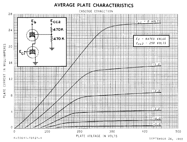

Sheldon said:
Are there any examples of cascode curves published?
Yup, some datasheets for tubes designed to be run that way actually have curves. Look at 6BK7 and 6BQ7, for example...

Sehr interresant!
Below 150V the plate curves are triode like, above that, pentode like. Well Darius, maybe we can eat our cake and have it too.
Sheldon
edit: I see that you were busy posting before I responded to Pete's neat little graph. Nice site Darius. I'll have to stare at it a while before I comprehend some fraction of it. For sure, corrected some assumptions I held and learned some new stuff today about cascodes.
#7 #8
Originally # 7 posted by Sheldon
Sehr interresant!
Below 150V the plate curves are triode like, above that, pentode like. ...
Hello Sheldon,
interesting discussion, thanks.
Pelase note that the anode of the cascode can not provide
any anode current at voltages below the cathode voltage
of the upper section. In Pentode curves the g2 voltage is fixt,
in this graph it comes from a high R voltage divider.
The curves below say 150V are mainly given by these resistors.
Thus there is nothing triode like in this cascode arrangement.
#8 Thank you very much, Pete.
Kind regards,
Darius 🙂
Re: #7 #8
oldeurope said:
Hello Sheldon,
Darius 🙂
I think I understand what you are saying. But let me make sure. The region below about 150V definitely looks triode like (the influence of plate voltage on current). The upper grid is set at 125V according to the figure. Are you saying that the high value resistors are functioning as a type of grid leak biasing, and that is causing the effect of plate voltage on current? Does it follow that in this region this configuration is not actually behaving as a cascode?
Sheldon
Re: #10
oldeurope said:
think about how the curves would look like with a
stabilized 125VDC supply at the grid of the upper triode.😉
I wasn't trying to be clever Darius, it was an honest question. I'm nowhere near your level on this stuff, but I like to learn. I think your answer is yes then? If so, then a lower impedance supply for the grid would shift the curves to look more like a typical pentode?
Sheldon
