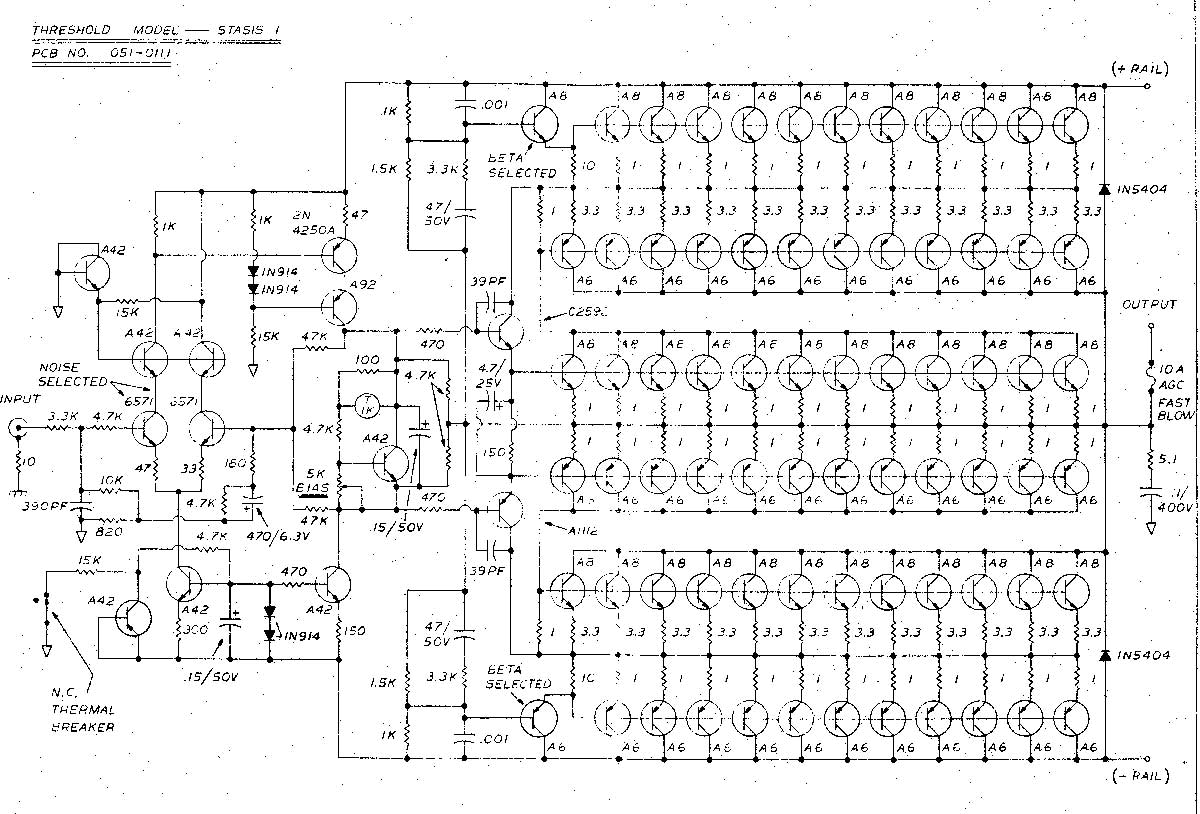

cascode output amp
Zener diode won't do it. The idea is to reduce Voltage across the lower device as it reaches max current to equalize power dissipation relative to the case where current tends towards zero at max Voltage. The lower device runs at nearly a constant temperature. Important when you have to make big square waves with flat tops and bottoms, typically with no feedback !
Just a guess, but I think R13 equalizes power dissipation through the signal range and C11 holds the Voltage constant above the frequency where thermal distortion is most troublesome. This paper was written in 1969 before Tek really hit their stride with the 7000 series. The 7000 series were state of the art lab scopes discontinued in the 80's.
I have to agree with you there. The idea is to limit Voltage across the output devices to stay out of the Second Breakdown zone. One of Nelson's patents shows a triple stack.
The Tektronix circuit is class A so It doesn't need a resistor for regulating thermal regime , just a zenner is enough there.Basically all the circuits are explained there in detail, the same with that RC network.
