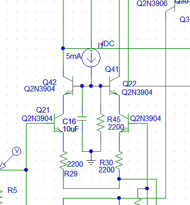

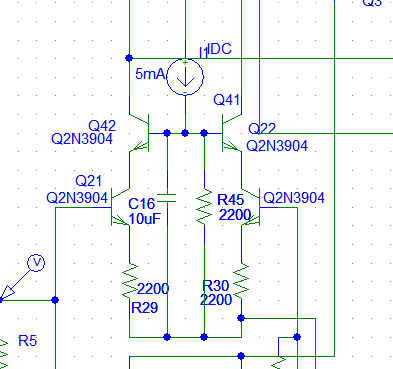

Hi, is there a the difference between this cascodes input stage?

Yes, the leftmost schematic holds the cascode at a fixed voltage above GROUND, while the rightmost holds the cascode at a fixed voltage above SIGNAL.
The first runs into overload at very high inputs, and varies the Vce of the input devices. The second has much higher overload, and holds constant Vce on the input devices, eliminating Early effect.
The second is preferable, in my opinion.
Hugh
Yes the second, its constant Vce for input transistors increasing its linearity (more precise). Choosing input transistors with constant Vbe at specific current region (look at its Ic-Vbe graph) will result a highest linearity.

Now, wich is the Vce "optimus" voltage?
Supose that I use Vcc=25V and Vee=-25. A low Vce value (4,7V) is more desirable that a higher value (12V)?. Or it does not matter? reffering on the input stage.
you require good performance from the input device.
You look at the options and decide which compromises introduce less distortions/heating/capacitance/unwanted effects.
This may be operating at Vce=2V or at Vce=125V or anywhere in between.
Some designers/builders ear tune to a sweet spot.
I have not heard this so cannot comment on the reliability of finding an accurate sweet spot.
AKSA and Ostripper and others have ear tuned and reported impressive results.
Many very good commercial equipment manufacturers ear tune for popular sound output.

Hi, Hugh
I'm a little bit confused here.
Assuming that "the first" is the left schematic and "the second" is the right schematic, I'm failing to see how in the second one the Vce of the transistors is held constant - since the reference is the signal - and the signal is not constant. Maybe I'm missing something...
Please shed some light over it.
Tibi

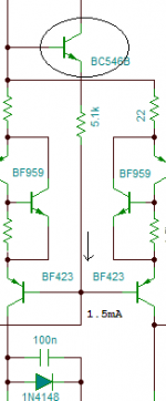

Hi, Havenwood,
Place extra transistor at their emitter connection to draw less current from it. I like to use around 7V or 8V Vce.
