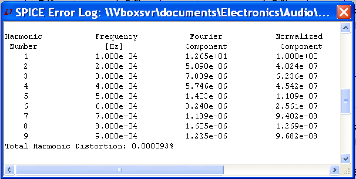

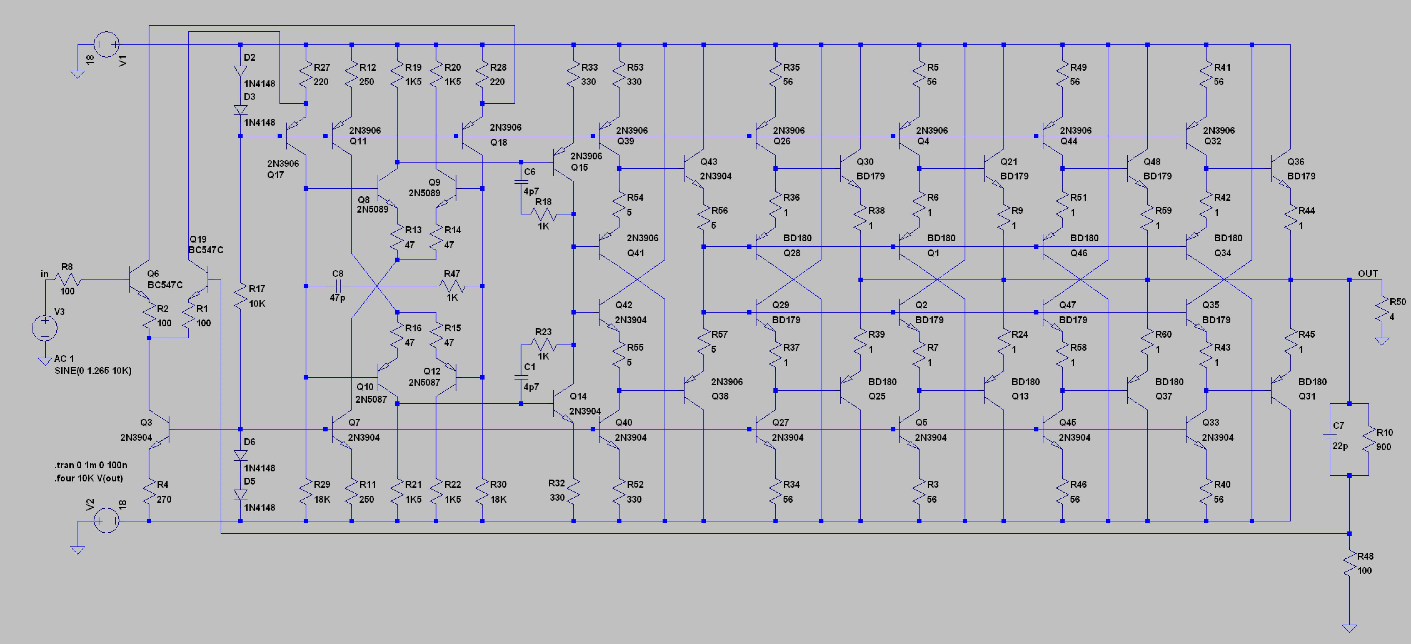

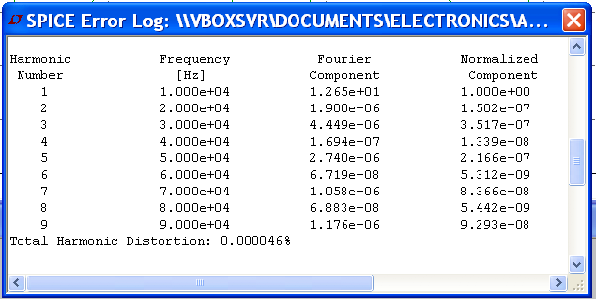

Swapping from TIP41/42 to BD179/180, driving 4 Ohms (2 x TC9 speakers in parallel), and consolidating most of the low-power transistors to 2N3904/3906.
Still managing <1ppm THD at 10KHz, 20W.
I calculate cost to be ~$12 per amp for components, not including PCB, power supply, etc.
I tried a symmetrical-differential input stage, and while it improved THD a little, the output offset blew out from <3mV to >30mV, so I wouldn't really be able to do that without a large (expensive) DC blocking cap in the feedback network.
Impressive. Looking at the highly symmetric circuit pleases the eye.
In order to turn it into a more versatile amp (power is enough, if really high quality), one would need something like output coil and estimation of stability. Just to directly connect to some driver, this probably is not necessary.
And how about PSRR? With a comparably cheap supply this becomes an issue. Is it possible to decouple the input stage rails somehow? Or is it not necessary?

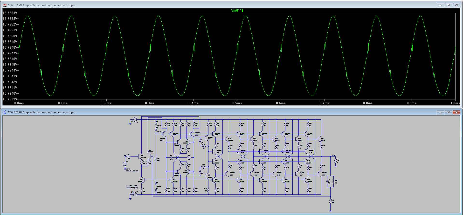

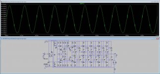

I'm getting these glitches in the waveform up to the driver stages.
Where do they come from and how can they be corrected?
If you plot them along with output voltage you'll see they're right at the zero crossing - where the output drivers are turning on and off. Wind down the input voltage to the point where Iout<Ib (ie class A) and you'll see they disappear. A much better picture of output stage charging is seen by looking at the current through R56 & R57 - full stick the second-last stage is (briefly) pushing 30mA into the bases of the output stage transistors to correct the error.
The "glitches" are important - they're how the output stage is linearised. You certainly wouldn't want to get rid of them, as that'd destroy the linearity of the amplifier.
I'm very much of a beginner on these "glitches" thing in LTS. Forgive my ignorance.
Can you elaborate a bit more on what they are, why they are important?
How do I plot that you explain?
Hi suzyj,
do you already have practical experience with such a circuit? From books and other threads here, one learns that conventional tripple output configurations are notoriously unstable. Apparently, nobody can really show the conditions for that in simulation, although it should be possible. One also can sim a Colpitts oscillator.
So, you operate 4 common-collector operated devices directly in series. Does this work reliably?
(Again, if the load is a single inductive driver with short connections, there might be no problem.)

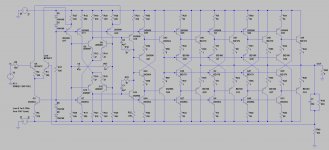

No, I haven't built one (yet).
Each of the output stages is a standard diamond buffer - so the load on the second-to-last stage (also a diamond buffer) is essentially eight emitter followers.
There's not really any extra stages beyond the normal diffamp-diffamp-VAS-follower-follower topology that's very much tried and true. Really the only difference is the use of diamond buffers as followers rather than the more conventional single transistors. It's wasteful of transistors, sure, but these are 20c parts. Oh, and I've chucked in a folded cascode between the first two stages, but that's not at all controversial.
The amp is ridiculous complex for such low output power capability.
And it will not work as shown - it is oscillating even in simulation.
Why not use a LM3886 or similar. It is cheaper and more adequate for
building your first amp.

All of this is nothing more than a simulation artifact.
All transistors with same name are perfectly matched, wether their model is close or not to reality, they are identical in all their characteristics.
All transistor junctions are at a constant temperature whatever their power dissipation and cooling.
Do not forget a simulator is no more than a calculator; Garbage in garbage out.
Simulation is not design, it is one of the tools in the design process, it is not a test equipment giving measurement results.
At that stage, check with realities.
There is too much of that on DIYaudio with LTspice.
