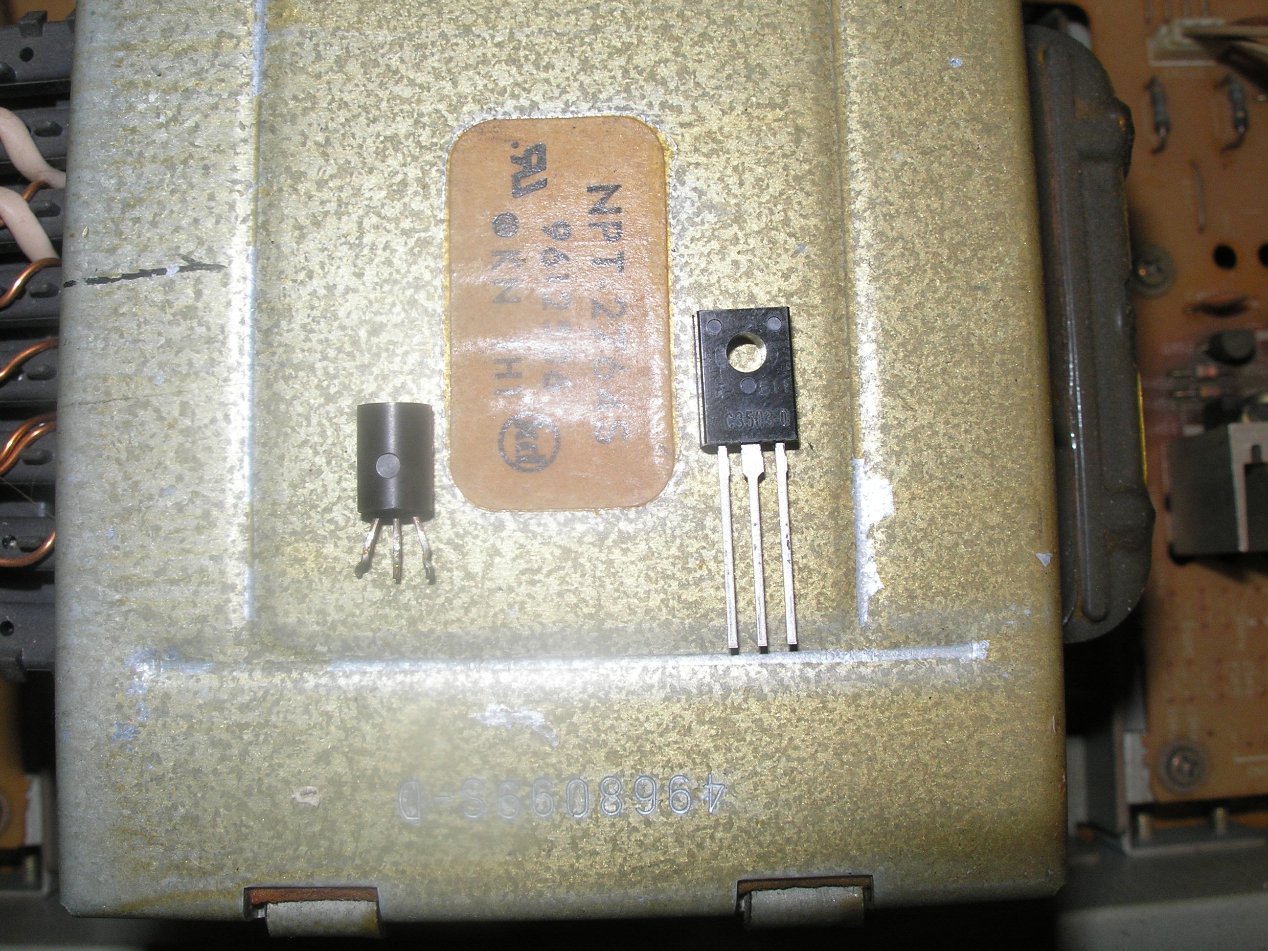

I replaced the transistors and resistors to the service bulletins specifications except I used 1381/3503 instead of 1370/3467, now I am not getting any signal through either channels. The only thing I can think of is I put them in backwards. I went buy the datasheets to make sure I put them in correctly.
I attached a photo of the old 3467 next to new 3503. With the flat side if 3467 touching the transformer the emitter is on the left? For the 3503 the three indents/circles facing up the emitter is on the left?

If you rotate the Sanyo picture around so the leads are down and the flat side facing you it will be ECB. You are not the first or last to be confused. Almost always the TO-126 package will ECB, can't recall it not ECB. The TO-92s are the ones to be careful with as far as pin outs go.
Craig
Check them with your DMM to see if they're hosed or not.
I bought extras and had enough to just replace them all even though they tested fine with my meter I don't feel like messing with it. Everything up and running now.

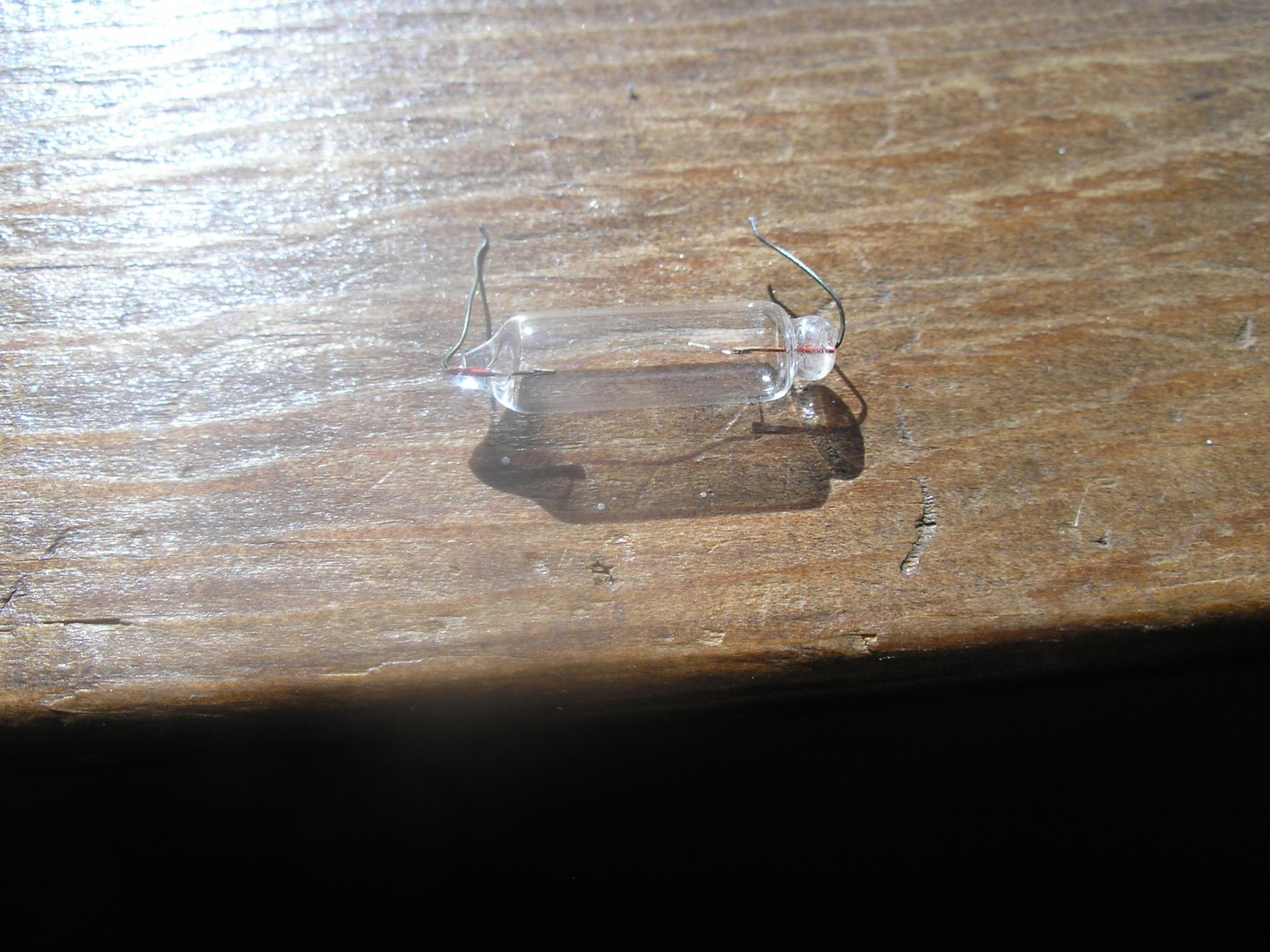

So other than maybe a little more tweaking (only if the service manual alignment procedure is wrong) the only other thing I would like to do is get the front panel meter lights working......but I can't find these lamps that have solder leads. They are 12v 150mA run in series from a 24v supply. I attached a photo of what they look like, any ideas where to find them?

I usually convert to LEDs when they come in with bad meter lamps.
This is a great idea but does the meter dimmer still work with LED's?
You are measuring and setting the current thru the output transistors only, Q217, 219 and Q218, 220. Qs 221-228 are the commutator transistors that only come into play at higher power levels, so they are not conducting at bias setting time.
Yes the dimmer will still work. If you measure the voltage at the emitter of Q451 at max brightness that will give you the starting point to figure out the series resistor you'll need to add.
Let's say it's 20VDC and the LEDs draw 20ma and drop 3 volts each. Since they in series the current stays the same, 20ma but the drops add so we have 6 volts dropped across the LEDS at 20ma, so 6/.02 is 300. You would need to install at least a 300 Ohm resistor in series with the LEDs. That would be full brightness on that particular LED, a larger resistor would dim it down, that's an area you might need to experiment with to get the desired effect.
