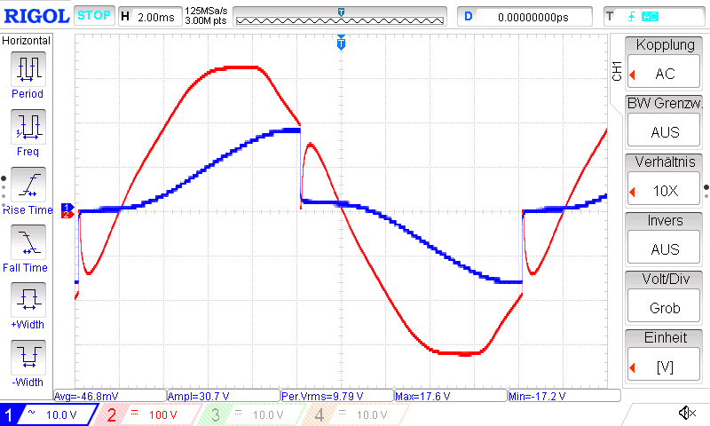

This thread is quite old (2005~2014) but hey, the Carver PT2400 on my bench is twice as old. I worked through this hole thread but did not find the answer to my problem. Both channels behave the same: They do not start on power-on. So I downloaded the service manual and did some measurements. These are my findings
Simple power up from mains
When switched on, there is some power consumption of 5-6W from the mains. Voltage across 2x10.000uF/125 caps builds up very slowly. After >1minute this ends at approx +-30~35volts. Thats all, no LEDs lighting, no sound.
Checking the TRIAC
Monitoring the TRIAC-ouput MT2 with my scope shows triggering at an phase angle of approx 150 degrees. As the voltage drop across the TRIAC is just a short spike once triggered the TRIAC does not hold indicating insufficient load current.
Checking the Power-Amp
With a primary light bulb limiter and the TRIAC shorted the 10.000uF/125 caps charge up to +-70V approx. Amp output is not loaded. The lower LED is active. Feeding audio signal into the input and turning up the volume makes the LED light move up until clipping. The outputs deliver accordingly high voltages. Looks like both amps are still working!
Fokusing on the Supplies
Some investigating on the trigger logic gave me first insights:
-This 4 transistor trigger logic is quite tricky. To understand I simulated it and came to the conclusion that the most early trigger point is a bit after 90 degree phase angle. This is achieved by using the current reversal through the trigger capacitor as a trigger event.
-The opto-couple current delays the trigger point, i.e. reduces the phase angle.
I assume the phase angle I observed is too small to start the engine. And there I am stuck! I do not have a clue howto make this dimmer start. Any ideas?
Hi bucks bunny,
I have a feeling that the protection network is preventing full start-up as it should. You probably have a fault elsewhere in the amplifier. Troubleshooting these when they are not right on my bench is pretty futile.
One thing for sure, do not short the triac!!! That controls the amount of power the amplifier receives and it will badly over-voltage internally and you could destroy the amplifier beyond repair. It would trip your breaker or blow that circuit fuse as well.
Carver amplifiers really do require training to understand and service successfully. That one is the same as a TFM-75, a really, really nice amplifier. It is capable of delivering massive amounts of power in normal operation, so respect it. Remember, it does not operate as a normal amplifier, there is a lot going on inside. Any number of things could easily cause protection to operate.
-Chris
Thank you for your fast response. I am aware that it is dangerous to bridge the TRIAC as output voltage could reach crititical levels. But with the 60W bulb dimmer in series of mains supplies this has worked.
You are probably right with your diagnosis.
The circuit diagrams are eye soring!😱
I will get a working carver next days so I hope by comparison I can trace that error.
