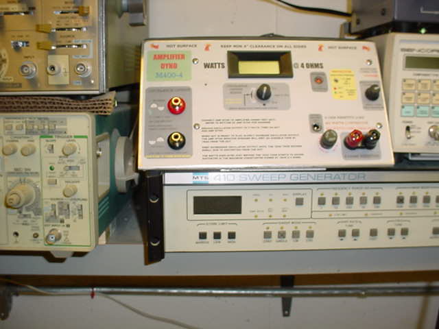

Photo is of the DIY "amp dyno" anybody want details?

Your amp dyno is a neat labour / time saving device. AC meter across built in dummy loads and calibrated in watts? Could be a 7106 based design.

Its an old design I started about 10 years ago, all analog except for the LCD meter. This is the main circuit, not shown are the 400 watt resistors, a fan and LCD display. Lower right corner is the power supply: sg3525 pwm driving a torroid core trans that provides isolated voltages for the LCD, oscillator, precision diode, analog multiplier. Upper right corner is the oscillator: low distortion 80hz/1khz sine wave that is amplified and drives a transformer, the transformer also provides an inverted phase output for bridging a stereo amplifier. Lower right is the voltage/watts conversion: precision rectifier driving a AD633 analog multiplier, output is scaled to drive a lcd display with a maximum of 1999 watts displayed. The power supply is driven from battery power, above about 100 watts the power is pulled from the load resistors so it saves the battery power. A built in fan keeps everything cool, its power is also derived from the load resistors. By using a 24v wall wart power supply to feed the unit, an internal circuit will switch the fan and pwm power supply to use the 24v power only. Thus providing only resistive loads to the amplifier under test.

That's a nice design, build quality is excellent. What's wrong with analog?? 😉
I'm sure it's saved you a ton of time over the years!

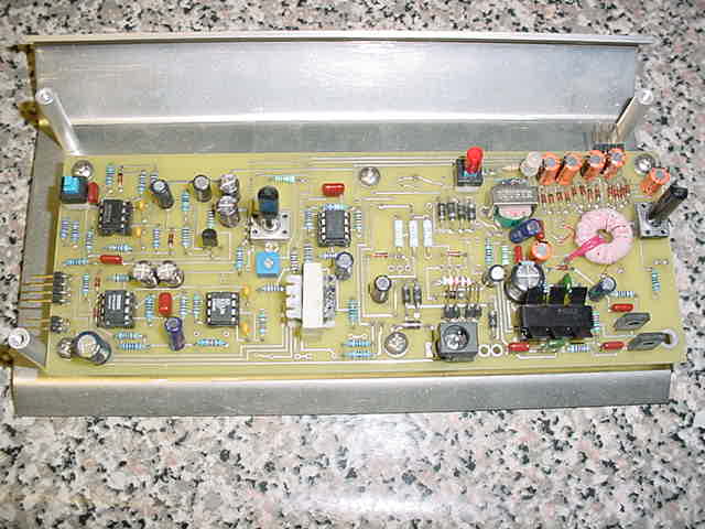

Fix for power supply capacitor replacement Carver M1.5t
I made a power supply capacitor daughter card. I am attaching a pdf and a paint shop pro file of its design. I used a laser printer (HP, Brother did not work because of toner formulation) to print and a laminator modified for higher temperature use to transfer the image to a blank copper printed circuit board.

I looked at several of the above pins, but I used the largest diameter ones from the above selection.
I also changed the 50 and 80 V diodes from 3 Amp to 6 Amp ones.
I hope this information helps you get your amp working. I have two, and they have worked fine since I made the repairs.
Be forwarned that a bad capacitor in the power supply will likely take out a few of the control transisters on the power amp boards. This will be a pain to figure out which ones to fix. I recommend putting some heat sinks on the ones at the top of the boards about 1/3 from the left side of the amp with the front facing you.
PDFs for the service manual are available elsewhere on this forum.

Capacitor daughtercard for Carver M1.5t
I designed the board with a pdf that I attached, using Express PCB (Google for download), ordered the parts and laminator with previously supplied part numbers, ordered the chemicals to make the PCB, and I made two PCBs for my amps. I am unable to attach the Express PCB file because it is not one of the supported file types for this discussion group. I also edited the file using Corel PaintShop Pro XI, and that is another file type not supported by this discussion group.
Can you just save it as a Jpeg?
When you go to save it, at the bottom of the screen where the file name is
should be a place where when you put your cursor in it, you can scroll and change the file type. I hope that helps. I have an Old version of PaintShopPro
and if you don't edit the file, just open then try save as...see if that is an option
for you.
cheers.
Hi fellas,
If you can save the PCB layout as a PDF, the size will be preserved. That means it can be printed onto the toner transfer paper used for laser printers. I can assure you that the finished quality is very good once you figure out the heat setting on your iron, and the pressure you need to apply. Yes, I use an iron for clothing. Since I recently had my right wrist operated on and was still able to produce really good boards (for smt parts yet!), I am confident that this will work for the majority of people. Once you get this working, it opens up an entire world of high quality PCB making for your own projects.
Being far behind the times, my PCBs were designed using Acrobat Photoshop. I determined the dimensions by printing some test lines on paper and matching those to the lead spacing I needed. Extremely low tech, but it works well. After figuring out the pad layout, I cut and paste what I need to the board design. You younger folks ought to be able to do better than I did.
