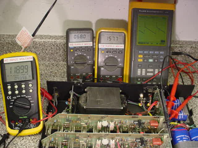

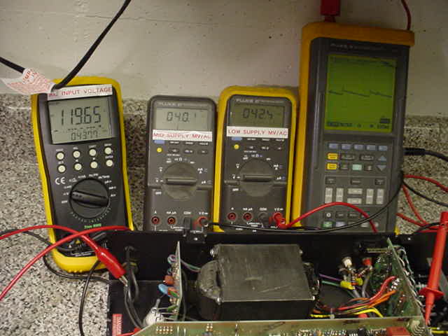

Perhaps I should explain my term "hi freq" since its really mid freq. My main load testing devices are some DIY "amplifier dynos" that have 2 frequency output settings: Lo freq (80hz) for car subwoofer amplifiers and Hi freq (1Khz) for all other amplifiers. The Cavers still seem to do well at 1Khz but I wouldn't want to go any higher.
Ok, more insults about my Fluke scopemeter. The photos were not current but I still use that same scope 99% of the time. Its really not the POS everyone thinks it is, this baby is the Crown Jewel of my work bench. The first scopemeter Fluke made, and everyone knows they cut corners on later models. I'm now just starting to break-in the Hi-Res LCD, thats why you can't see the "pip" on the old photos.
No luck in finding the thermal images I saved on CD. Give me a few days and I will scan another m400 cube and possibly another m1.5 and post the thermal image.
You seem to be one of the few Techs that really understand the Carver topology, I've picked up a few good tips from some of your past posts.
Photo is of the DIY "amp dyno" anybody want details?

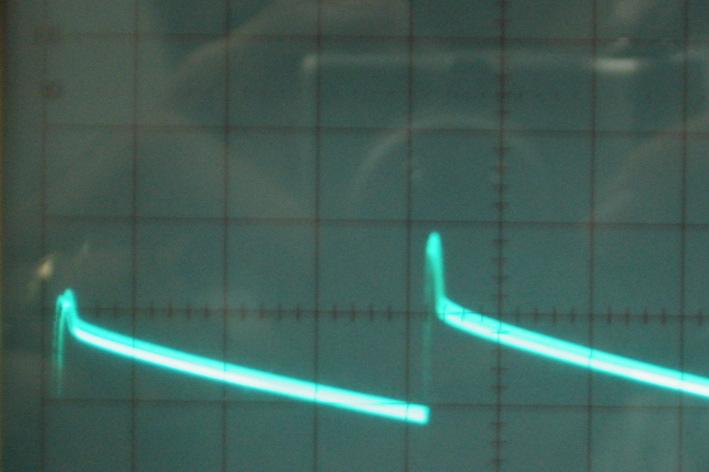

The problem with high frequencies and this style amp is that the commutators turn on rapidly and stay on for a minimum period of time. Therefore as the frequency goes up, the commutator tends to stay turned on. It is "locked up". This has the effect of running the output stage at a far higher voltage than is was designed for. It will overheat as a result.
I could see the basic form of the "pips". It would be interesting to see what you can capture in the high res mode then.
Your amp dyno is a neat labour / time saving device. AC meter across built in dummy loads and calibrated in watts? Could be a 7106 based design.
-Chris

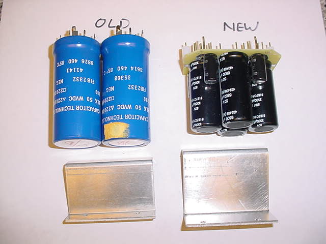

Was wondering if anyone knows about Jensen 4 pole electrolytics. I'm trying to replace the 4 pole 2200uf power supply capacitors on the Carver M1.5t using the Jensens. Little confused on the wiring. The Computer Technology capacitors used originally were made with their circuit layout exactly as the circuit board dictates. Would I have to cross wire the Jensens (long leads, strink tube, etc) to match what I'd need for them to be used on the board?

Fix for power supply capacitor replacement Carver M1.5t
I made a power supply capacitor daughter card. I am attaching a pdf and a paint shop pro file of its design. I used a laser printer (HP, Brother did not work because of toner formulation) to print and a laminator modified for higher temperature use to transfer the image to a blank copper printed circuit board.

I used the PCB with the thickest layer of copper. This caused heat transfer difficulties with the laminator. I recommend backing off to the second thickest available layer.

I also changed the 50 and 80 V diodes from 3 Amp to 6 Amp ones.
I hope this information helps you get your amp working. I have two, and they have worked fine since I made the repairs.

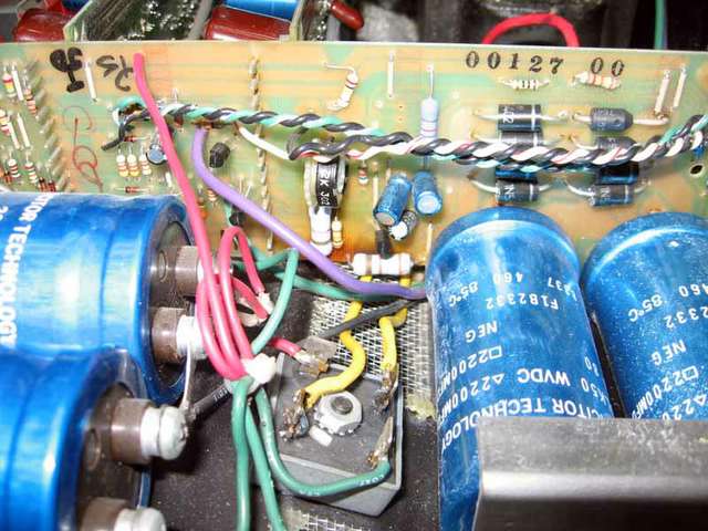

Be forwarned that a bad capacitor in the power supply will likely take out a few of the control transisters on the power amp boards. This will be a pain to figure out which ones to fix. I recommend putting some heat sinks on the ones at the top of the boards about 1/3 from the left side of the amp with the front facing you.
