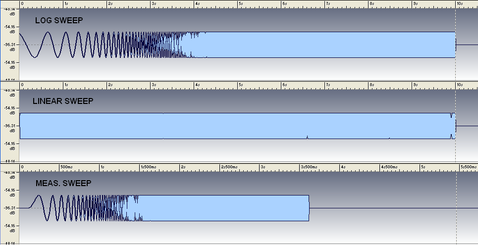

Lucky, through REW you can record three kinds of sweep files (16bit/24kHz).
Freq to 24kHz, level from –3dBFS to –60dBFS (0dBFS in volts depends upon your soundcard). You can digitally attenuate these –60dBFS files still further to your liking.
If you have any difficulty, I can record and upload such files to your specs

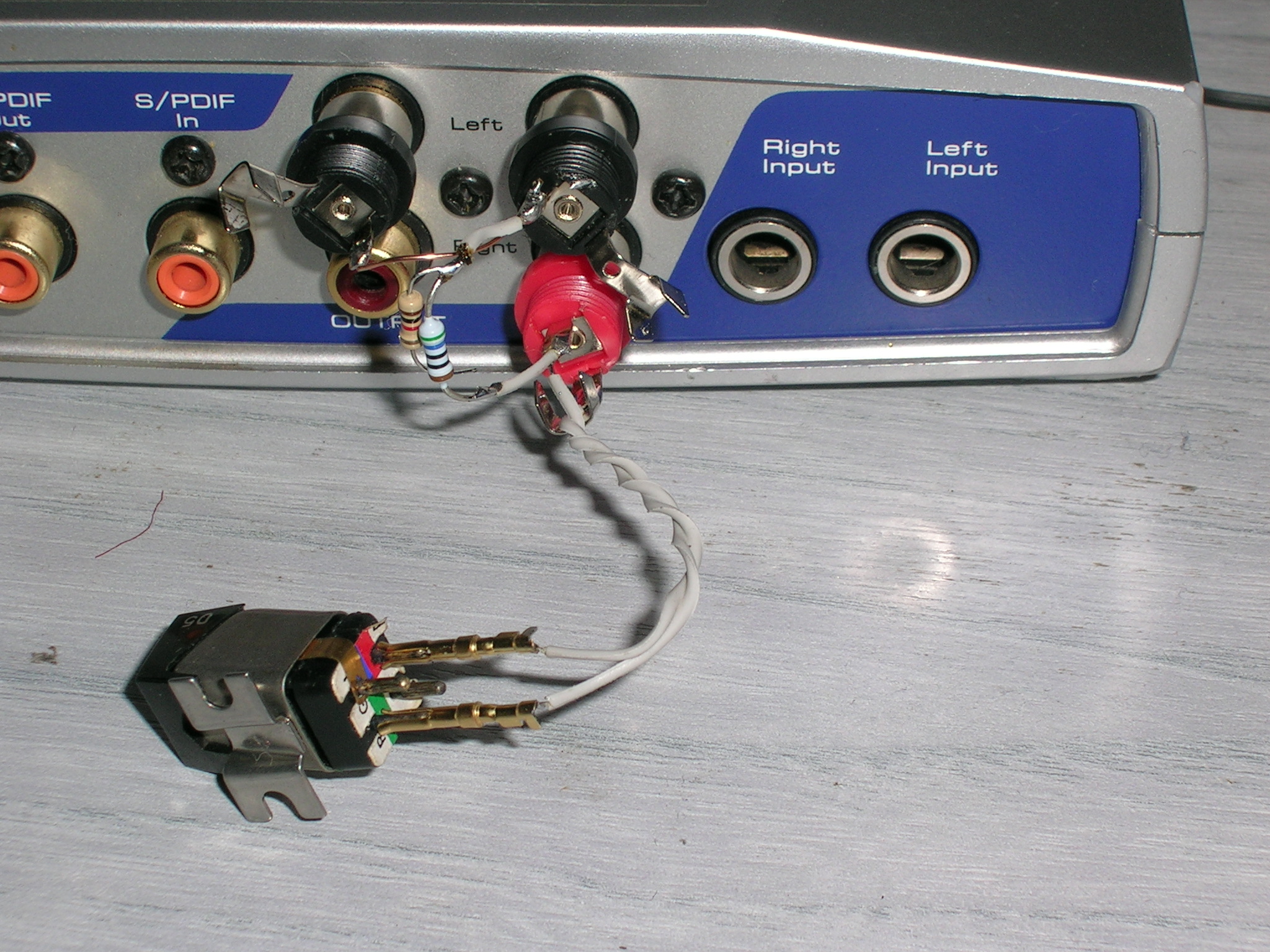

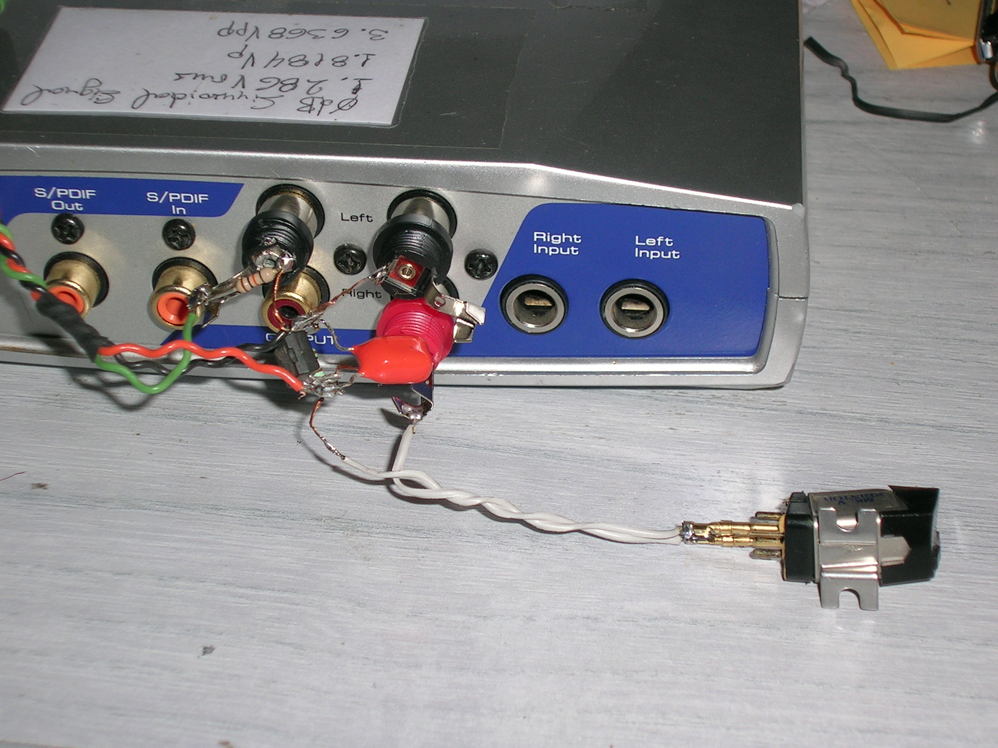

Tomorrow I will redo the test with shorter wires. I think that phase plot hints to high capacitance of the wiring.
There is only little betterment with the shorter cables.

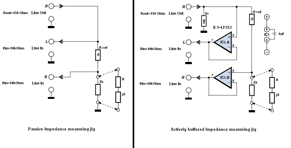

With DUT like an MM cartridge, using a passive jig is problematic, as Rin of the soundcard (10kOhm) acts as a voltage divider when Z of the DUT goes above some kOhms at high frequencies.
I built a buffered Impedance measuring jig to get around this problem. Results are very good. I’ll post tommorow.

PC soundcard approaches will work. A large resistor in series with the source, eg 1MOhm will attenuate the measurement signal by over 60dB to mV levels. The voltage across the coil will need a simple opamp preamplifier of 20 to 40dB gain. you will need to put the jest jig in a metal box for shielding.Part of the challenge in examining coil behaviour at true signal levels is synthesising signals small enough, and being able to measure impedance with enough resolution using only that signal for the method to be practicable and meaningful......

Apols I should have been clearer.PC soundcard approaches will work. A large resistor in series with the source, eg 1MOhm will attenuate the measurement signal by over 60dB to mV levels. The voltage across the coil will need a simple opamp preamplifier of 20 to 40dB gain. you will need to put the jest jig in a metal box for shielding.
The largest sine signal trackable at 10kHz works out about -60 dBV cartridge output level. So to explore the phenomenum at normal or small signals we need to generate accurate sine waves at low impedance perhaps around the -100dBV levels, and be able to measure them reasonably accurately. It's not impossible, but it's not trivial and is really an instrumentation job.
It's much tidier George's rig now, but I think not too surprising that flying cable strays don't factor. What I find more generally surprising is that self-capacitance of the coil doesn't show up as resonant system (with coil inductance) when looking at coil impedance..........?

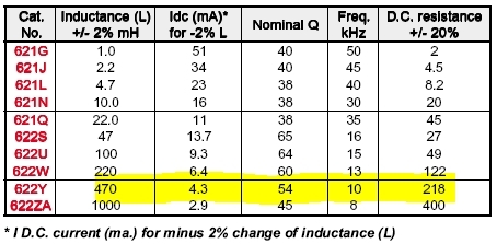

I have a feeling of deja vu about this, did we examine self-resonance this way before and fail to find it? If so I wonder why......?
Attached is a table of commercial inductor parameters that shows highlighted similar type and construction as a cartridge coil, at face value.

I am working in collecting impedance data with the new jig. I am not ready yet.
