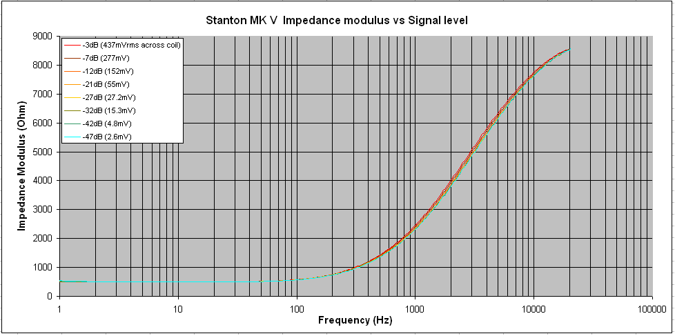

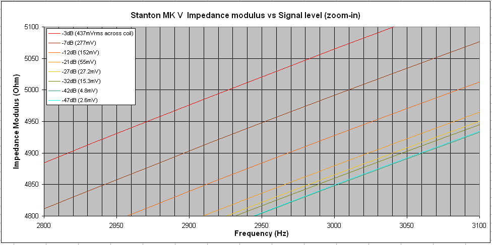

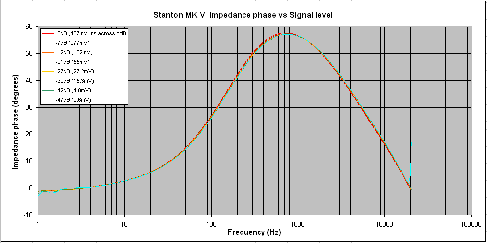

First try of MM cartridge impedance plots with varying excitation level.
I used the impedance jig that I use for measuring speaker units, only standard resistor is 500 Ohms.
M-Audio USB Audiophile soundcard. Rout=150 Ohm, Rin=10kOhm
REW software, data exported to Excel (jaddie, I can't make REW Impedance axis show above 1kOhm)
Tomorrow I will redo the test with shorter wires. I think that phase plot hints to high capacitance of the wiring.
The mVrms signal across the cartridge coil was spot measured at 100Hz

Thanks George.
Is it possible to use signal levels roughly similar to those occurring in playback, so 0dB=5mV, and a range from +10dB to -50dB or as small as is practicable to measure?

One problem here is that stimulation of a cartridge with its stylus free of mechanical load will present an entirely different back EMF characteristic than that of a stylus mechanically loaded. Worse, you can't represent dynamic impedance accurately this way because the mechanical aspect of the modulated groove as an impedance component is absent.

The plots seem to show a broad spectrum (not frequency specific) impedance change of less than 5%. Unless your cable C was fairly high to begin with I wouldn't expect much change.
Is the cart in an arm with the stylus resting in a groove during these tests?
