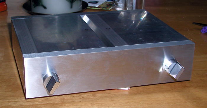

looks great. I love the simplicity. Does the case get very warm?
How much extra space do you have in the front of your case? By the picture above of your wiring, it looks the chassis could be half the depth. Is this so?

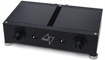

He did a great job. I think he is getting 25W out of it. For comparison, here is a decent pic of the original chassis for the real gaincard:
I am wondering how Peter managed to have no visible screws on the chassis. This is quite a mystery.

So you guys don't read the thread about Black Gates. I posted the pics there as well as some comments about the amp. This amp is so good that I've already started building another one today. For the time and money invested you won't find better deal.😉
I'm getting 40W out of it. Brian, the case could be shorter, but it acts as a heatsing so the size is right. When I play full power, it is pretty warm. Also anything smaller would not be stable enough. Original Gain Card is 0.7 size of mine.

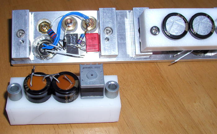

Please publish more pics of your stunning Gainclone, especially of the inside. Did you glue the chassis together?

Here's the pic of the inside. My aim was to get the caps as close as possible to the IC pins. With a special mounting block it was possible. You see there a Wima cap (0.1u) parallel with 220k resistor connecting positive input to the ground. Eventually the positive input was connected directly to the ground for cleaner sound. There is no input coupling cap here, but I had to add it later (4.7 BG NX), because of the DC offset, which appeared even when my DAC had 0V DC on the output.
This amp is good for any speakers (with reasonable efficiency though). I was using it with my B&W clones, which are about 91dB and I was never lacking power.

I just noticed the screw heads on the screws holding the aluminum blocks to the heatsink/back plate. What kind of screws are you using?

Those are aircraft titanium screws. This is the only type of screws (titanium) you can use in anodizing process, and I didn't want to dissassemble everything again when anodizing.
Those screws are used on Dash 8 and are really PITA to use.😉
