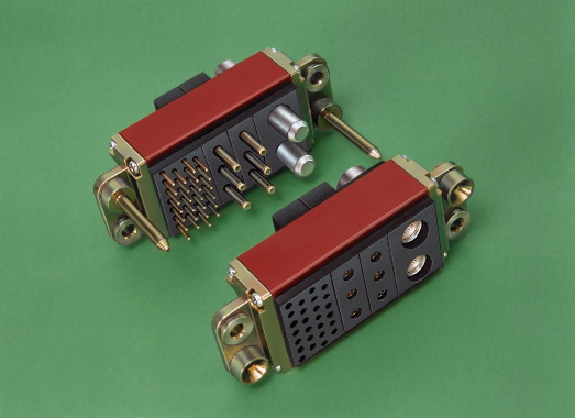

fcel said:What is that for?
Hi fcel,
This is an industrial multi contact perhaps worth considering as multi binding posts. Look at www.multi-contact.com and search for CombiTac.
Thomas B

Thomas B,
I have a ton of experience with connectors like that and they just don't maintain the solid contact you need for binding posts. If I had a quarter for every problem caused by connectors needing reseating I could.... well, anyway. The amount of pins in the connector requires a little slop in both the pin insertions and their actual contact. Something you don't need. 😉

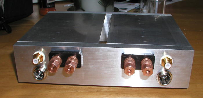

Peter Daniel said:Cardas binding posts... 😉
The binding posts that you used for your Gainclone are the same cardas copper named for the group order, right?
Brian

Re: Re: Cardas binding posts thread
Yes😉
Yes😉
Here's the pic. The short posts are barely good for 1/4" panel (different washers are actually recommended to use a nut properly). The long ones are good for almost 1".
