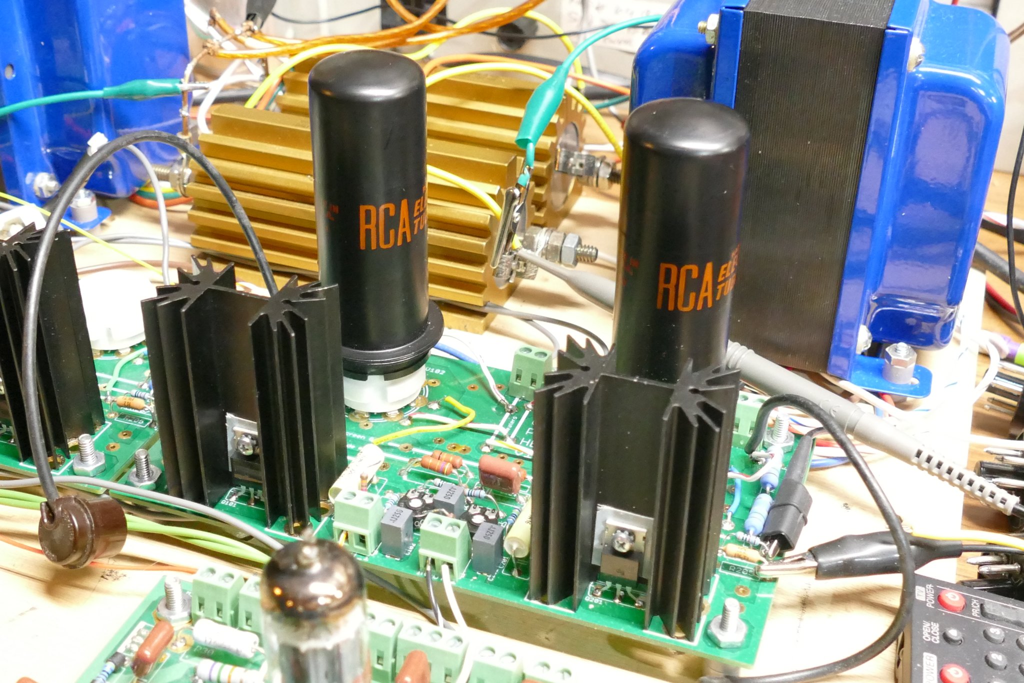

I got the 5 "NOS" metal 6L6 tubes yesterday and tried them in a test amp that was already on my bench. All worked fine, but some are more NOS than others though. These are the best looking pair, but all made at least 50 watts on 400 volts of B+ without issue. I don't plan on running them that hard since most of the guitar speakers that I have are rated for 25 to 40 watts and my current guitar amp only makes 4 watts.
The old metal 6L6s contain the same guts as a glass 6L6G or 6L6GA. The old data sheet I have shows operating conditions that result in up to 60 watts of audio power output from a pair. I'll probably go with about 30 watts depending on what I can find in my collection for a power transformer.

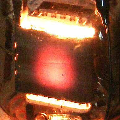

When I get around to building a high powered guitar amp, it WILL glow, but probably not as much as the amp (barely) seen in my avatar. The filament in that thing consumes 100 watts! The plate is dissipating about 300 more watts in this picture.
I do have some 4D32 transmitting tubes that I have been saving for almost 20 years. A pair of them should look pretty cool......or HOT!
