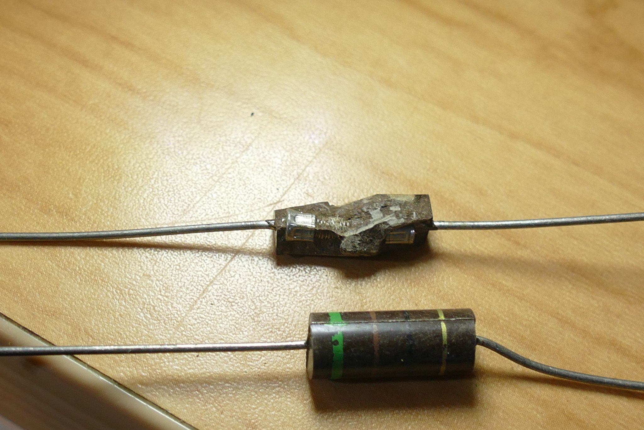

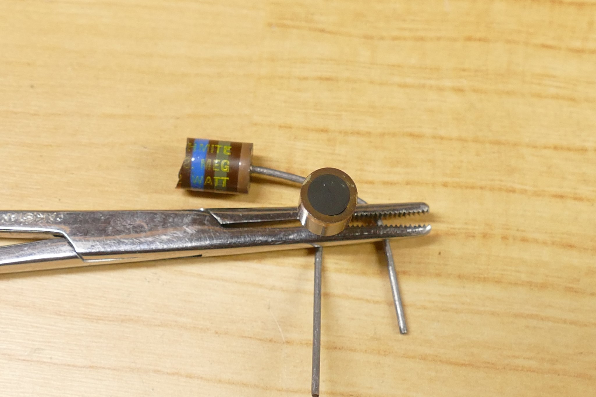

Beware of FAKES!
I have seen resistors sold as "Carbon Comps" that contained a wirewound resistor, or even a leaded 1/4 watt carbon film resistor inside. Thin leads are often the give away.
If you are buying a bunch of surplus resistors, crush or cut one in half to see what's inside. The old style CCs will break pretty easily and something that looks like black pencil lead will be inside.
The fake in the first picture is a wirewound as can be clearly seen. This bad boy survived a hammer whack while sitting on a concrete block, so I chipped away at the case with sharp wire cutters.
The second resistor was labeled OHMITE 1.8 MEG 2 WATT right on the side and is genuine. It was easy to cut in half with the wirecutters.

The double width first band on a color coded resistor means it is a wirewound type.

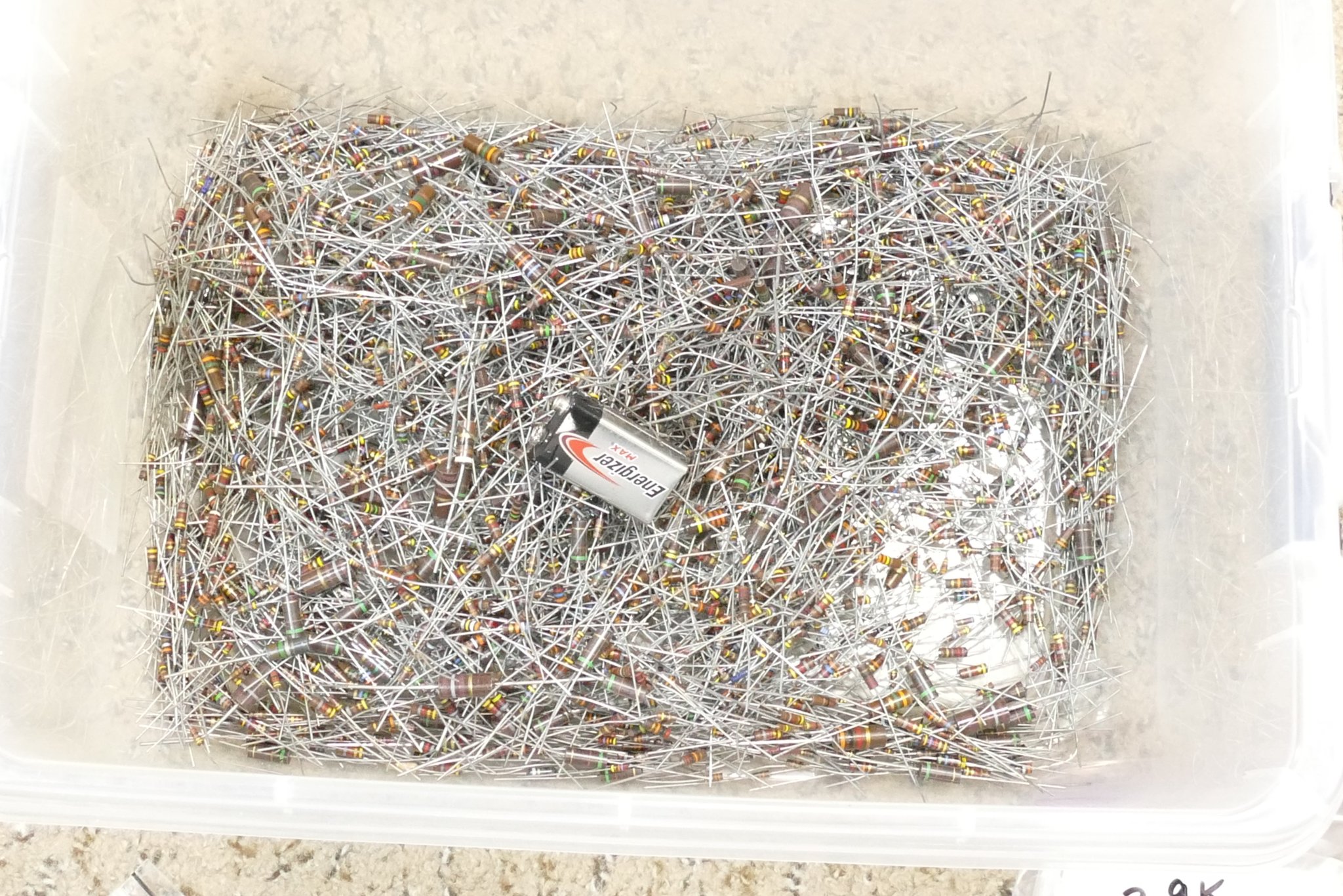

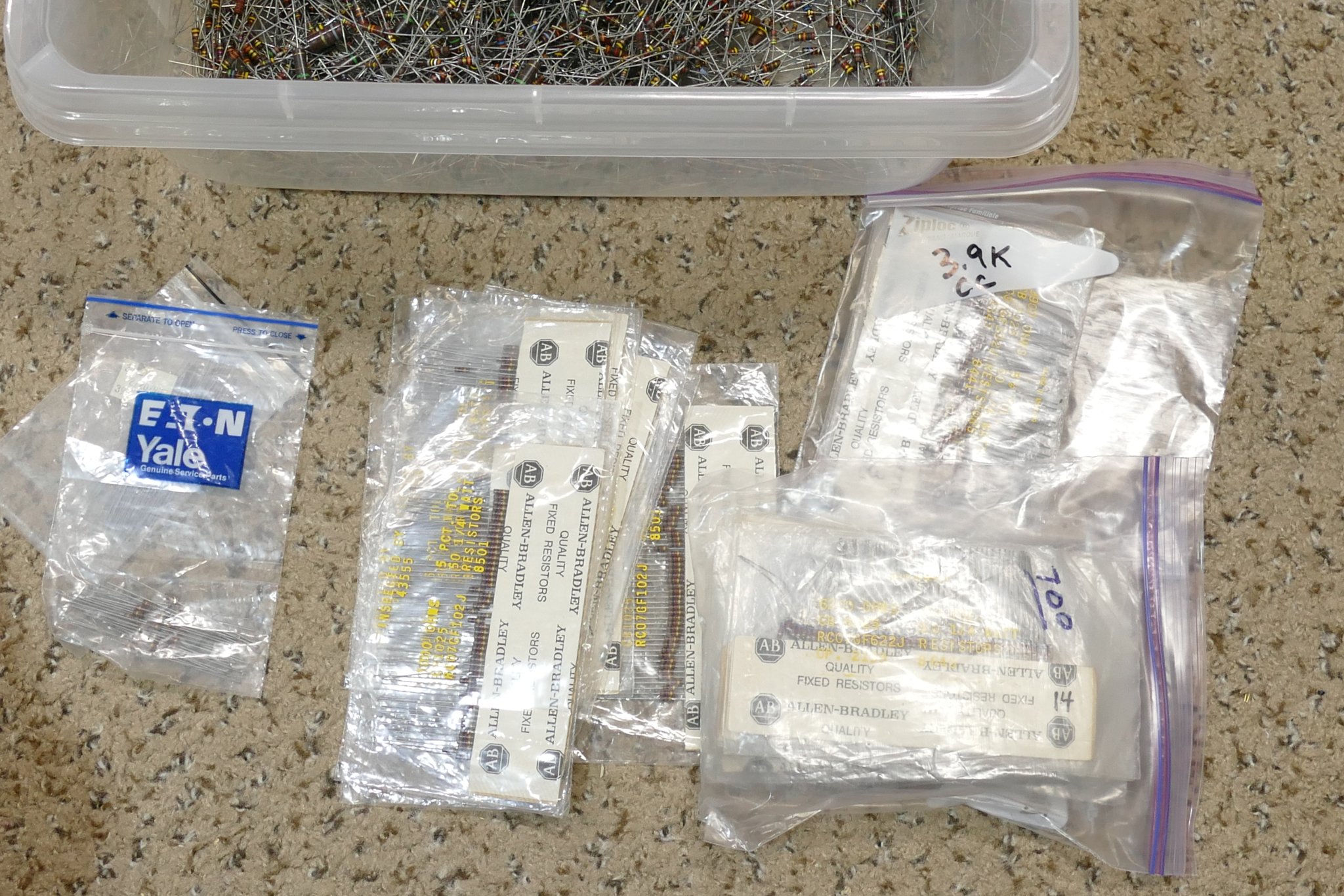

OK, I never knew that. That explains the wirewound resistors. I have seen one that had what looks like an ordinary leaded metal or carbon film resistor inside. It was some time ago, so as with the two I cut open today, it was trashed long ago. I think that it came out of this bin full of resistors that I got at a hamfest long ago. I also have about 500 1K ohm 1/4 watt CC's, 700 6.2Ks and 400 3.9Ks all still in their Allen Bradley packaging. I have been using them on the grid of those high Gm TV IF amp tubes that like to oscillate and on the gates of some mosfets too. 9 volt battery thrown in for size comparison.

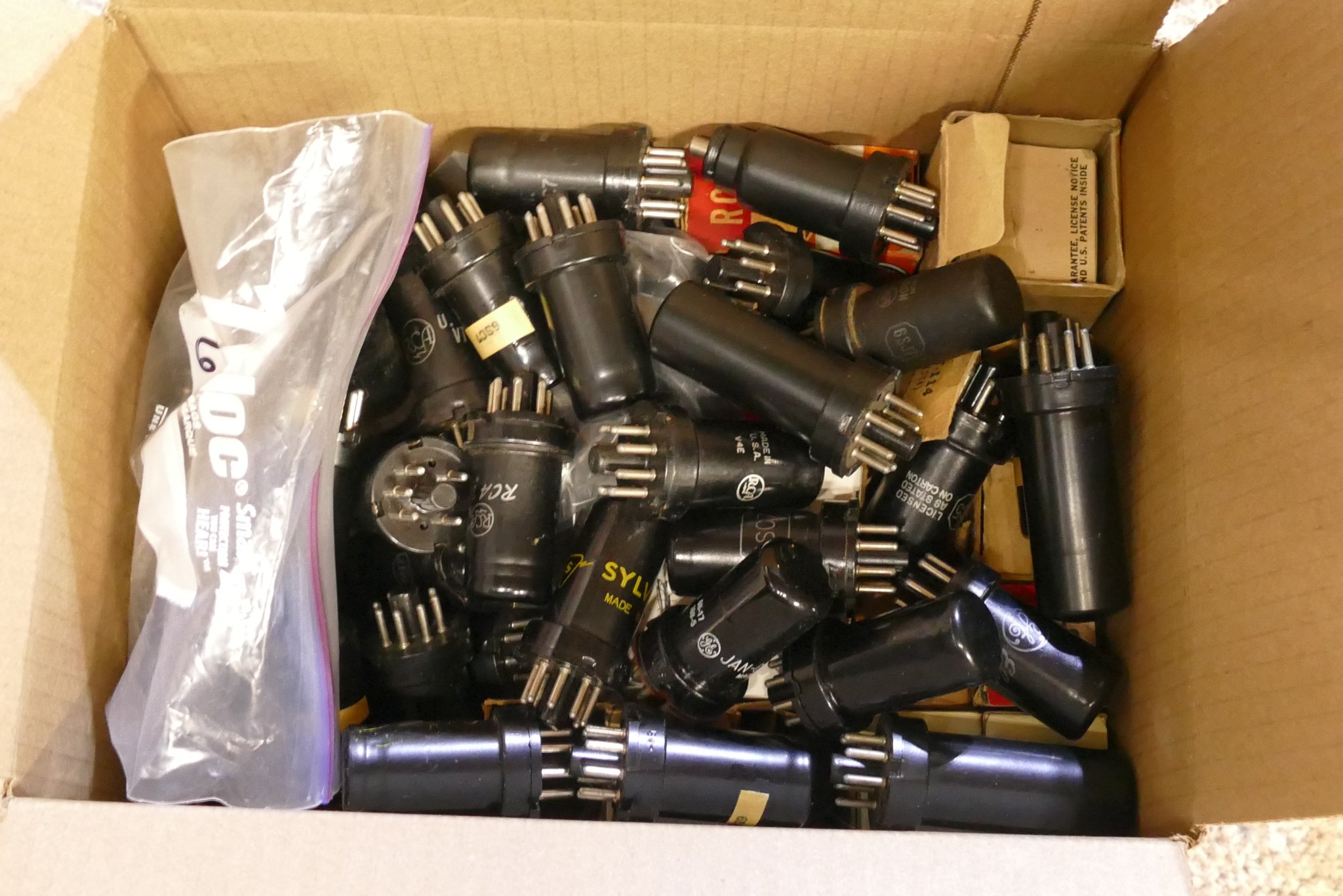

The plastic bin full of "old looking resistors" came from a hamfest for $10 I think. I also have a bin full of old metal cased vacuum tubes that were hamfest scores. Many were free, but all cost less than $1 each. It includes 8 X metal 6V6s that are still shiny, and two metal 6L6s that are quite rusty. There is a mil spec 5T4 that's still new in the box for a rectifier.
Both collections are slated for a guitar amp build that I will call MetallicAmp, all tube, no glass. I still need some more "Bumble Bee caps" though. These are also prized "tone caps" in the eyes of some guitar and amp builders, and yes, there are fakes. My amp build will be a modern high gain screamer, but be constructed with all parts from before I was born (1952). That rules out the CK722 and 2N107.

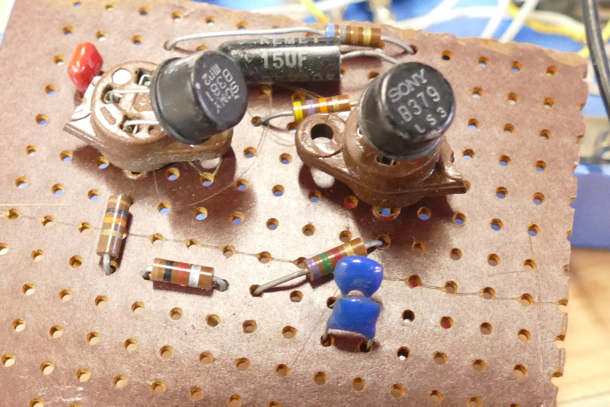

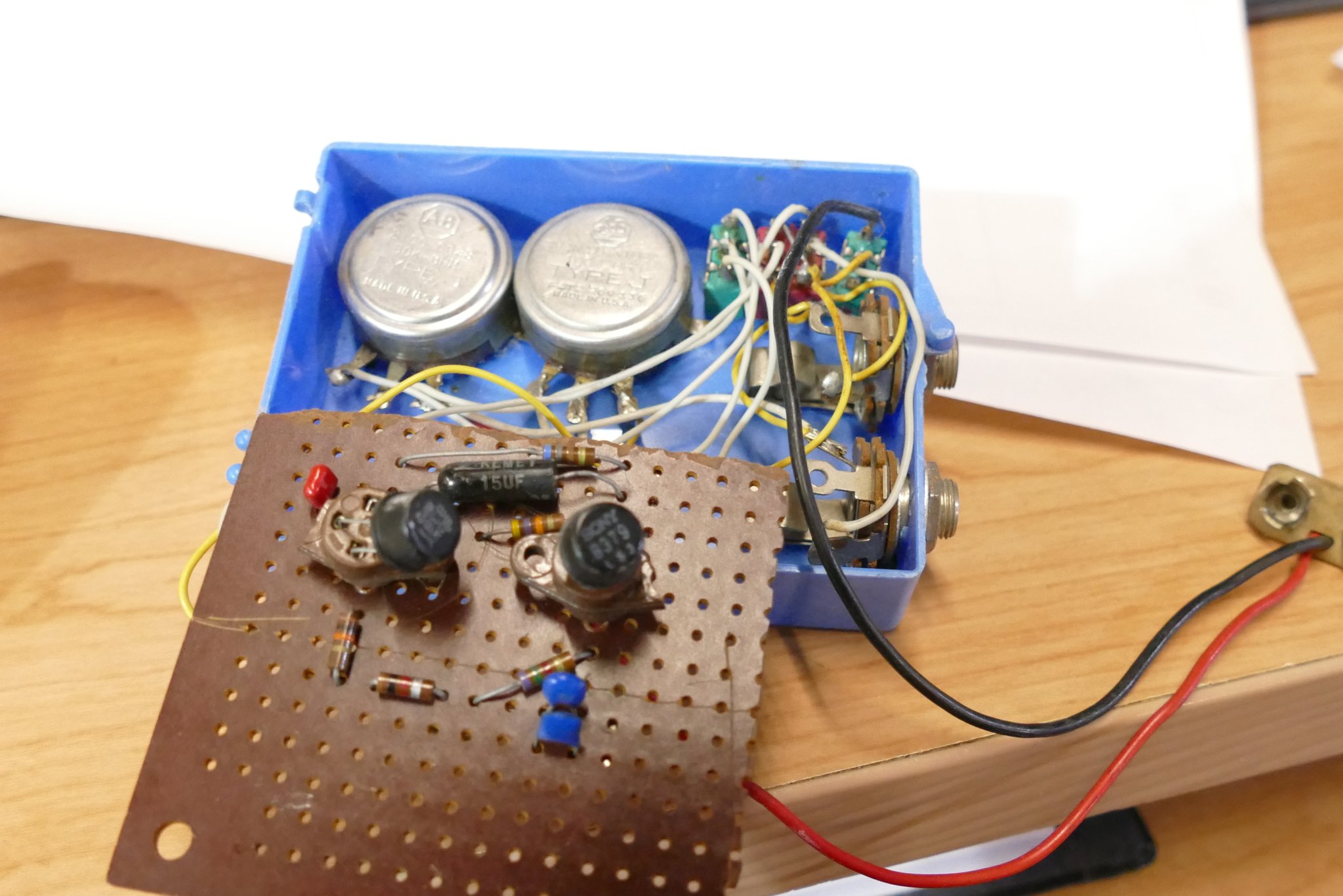

This is my first iteration of a germanium fuzz box that I made long before Al Gore invented the internet. Maybe even before the electric guitar was invented. 🙂
I got the schematic by taking a friend's Vox Tone Bender apart and tracing it's schematic.
The quality plastic box and phenolic proto board say "old junk" but the tantalum cap dates this contraption to about 1970. The funny looking transistors inside the Vox unit were unlike anything I ever saw, so I put sockets in this thing to test some transistors for best tone. The Sony parts came from some dead electronics, probably a radio. We all knew that CC resistors were the best.......since that's all we had in the 60's. They probably came from one of the local (Miami) surplus shops, or maybe the Lafayette Radio Electronics store. We didn't have a Radio Shack or Olson yet. The colorful ceramic caps did come from surplus shop known as the "Ham Shack" which became HS electronics, then went away. The transistor sockets with broken ears came from the dumpster behind Simpson Electronics, a manufacturer of HF marine radios.
