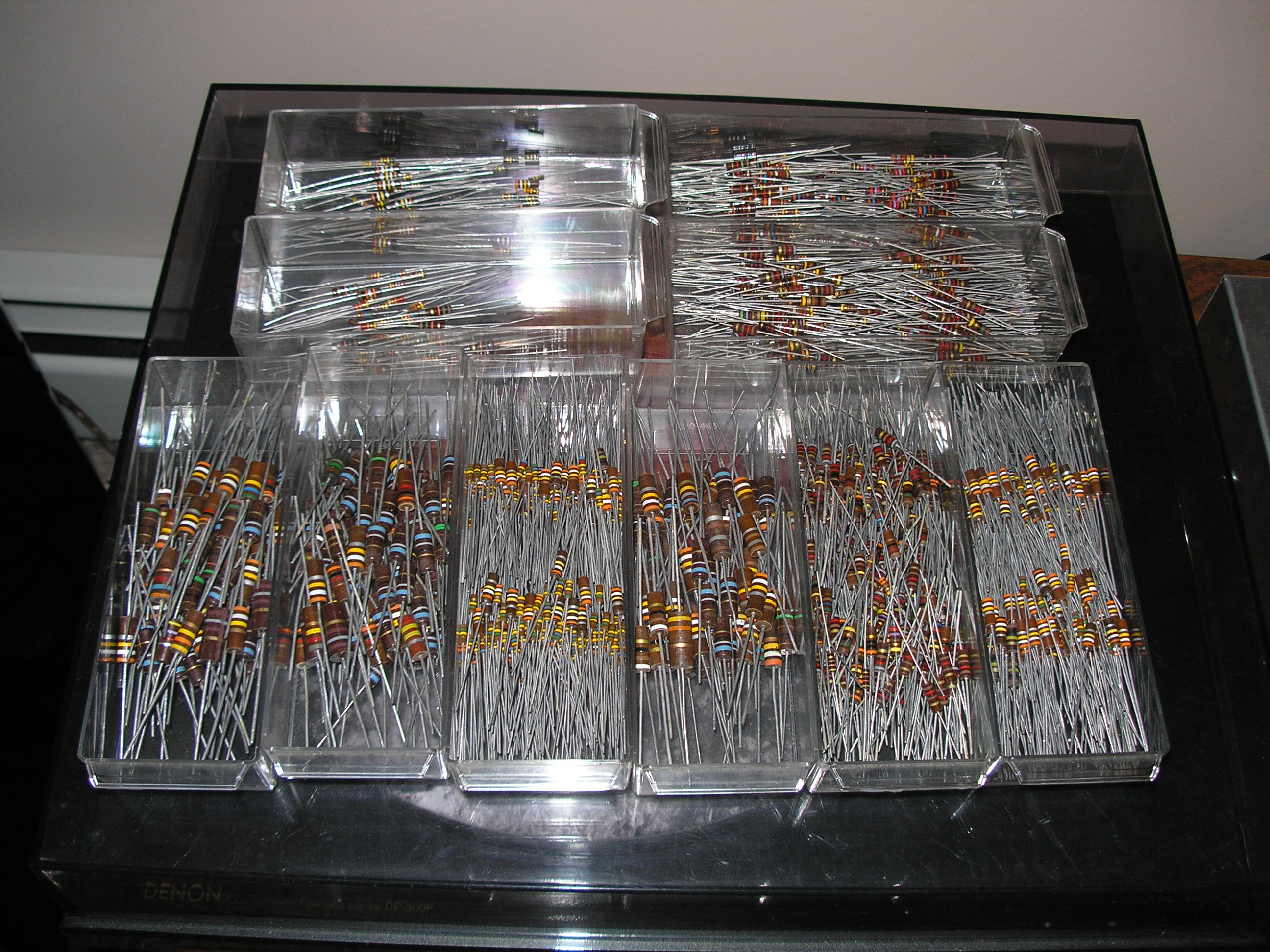

I have organized the CC resistors. There are a bunch of good film resistors too that I will organize. All in all there is plenty of good stuff to be used here. The ones I measure for the most part are within spec so I am pleased.

Thank you for telling the community about the sale. I am curious to see what's in your box. When I first opened the box I said to myself this will take forever to organize but it only took me a few movies to do.

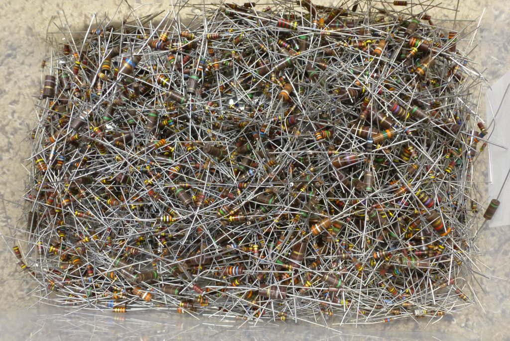

About half an hour ago the UPS guy rang the doorbell. As I opened the door I see the truck driving away and a box on the porch. Normal, it's the end of a 12 hr shift for him. Upon bringing the box inside, I see that it has been ripped nearly in two, then taped back together. This is not the first time they have mangled something. The 300 rotary encoders are in plastic tubes of 50 much like DIP chips. Most of the tubes are bent, but it looks like only two encoders are damaged beyond bent pins.
The resistor box had broken open, but the resistors had been stuffed inside the box so well, that they remained a solid brick with only a few loose resistors. I find no obvious broken ones. Now how many can I sort out during tonight's episode of MacGyver?

Between Happy birthday phone calls, a plate of fresh baked cookies from my daughter, and the TV set I managed to sort maybe a hundred 1 watt resistors. There are maybe 25 that are 51 ohm, a dozen 1.3 meg, eight 16 meg, eleven 39 ohm, nine 68K, seven 68 ohm, six 33K, five 240K, and a bunch of odd valued singles and pairs. That's probably 10 to 15% of the 1 watt resistors. There are less 2 watt resistors and the obvious multiples are 180 ohm and 3.0K.
I'll be gone most of tomorrow, so I won't get back to these for a while
