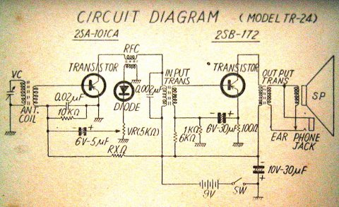

Some of us are old enough to remember the Japanese two (germanium) transistor radios from the late 50's that used the "reflex" circuit. It ran the RF through transistor #1 for RF gain, then through a diode detector, resulting in audio, which ran back through transistor #1 again to be amplified again. The audio then went to the volume pot, and to transistor which drove the speaker.
