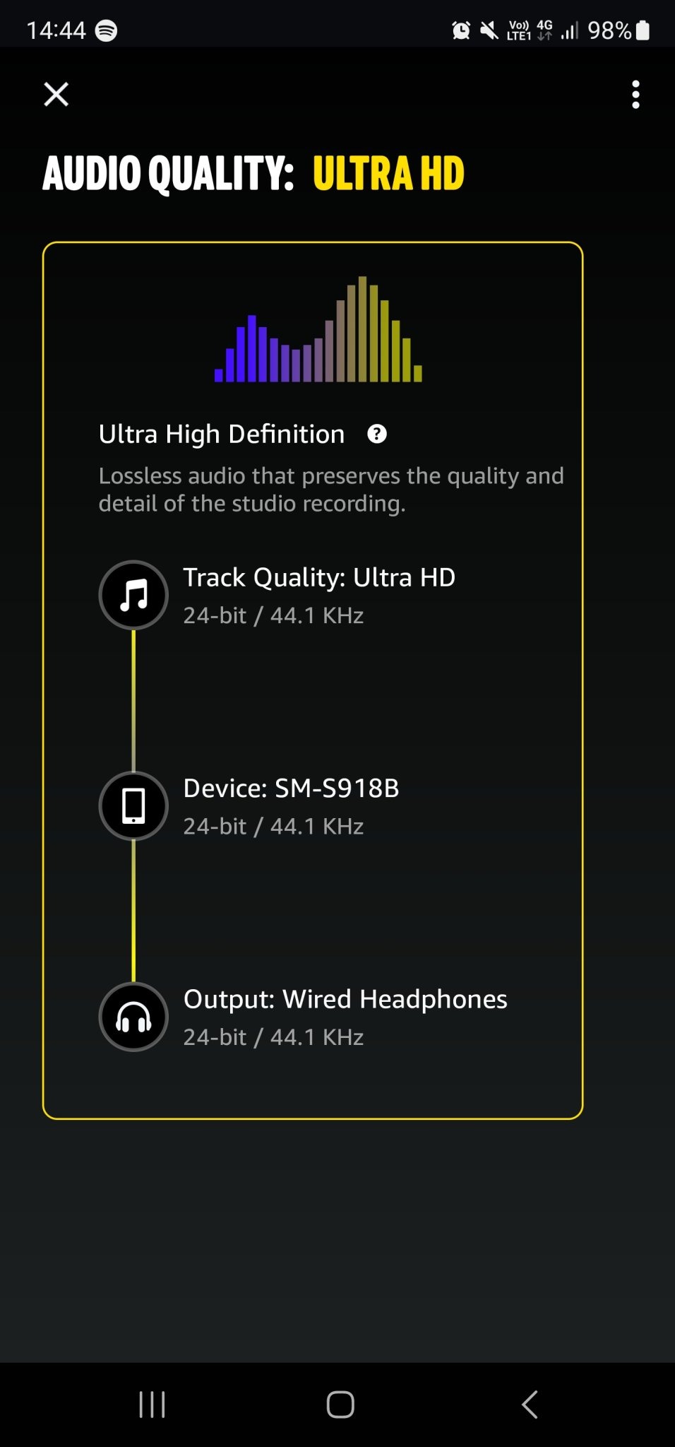

Hi All, I somehow managed to get this pop up on my phone the other day (have no idea how I did it and can't seem to replicate it now) whilst the Fiio DAP was connected (obviously when I wasn't using the Bluetooth), what does this look like?

Well Android has a reputation for mangling audio through its system mixer - similar to how Windows XP used to handle audio - so it's not just your S23 at fault. There are Audio audio player apps which bypass Android's audio sub-system - the ones I recall are Onkyo HF Player and USB Audio Player PRO. But there are probably more these days. Just Google "bit perfect audio player Android".I'm wondering if it's something to do with my Android Samsung S23 Ultra resampling the output before it leaves the USB port in digital form?
Maybe you could try one of these apps.

OK so I've found out how to establish the quality of each track on Amazon HD.
It appears that the HD tracks are 16bit/44.1 hz and the Ultra HD are 24bit/44.1 hz.
Therefore doesn't matter if I use Bluetooth from my phone to my Audison BCON Bluetooth Streamer that is then connected to my Dsp via Optical (as the streamer is capable of 24bit/96hz) or connect the phone directly to the Fiio K3 (the K3 is capable of 32bit/384Khz) and then directly to the DSP (the DSP is capable of 24bit/192hz), every one of those components is rated higher than the music available from Amazon HD.
So therefore why is streaming to the BCON better audio quality than optical to the K3 and then optical to the DSP? That should sound better right?
I've been reading about Bitperfect, and that Amazon is downsampled/upsampled by Android, but apparently Tidal isn't as it has a work around in the App. However this article is from 2021, and I think I've also read somewhere about Amazon now having that work around but can't find if anymore? Anybody know if it's like Tidal now and Bitperfect?
Although surely if its due to this then it would also be affecting the Bluetooth feed? But the Bluetooth feed sounds better!!
