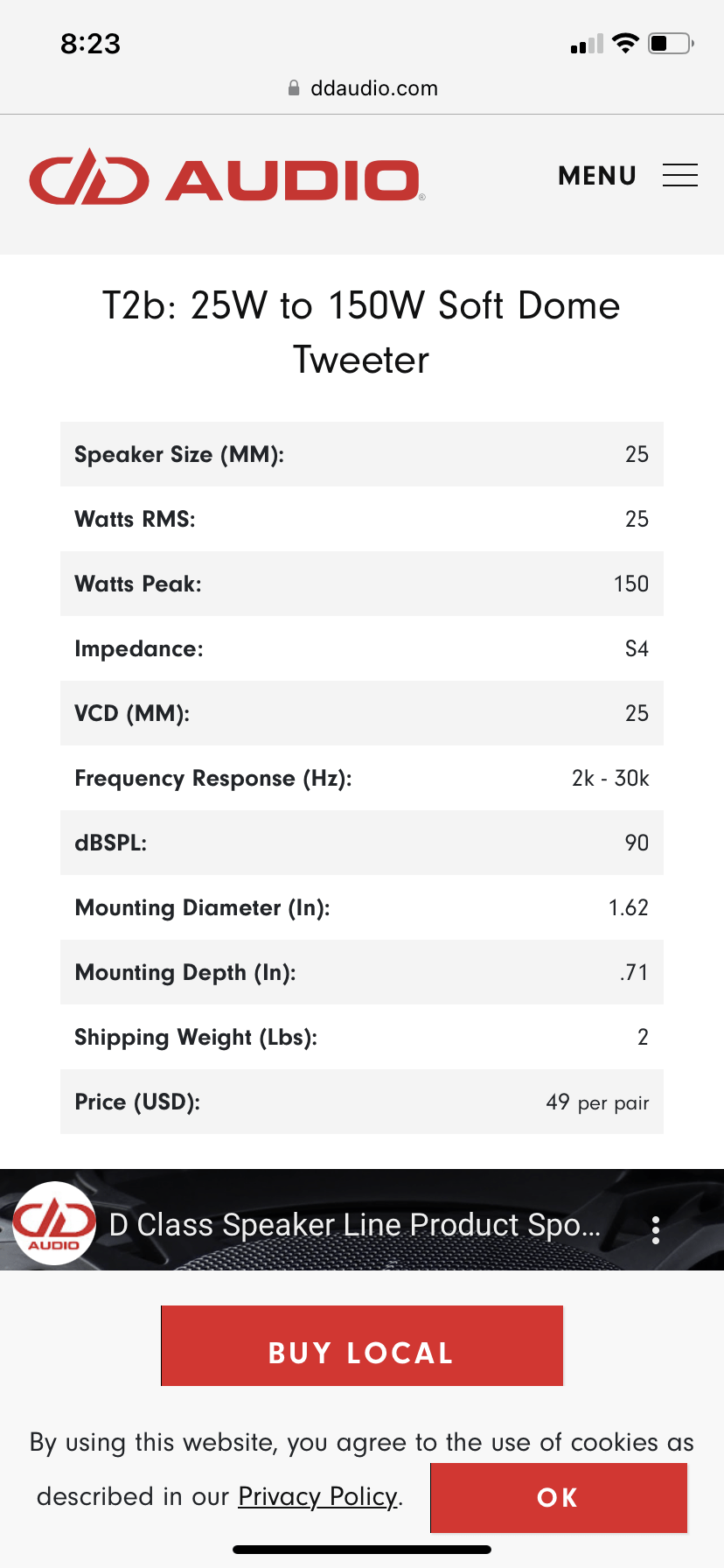

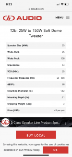

Ok up to the next question . I have a set of tweeters going in the kick panels see picture .
Should I add a bipolar caps to these ? I’m gonna be running crossovers thru a dsp but wondering if I should also add a bipolar cap to these tweeters ?
And if so anyone know what value cap I should add and voltage rating ?

A capacitor will protect the tweeter in case the amp ever fails in a way that drives DC to the speaker output.
Any capacitor will provide protection from DC. You'll need a capacitor that will allow all frequencies from the DSP to pass.
For an amp that will not produce significantly more than the tweeters can handle, a 100v cap would be more than enough.
Where do you want the tweeter to work from and to. 6Khz or lower? it's a 4 ohm driver. To add clarity use steep ramps
18-24db 3rd or 4th order. You can use 12 or even 6 but it is sloppy for what I do and a lot less protection. With those tweets
your not going to break the bank. But mounted in the kicks even dome have their work cut out for themselves. Good place
for a 7-8" full range.

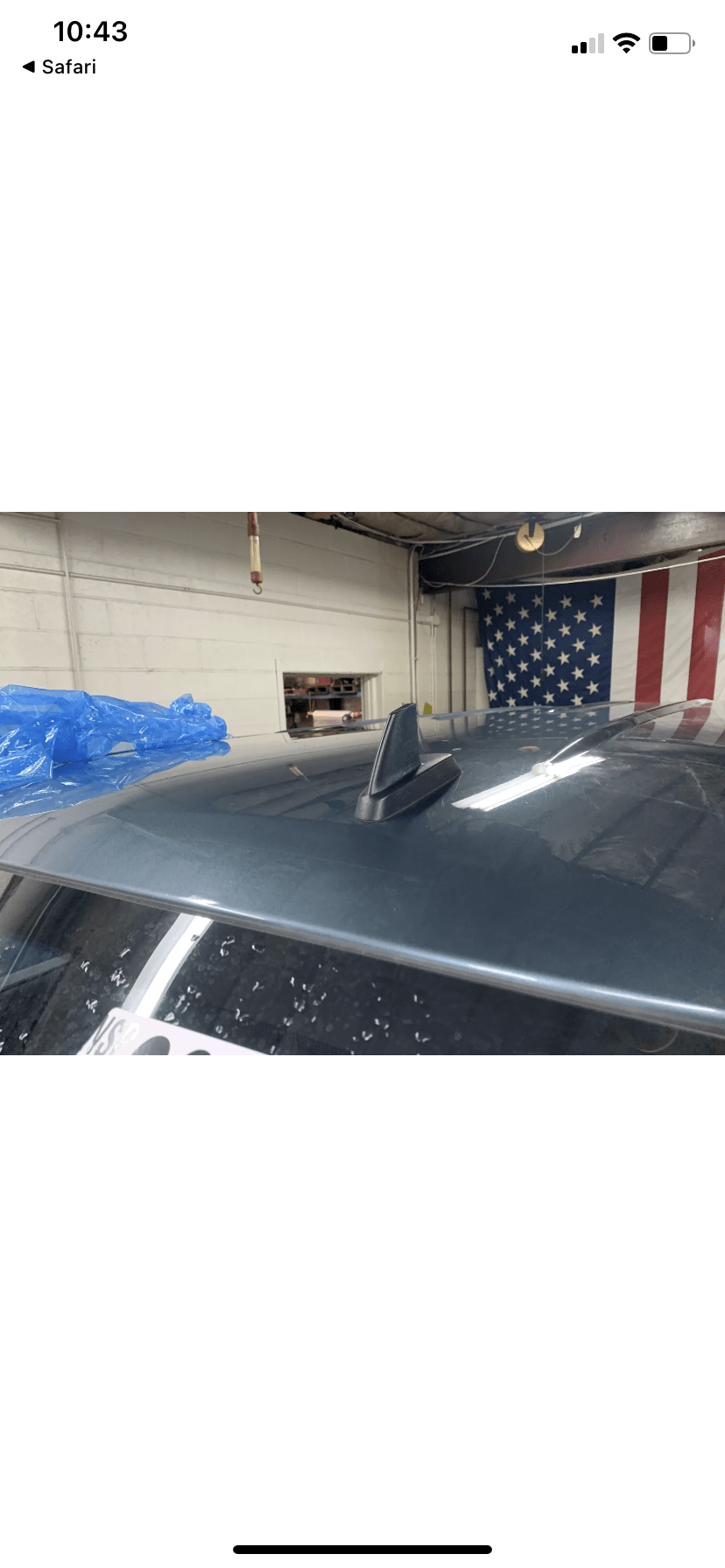

I have an after market head unit going in this build I noticed that the radio reception is very poor with the after market head unit but works perfectly fine with the stock head unit .
I’ve heard I can purchase a powered antenna adapter to boost the signal .
Since I need the adapter in a 2010 tahoe when replacing the head unit is there sick a thing as a powered one so it boosts the signal and if so where do I look ? I tried google but nothing came up about powered ones maybe I looked in the wrong spot

Did you search for:
car fm signal booster
They rarely work.
Does the reception improve if you switch off the amplifiers? Some can interfere with reception.

How does the reception compare to other aftermarket head units?
Are you using an antenna that you know to be good?
The antenna I’m using is good . I’m wondering if the factory antenna needs to see power ?
In the image below this is the antenna I have on my Tahoe . Not sure if it’s a powered antenna or not I think crutchfield said I needed to use the power antenna wire from the headunit and hook it up to the antenna wire on the factory harness . But it says nothing about this in the instructions. So not sure if I have to hook a wire up or not
Link to the Crutchfield page for this antenna?
Do you have a standard car antenna that you could use?
Does the head unit have the antenna input on a wire or does it plug directly into the head unit chassis?

The antenna pictured in my last post is a factory antenna here is a link to the exact part from the dealer but it doesn’t tell you much
https://www.gmpartsonline.net/oem-p...9dGFob2UmeT0yMDEwJnQ9bHQmZT01LTNsLXY4LWZsZXg=
If I bench test the headunit and use a piece of wire as the antenna the radio reception is good only in the vehicle is where the reception is very poor
