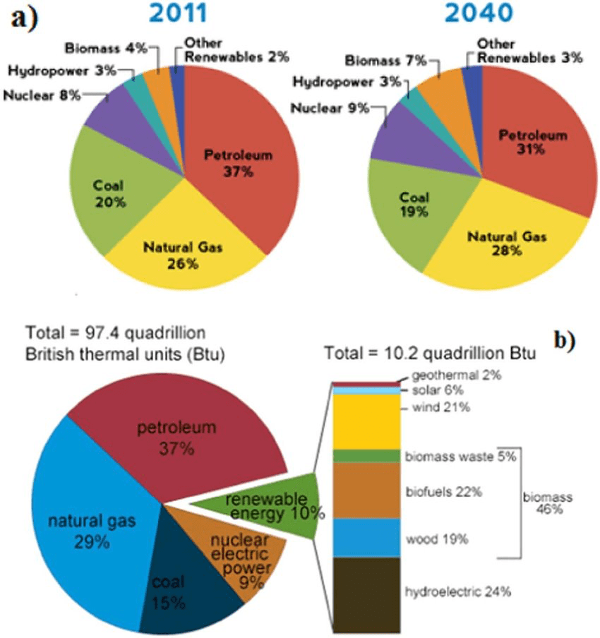

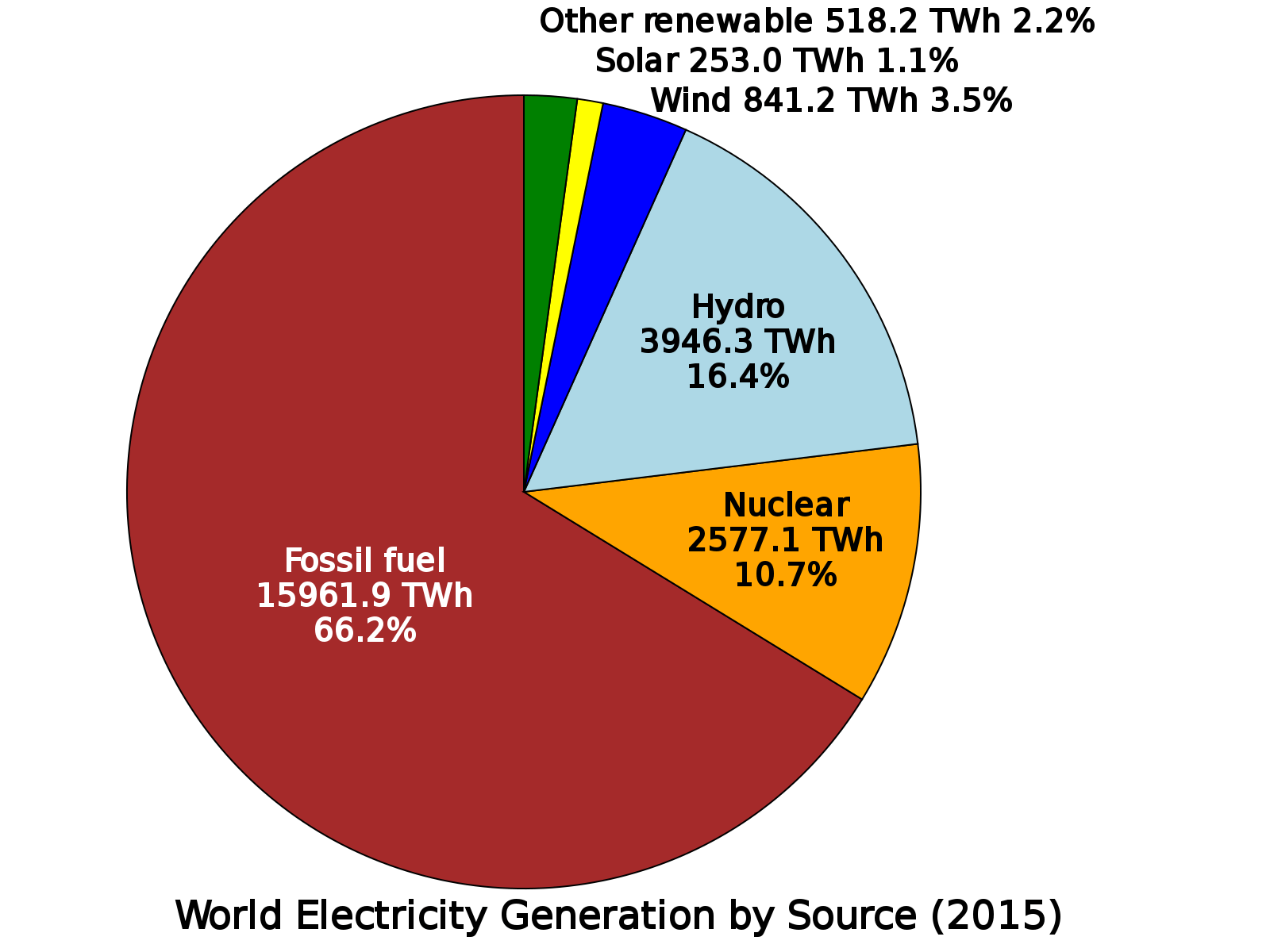

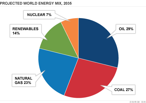

In the East-coast, much of our electricity comes from coal or natural gas burning power plants. Guess where electricity for charging an electric car comes from? Not exactly reducing greenhouse gases. People need to not kid themselves to believing that it’s so much better for the environment. Until the majority of electricity comes from hydro/wind/geothermal/nuclear will we be rid of making greenhouse gases. Until then, driving an electric car allows to consolidation of the greenhouse gas to a central plant where perhaps better controls on emissions of NOx etc may reduce acid rain and ozone harming compounds from NOx. But there really isn’t much reduction in making CO2.
2015:
Projected 2035, not much better:
Other research shows similar trends:
