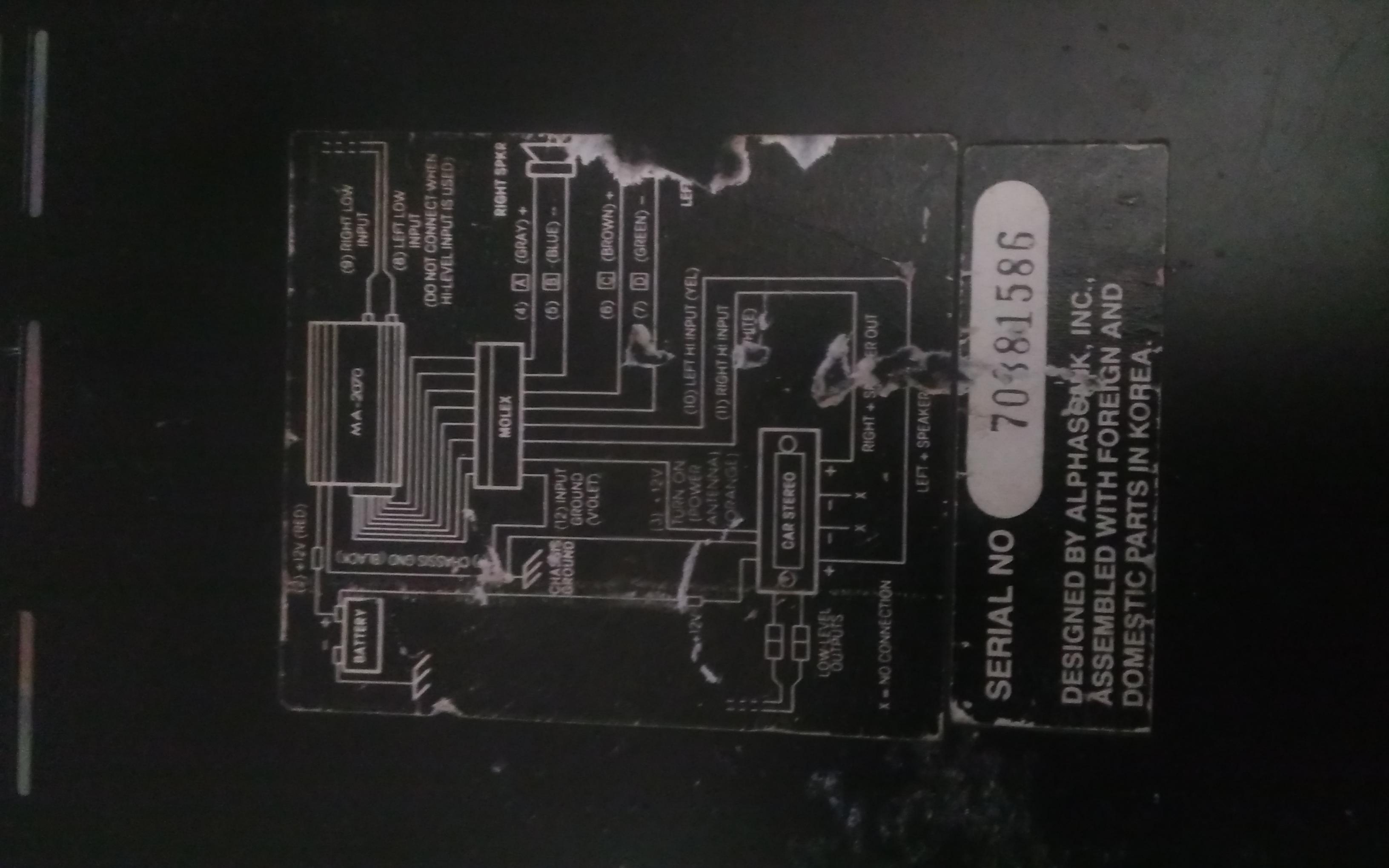

If anyone is still paying attention, I found an old ma-2070 while sorting out my garage. It still has the wiring diagram sticker on the back. It was working when I pulled it out of my old truck back in 2002. It was pushing two MTX 10's.
