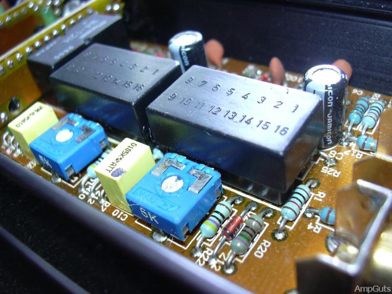

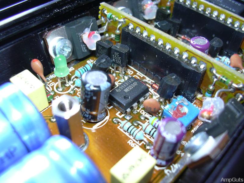

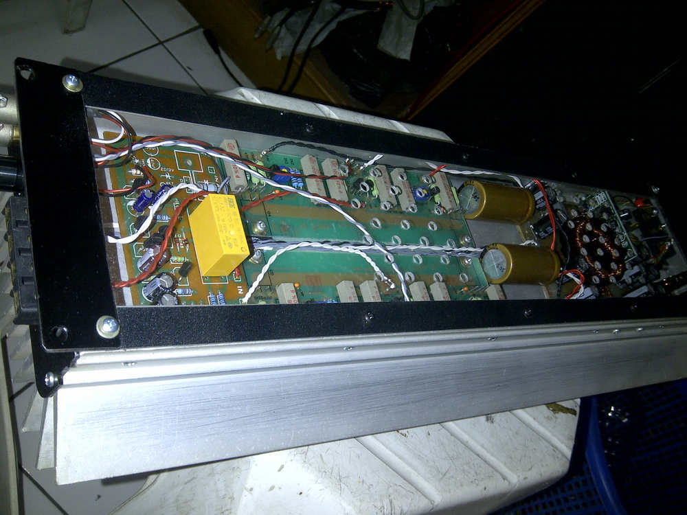

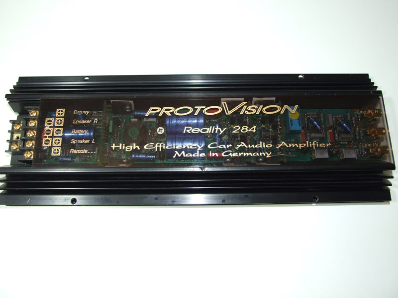

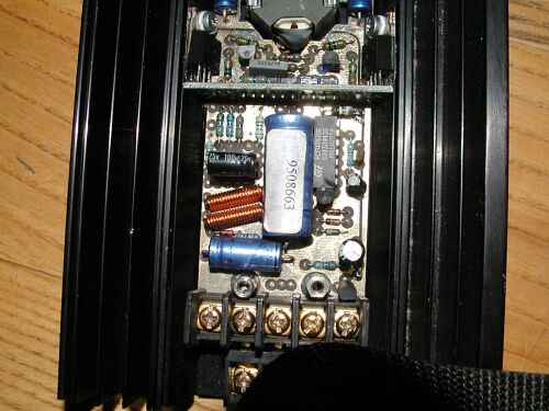

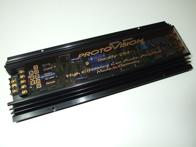

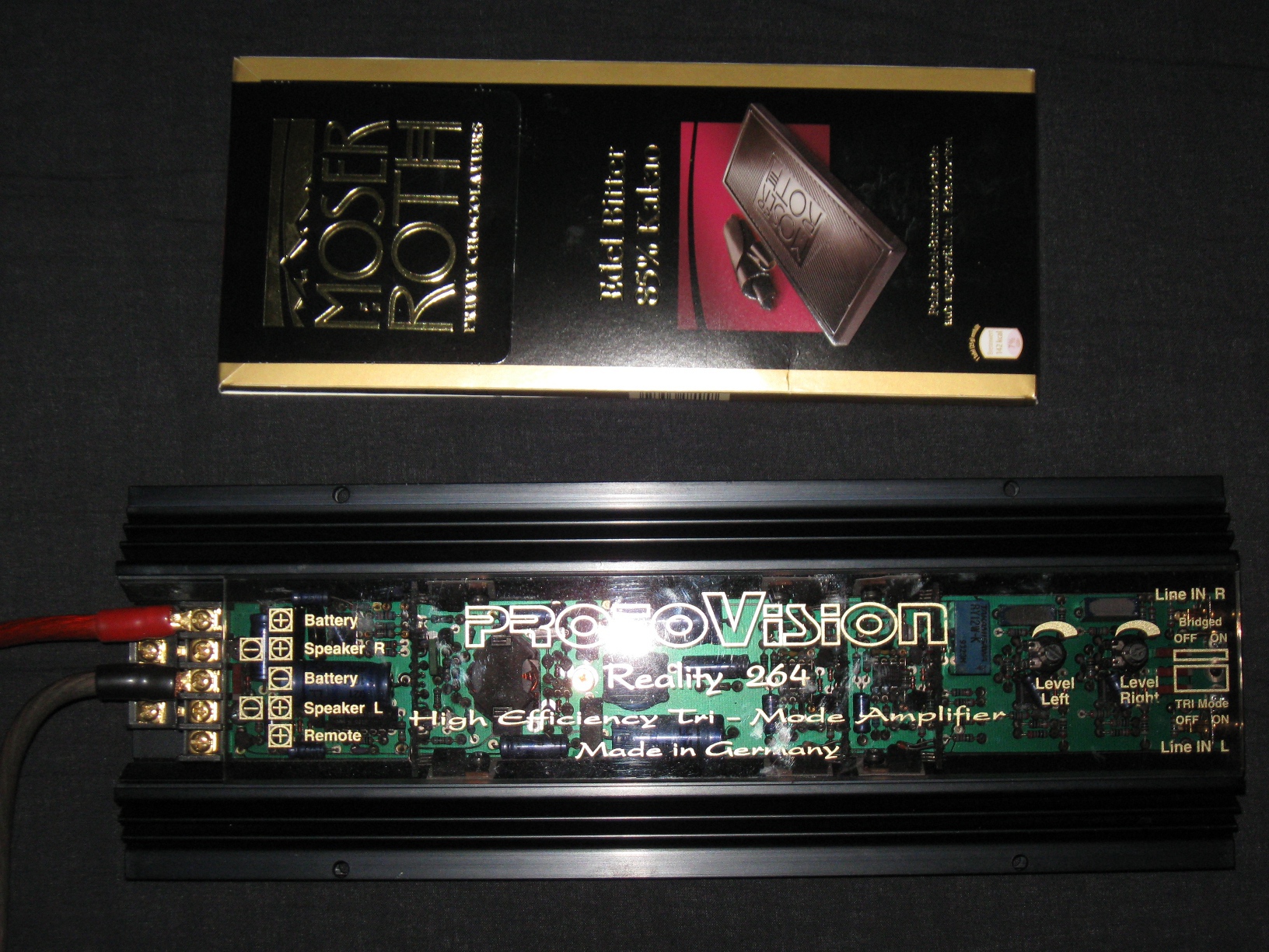

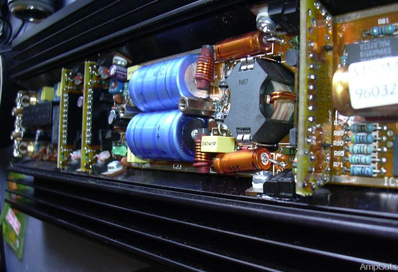

in the pdf attachement you will find a audio power amplifier topology, that I have only find in this German amplifier models for car audio:
1) AMA Stereo 50
2) Protovision 264/Protovision 284
3) Smart Devices Stereo MkII
4) Alphasonik David 265
All this amps sounds very fine if the temperature is approximately 50 degrees but it seems to be very sensitive against variuos unwanted parasitic effects, because a lot of damage devices there are, as to read in various German audio/hifi forums.
Is this topology a slightly modified version based on a certainly topology from Threshold/Nelson Pass?
What I miss is the requirement for bias adjust and bias stability or bias servo unit like
http://www.freepatentsonline.com/5055797.pdf

That's interesting. I developed a minimum peak hold detection circuit
for biasing output stages right about the same time. It comes from the
observation that in a push-pull follower the bias figure will be the minimum
voltage value from emitter to emitter. I recall that a prototype went to
CES, but by then I was on my way out the door. 😛
There are a couple of other very cute circuits for this sort of thing, but
modesty and greed prevent me from disclosure at this time.

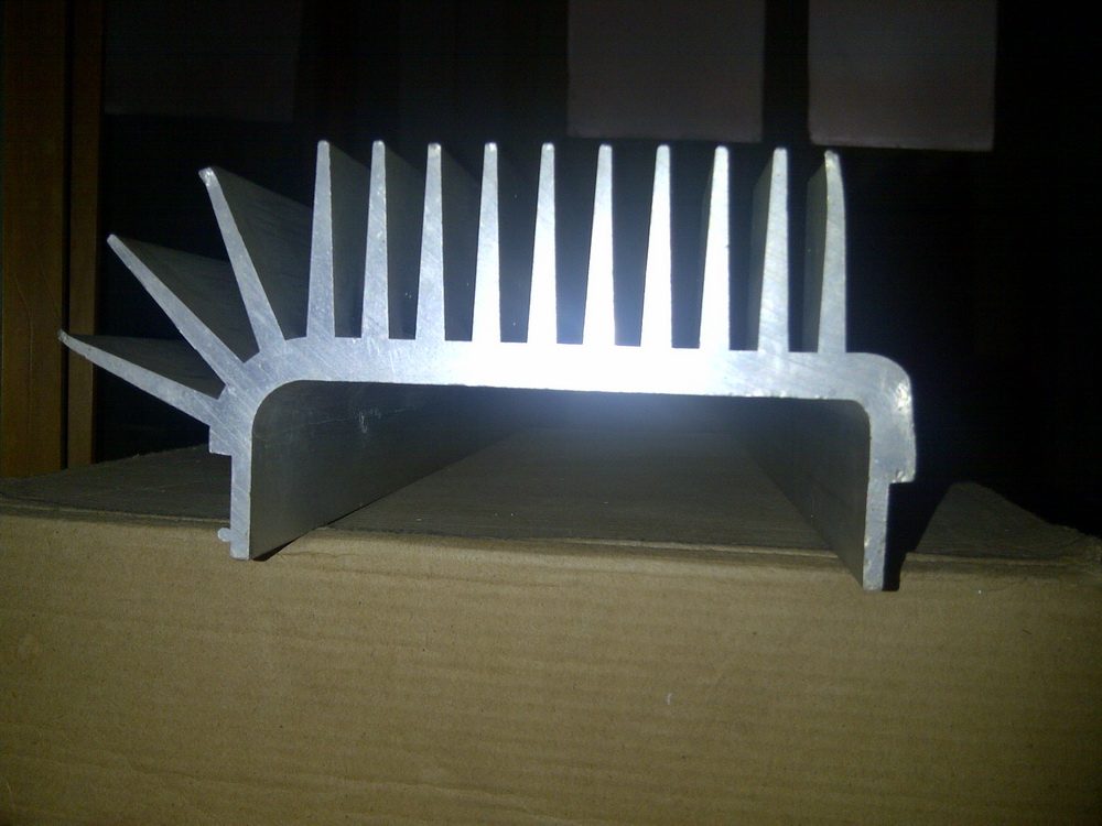

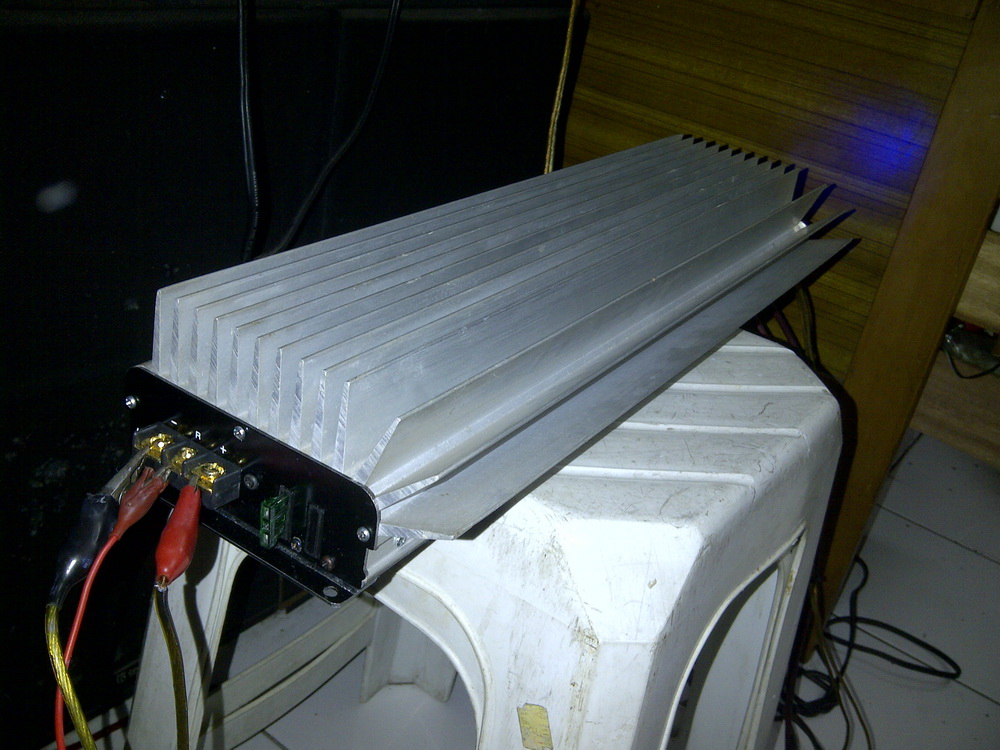

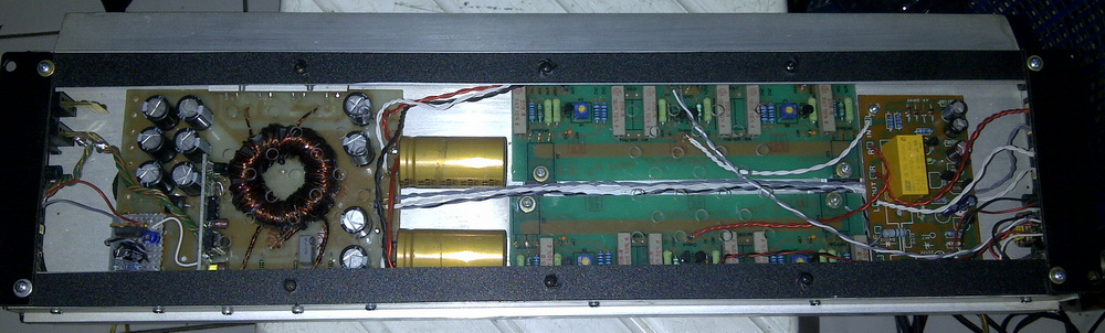

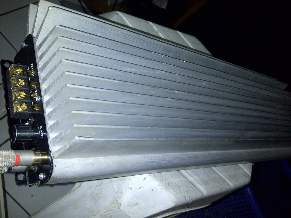

F5 in Car
F5 for car amplifier. Thanks Mr.Pass for making this possible 🙂
First step is to look for a suitable heatsink. Ordinary car amplifier heatsink won't hold the heat. An industial heatsink is more suitable

Could you post a build up of this amp. How do you like the sound in car? Did you design and build the SMPS yourself? I know that I would love a car version of the F5 as well as a few others. i have a pair of compression horn drivers that would work great with an amp like this in my car.
