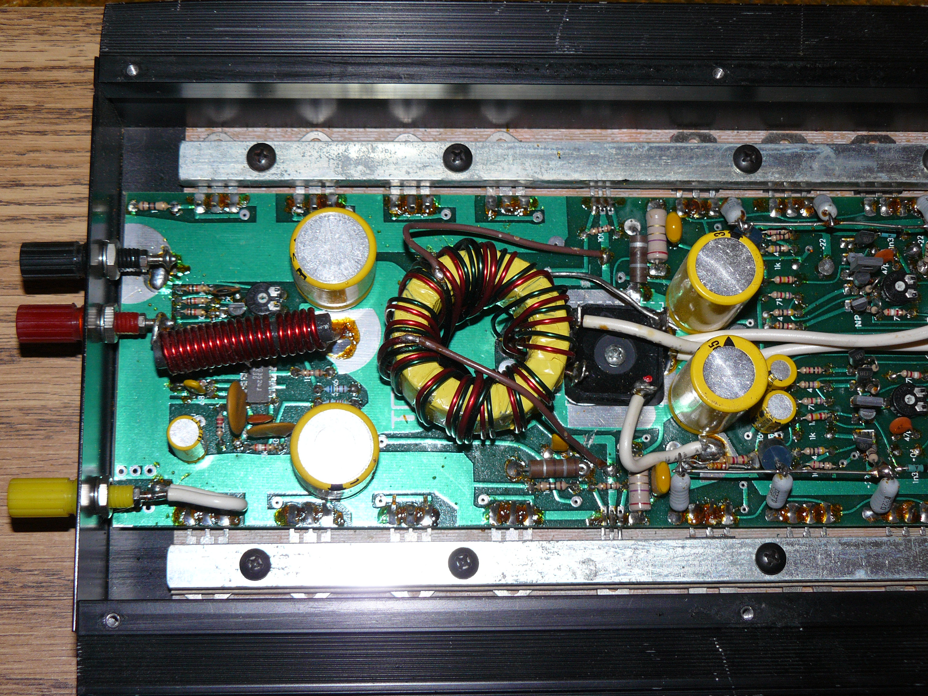

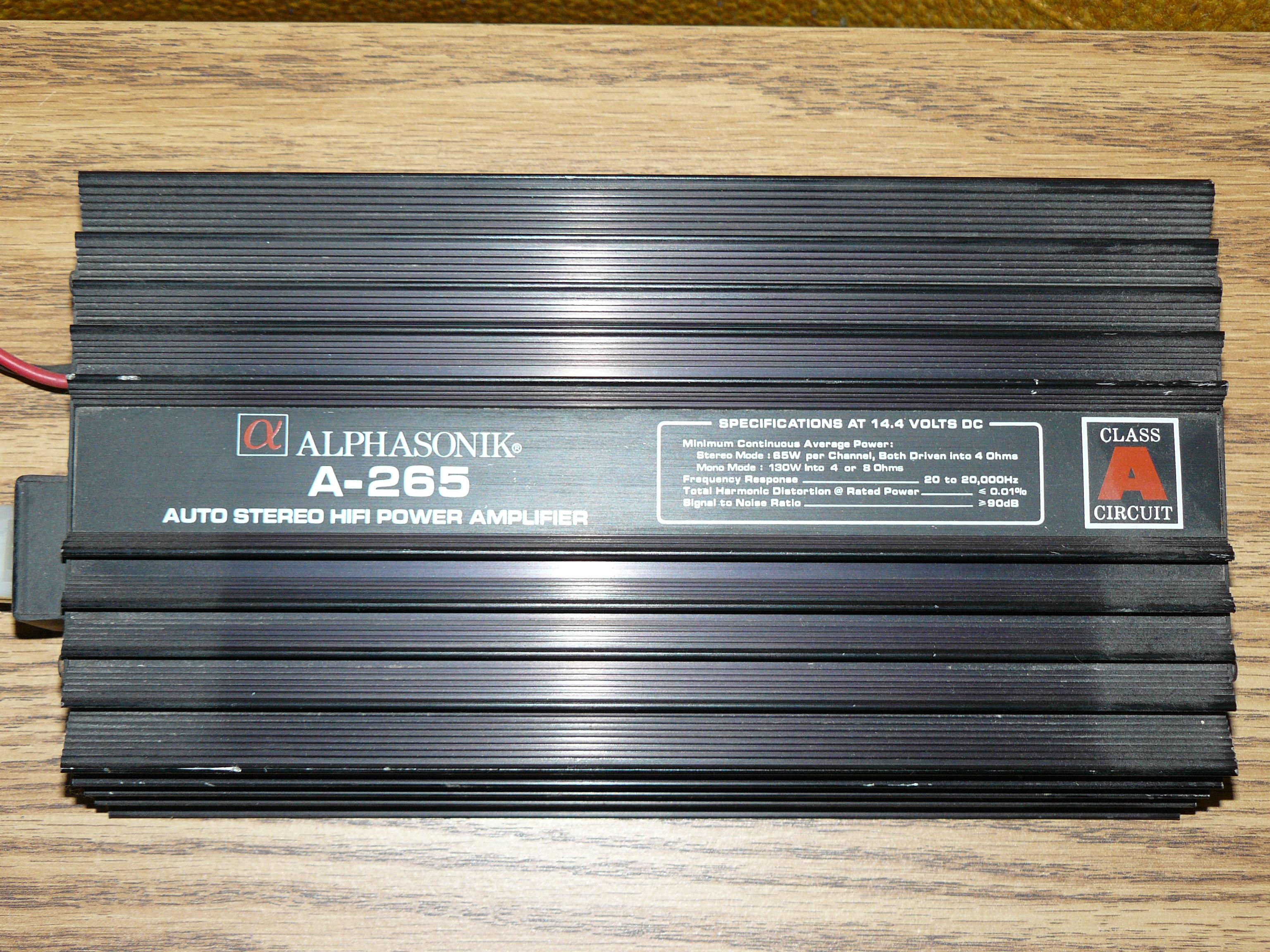

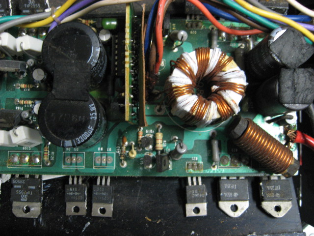

Inside the A-2125's typical sibling (A-265) was not pretty:
The siblings for 1984 were the 'Class A' A-265 (their flagship amp until the A-2125), the A-255, A-240B, and A-225. All of these amps were made in Korea, as well as the upcoming MA and PMA series as I recall.
Here's a label the from the A-265, circa 1983:

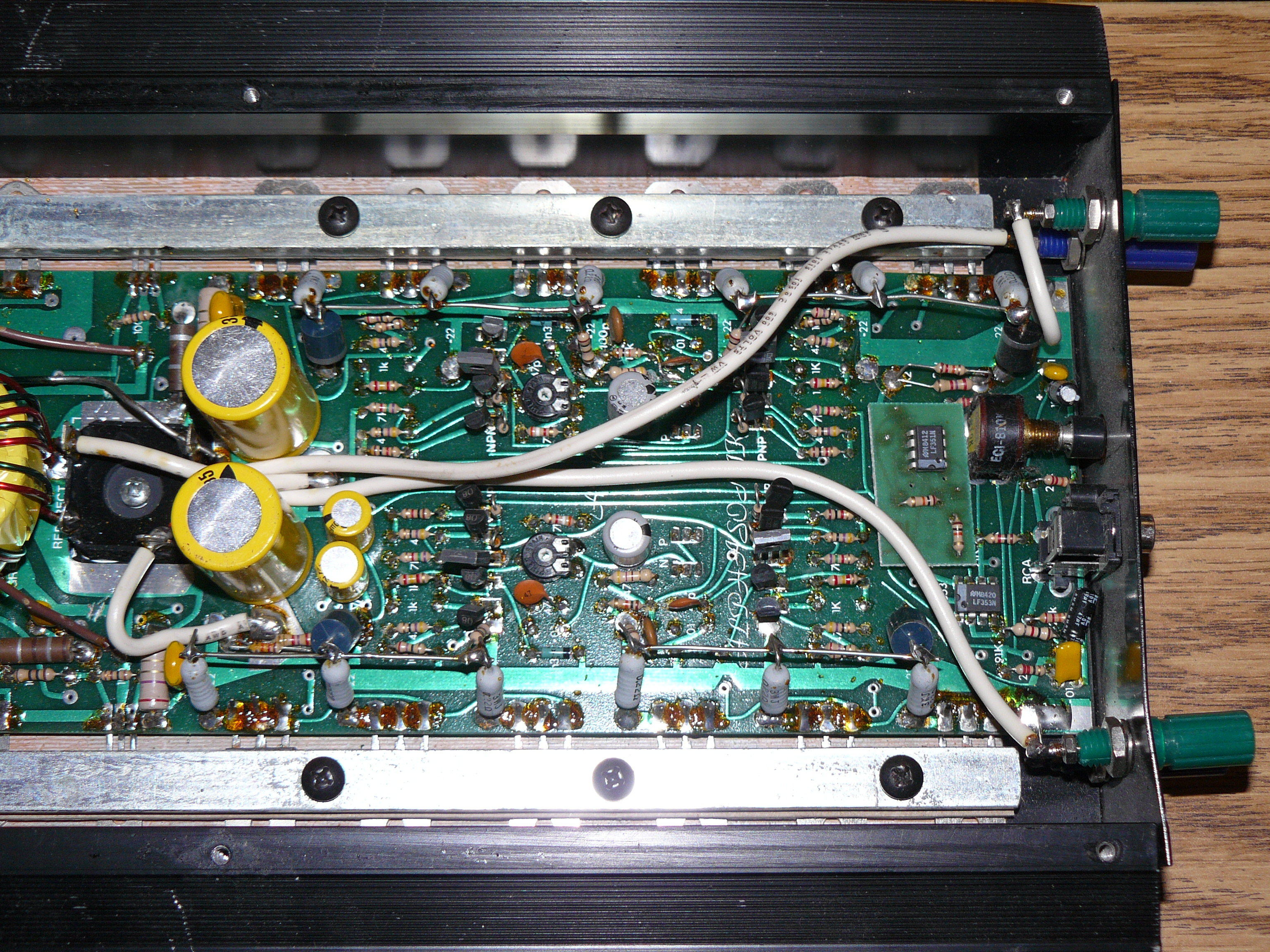

Looking again inside the A-265, indeed it doesn't use a timer-based supply, either. The control circuit is entirely discrete, no IC's whatsoever in the supply.

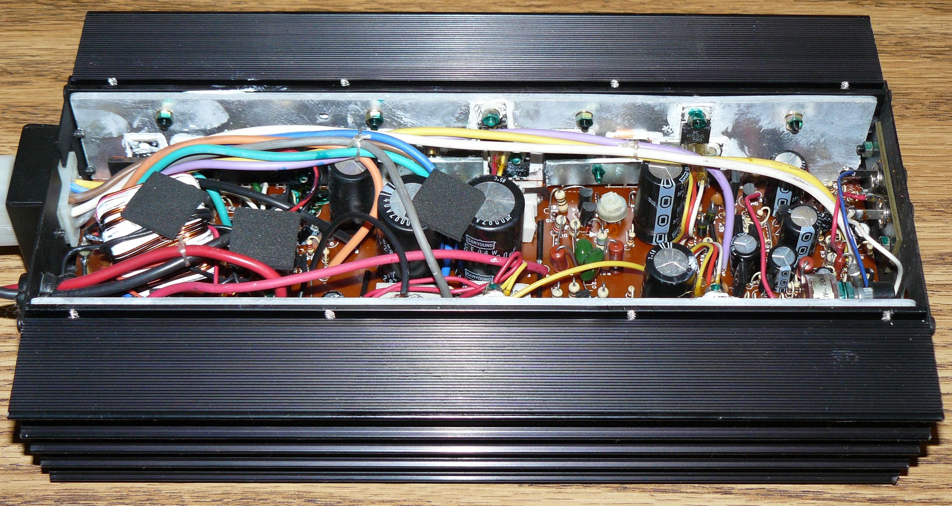

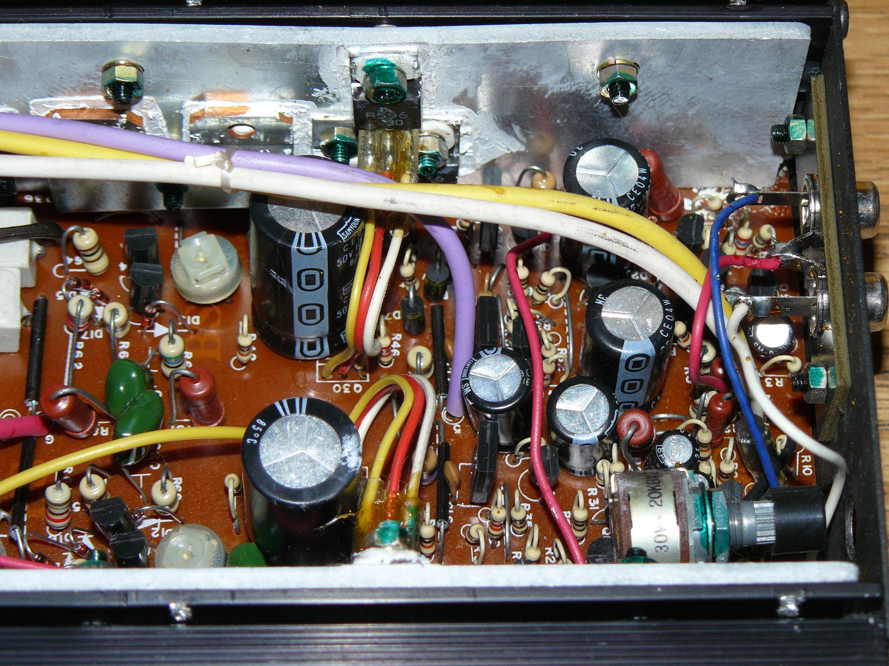

The 'Class A' MA-2035 and MA-2055 (same label as 2035), from 1986:
And the 2055/2035's timer-based supply control:
