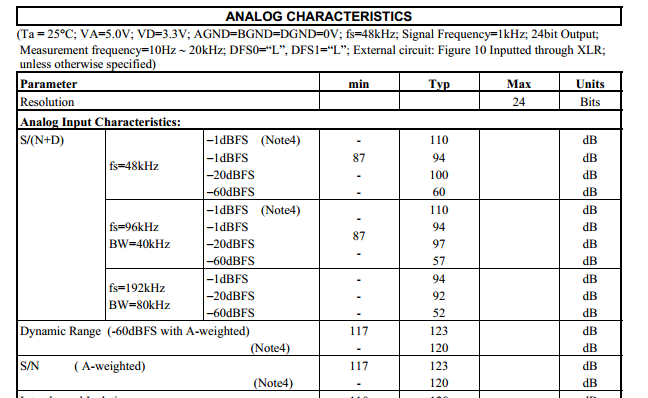

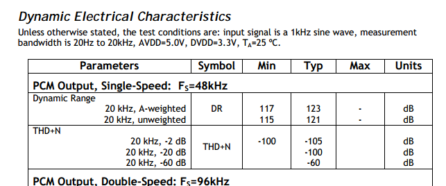

It really does a lot more. However seeing the price for a premium box for audiophiles established I may want to get one going. Audiophiles pay more and never look at specs, so flowery claims really make a difference.
The ARDA chip makes some broad claims but their specs are not a lot better that the AKM (or the TI).
Notice that just about ever spec is 'A' weighted.
It's not bad but seems average for today.
