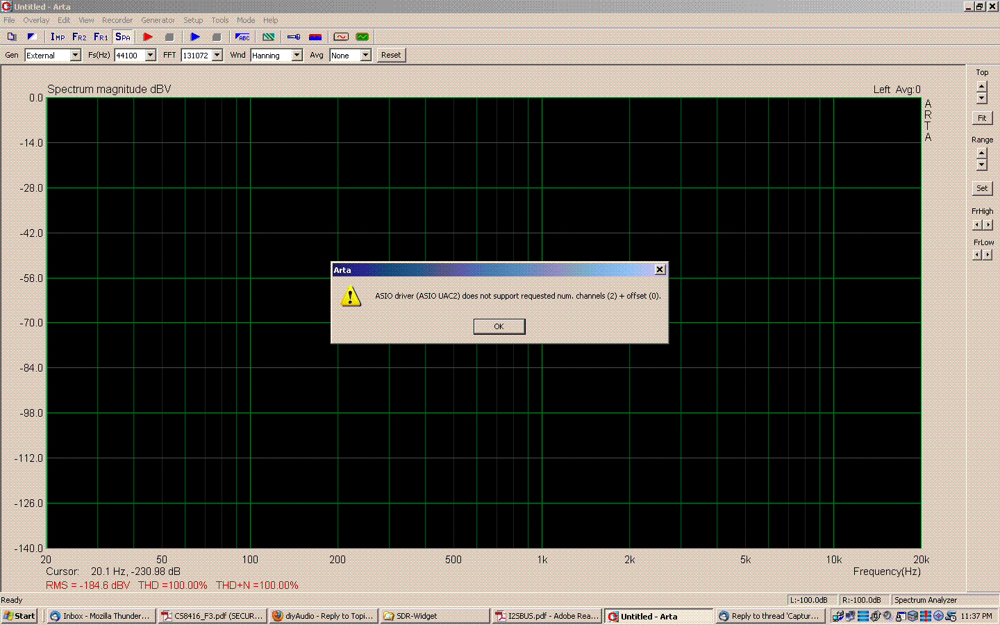

I assumed the ASIO driver was capable in both directions and readily useable with existing software at lest with the SDR-Widget. Am I wrong about this assumption?
If the the driver needs further development for capture is there someone willing to do this for us or are we on our own?

We need a full ASIO driver in mono at least or 2 channels to make this work on a Win OS
I think the ASIO for the Audio-Widget is minimal. Is this correct?
I would say no the host can't follow the sample rate because this was not expected by the app author. It's unusual functioning for a sound card.
I would be happy with an ASIO driver that gets a stream going to the application software. If it doesn't cause a crash then less functionality doesn't matter.
