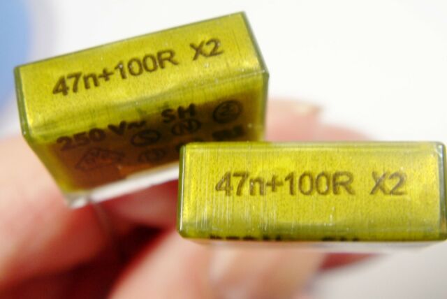

As Mark mentioned earlier, Quencharc is specifically designed for arc suppression. Rifa and Kemet are some other brands that manufacture RC snubbers.
In diy, not all of us can afford the cost. If a simple capacitor is used instead, one must take into account when it fails. Appropriate safeguards should be considered.

Those Rifa caps pictured there are crap.
Very true. Rifa paper capacitors have a strong propensity to explode.
Just those clear cased, long-obsolete RIFA film types were indeed crap. Other grades of similar RIFA caps would crack open too, regardless of voltage and even in high precision, high reliability applications like telephone system filter boards and their power supplies, etc. The plastic type/grade itself was obviously a major part of the problem.
Since those days, X and Y rated caps have been over-moulded or potted in polypropylene or similar opaque, high temperature plastics. Much the same inside though.

They are not 'long obsolete', they are in current production, and they are not crap except in equipment that has lain around unwed, when they dry out and crack and let the smoke out when finally powered up. I've certainly replaced my share of them too, but in equipment being resuscitated from a period in the garage.
Datasheet: https://content.kemet.com/datasheets/KEM_F3011_PME271M_X2_275.pdf
PME271 caps are metallized paper, saturated in insulating oil. The clue as to what type of oil, lies in the spec. "self extinguishing" to a simple flame and afterburn timing test. This probably means the oil was a silicone or quite likely, a chlorinated biphenyl type compound and water is not going to be an issue there without obvious signs . If the latter, it would have been changed when these compounds were banned in the US in the late 1970s but not necessarily elsewhere until as late as 2001.
