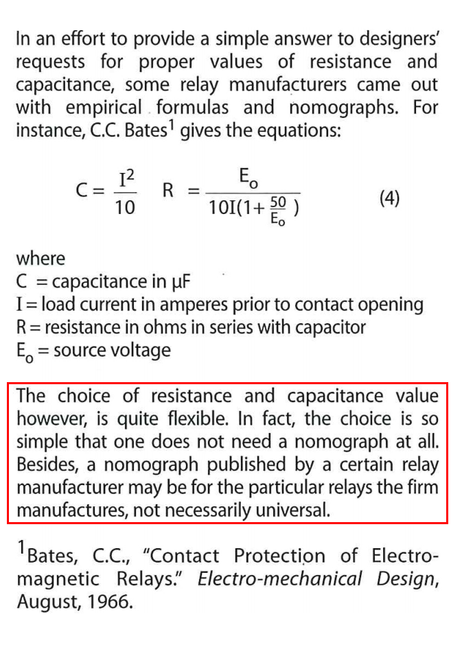

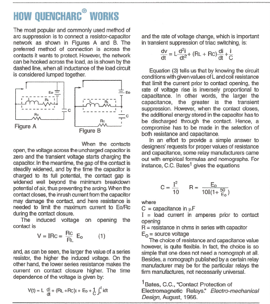

The capacitor across the switch prevents arcing on switch _off_ by keeping the voltage across the gap small until the gap is large enough to handle the mains voltage without arcing. It makes switch-on worse, which is why an RC snubber is preferred over just C.
Snubbers are always a compromise I think.
