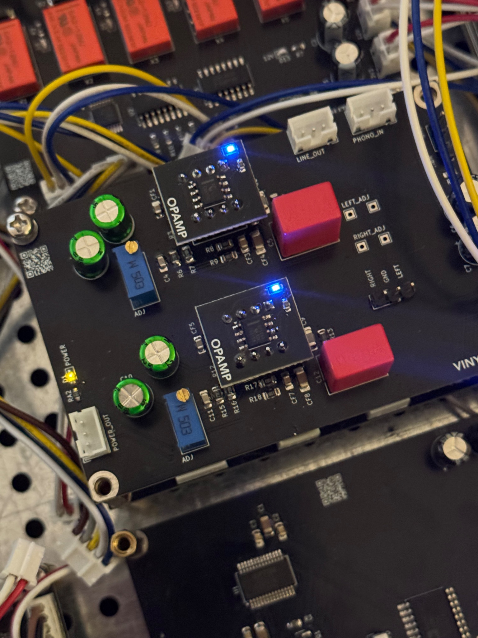

Here was the last vinyl RIAA/pre-amp I made for my amp. I tossed a wima on there just to spice up the visuals a bit, but the previous version just used c0g in its place and it sounded great. I never measured it, but it was based on the Elliot sound RIAA preamp, and it sounded way better than the commercial pre-amp it replaced.

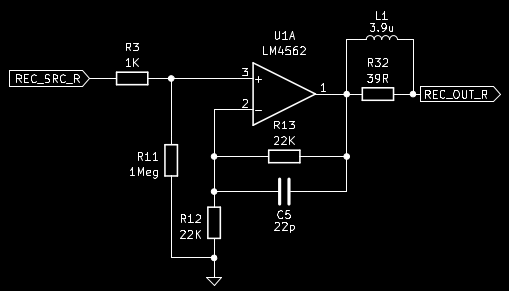

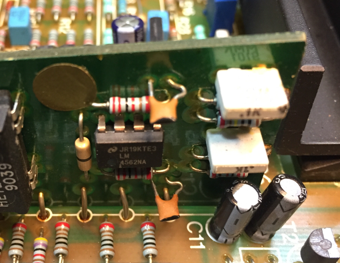

Below is the tape loop amplifier of my vintage amp, which I upgraded with hi-fi opamp. I also designed a clone board with the schematic attached; PCBs are in the mail. On the picture the 22p compensation caps seem ceramic, but who knows which class - Information is scarce on this oldie.
I have them in my crosshairs for further upgrade but then reason kicks in and deem that useless, as part of a high pass filter with a corner frequency over 320 KHz the cap is basically out of the audible signal path. Is this a correct reasoning?
With the tape loop amp clone I could experiment with various cap types to see if there is audible difference, and as a baseline standard I'll put garden variety type I ceramics.
In this case I don't think the capacitance/voltage coefficient is an issue as the DC bias is negligible (consumer level signal), otherwise they wouldn't have designed it that way, right?
They are NP0, also known as C0G, so they are class 1. The black stripe indicates NP0. Ceramic capacitors of 220 pF or less are almost always class 1 anyway.
Thanks a lot Marcel, that's good to know. Replacing them would really have been a mistake.The black stripe indicates NP0. Ceramic capacitors of 220 pF or less are almost always class 1 anyway
