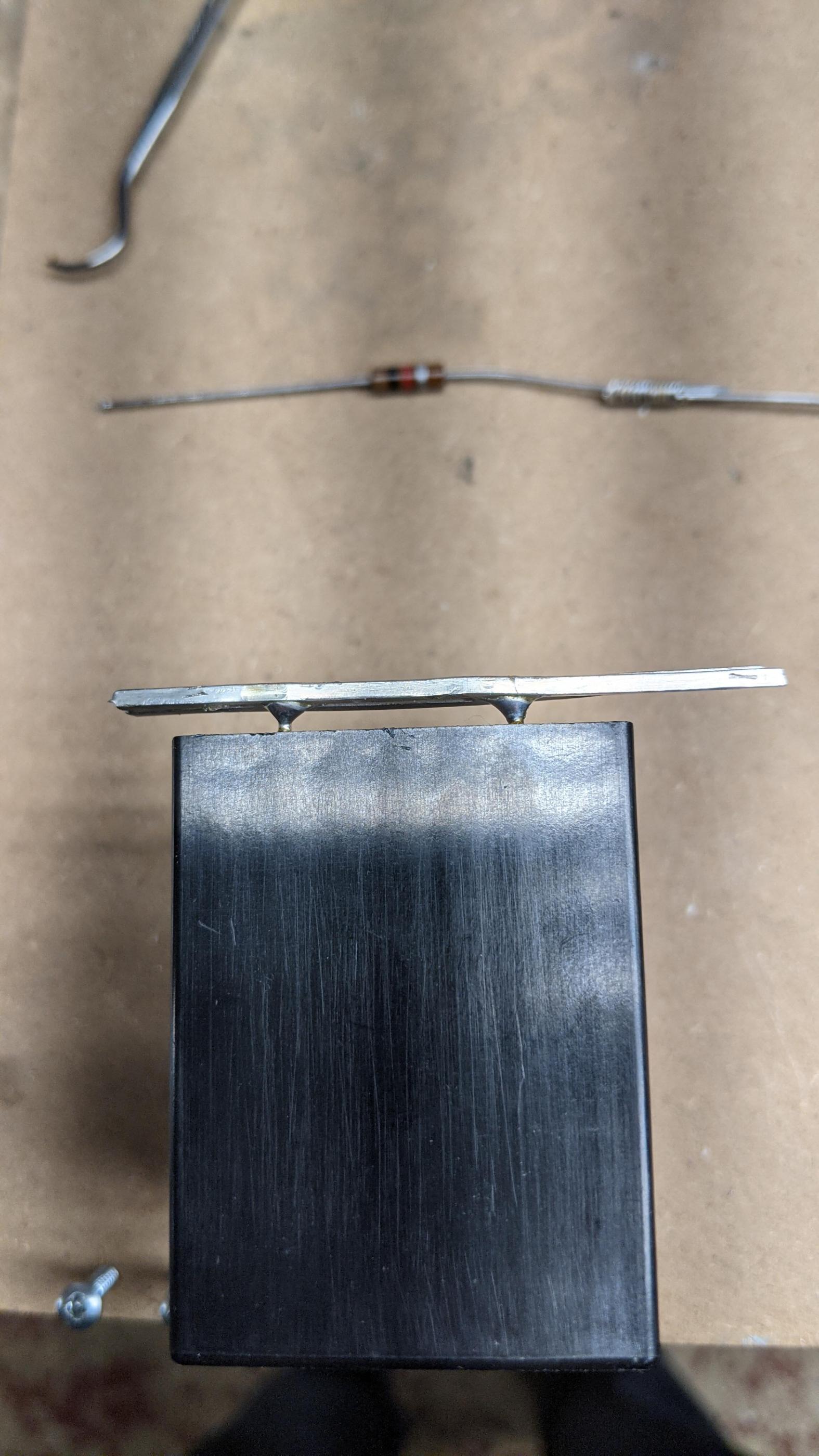

I think I'm going to try something like this. In the final build I can hook the B- side of the caps together with longer pieces of bus wire. It also gives me a nice place for bleeder resistors and the choke hookups.
Thanks for all the help. I'll work on learning a PCB design program as that seems valuable.
